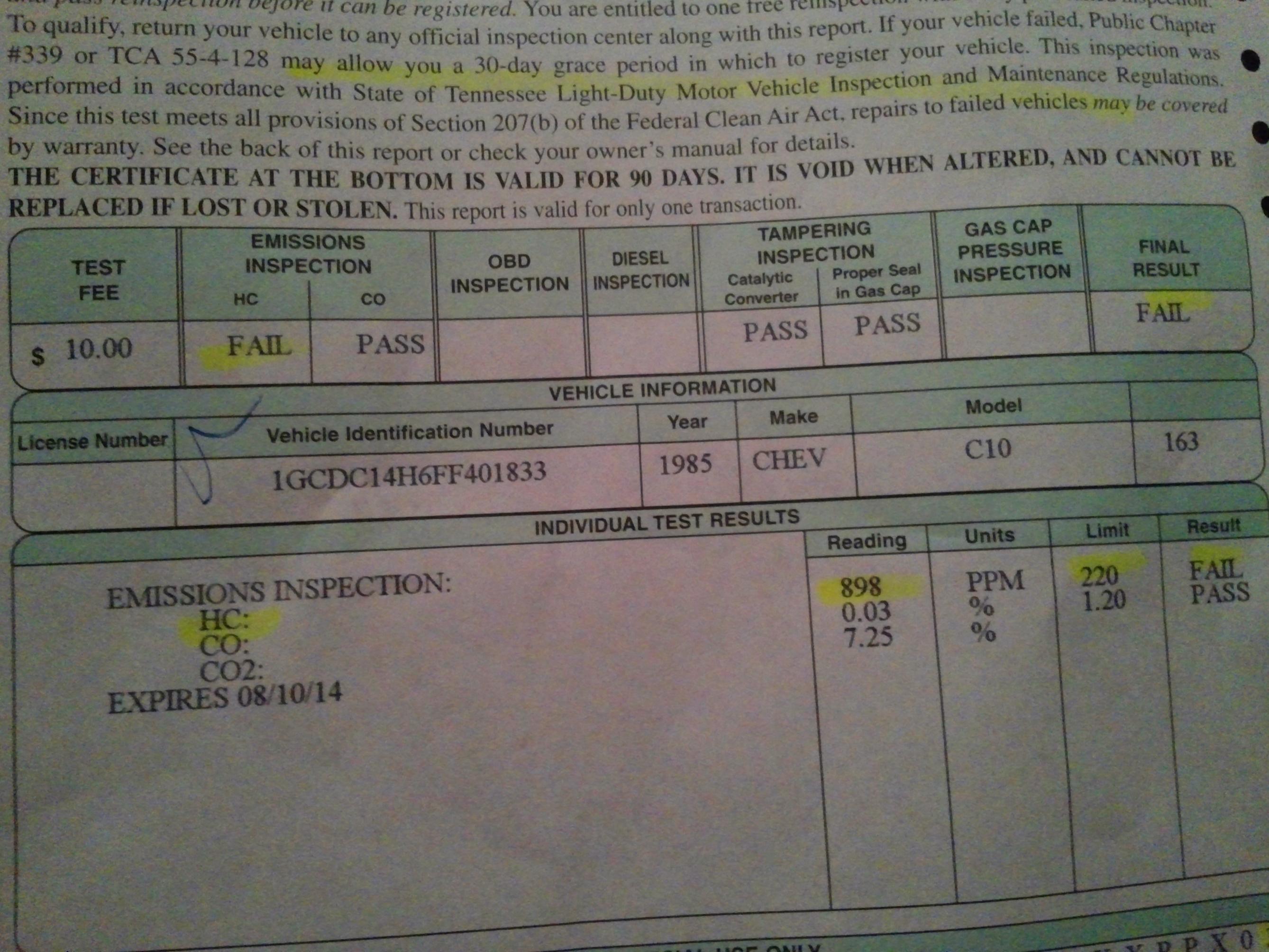

I own an 85 c10 pick up that has just failed emission
Hc side of test. Reading was 898 ppm pass limit is 220 ppm
Before testing. This is what was done.
Complete tune up
Oil change
New cat
New smog pump
Replaced all vacuum lines
Was disappointed to see it fail at such a high number on the hc side
What in the sam hill should i do or look at next?
Any input would be great.

Is this a 2-speed test?? Idle and cruise. If so at what speed did it fail?
HCs are the result of a misfire.
Misfire: bad plug, bad wire, bad dist cap, stuck open EGR valve, crossed plug wires (check 5&7 first), bad compression or an extremely lean air fuel mixture. Over advanced ignition timing can also cause high HCs.
First thing I would do it try to determine which cylinder or cylinders are misfiring.
Using insulated pliers (available at most auto parts stores) pull each wire off the plug and listen for a drop in RPM. Find the cylinder that does not change the RPM when the wire is removed.
You could also have a bad vacuum leak - possibly the power brake booster diaphragm or booster shaft seal.
Heat range of a spark plug refers to the actual temperature of the white porcelain that surrounds the center electrode of the spark plug - it does not affect the actual spark itself.

Its a 2 speed i guess they checked at idle and at 2500 rpm
Didnt say when failed. Just that if failed

post the results for all 5 gases.
if it was a misfire condition, the 02% would also be high. if its running rich do to blowby or fuel trim issues the hc will be high and the CO high also
