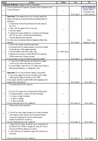

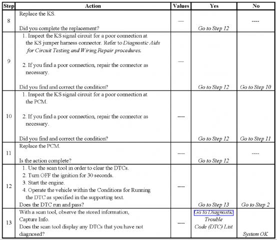

You need to run down the trouble trees associated with the codes. Below I will post the them best I can if you can not read them the you need to get a service manual.
CIRCUIT DESCRIPTION
The knock sensors (KS) produce an AC signal under all engine operating conditions. The powertrain control module (PCM) calculates the average voltage range of each KS signal. If the KS system is operating normally, the PCM should monitor the KS voltage varying above and below calculated average voltage. If the PCM detects a KS 1 signal or a KS 2 signal voltage within the calculated average range, a DTC will be set. DTC P0327 refers to the front KS. DTC P0332 refers to the rear KS.

DIAGNOSTIC AIDS
IMPORTANT: If the KS is dropped, the sensor must be replaced.
Inspect the KS for proper installation. A knock sensor that is loose or over torqued may cause the DTC to set.
If DTCs P0327 and P0332 are set at the same time, inspect for poor connections at the KS harness jumper, located at the left rear side of the intake manifold.
For an intermittent, refer to Intermittent Conditions. See: Powertrain Management\Computers and Control Systems\Testing and Inspection\Initial Inspection and Diagnostic Overview\Diagnostic Strategies\Intermittent Conditions
TEST DESCRIPTION
DTC P0327 Or P0332 - Steps 1-7
Attached Thumbnails Knock sensor help please-173607567.jpg   Knock sensor help please-191637901.jpg

The numbers below refer to the step numbers on the diagnostic table.
2. This verifies the malfunction is present.
3. This test will isolate the KS from the rest of the circuit.
4. Tapping on the engine block will simulate an engine knock.
