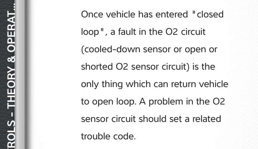

You need to focus on what the o2 sensor is doing at idle if you’re set on figuring this out.
I think you’re misinterpreting the data - the ideal voltage is 0.45 volts - lower than that indicates lean and higher than that indicates rich. It’s not that the engine kicks back into open loop and then the o2 sensor starts reading rich - it’s that the engine is running rich at idle and cooling down the sensor which then results in the return to open loop.
The reason you don’t see it for about 10 seconds is because that’s how long it takes your scanner to communicate, process and read out the data from the ECM. You need to use a meter to probe the sensor circuit and see what the actual voltage is at the moment it returns to idle speed.
