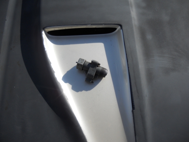

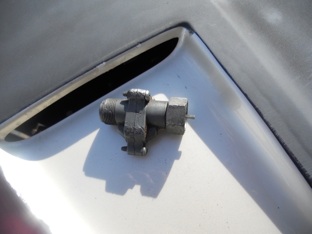

checked all the vac. lines everything seems to be hook up right and getting good vacuum could maybe the carb not being tuned right have somthing to do with it? and i had somthing attached to my trans and have no idea on what the hell it is or fine any info on it but the speedo cable was hooked to it

I would have to agree with the others. The rearend has nothing to do with the trany shifting. The part you have in the pic is a ratio adapter. That will change your speedometer reading. Can you shift the trany manualy to make sure its shifting into 3rd gear?
