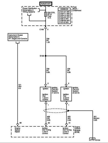

Both 30A Ignition fuses were confirmed good in the original post. But according to the schematic there is also a Fuse EF10 15A which is just for the ignition coil itself. Have to confirm that then on to Step 5.

Turns out that 15A fuse was blown(shown in schematic below) Now the reason a fuse blows is generally due to a short circuit or a improper ground on the circuit, both cause a high amperage draw. I was investigating the ground points to see if anything needed to be cleaned up or repaired, don't want to have this same fuse or another system fuse blow out on me randomly again. When I removed the battery negative clamp, it completely broke off the main ground cable. So that was the likely source of the bad ground, that crack in the cable clamp. Bolted on a replacement clamp for now until I have time to properly splice in some cable. Car fires up but haven't test drove it yet. However I feel pretty confident this repair is solved. Very frustrating that even though I followed standard troubleshooting procedures pretty closely, a cheap code reader led me down a path to nowhere that did not need to be followed. If I had been able to read live data correctly the first time and see that the ECM was reading RPM, the very next step would've been checking this fuse and solving the issue immediately.
