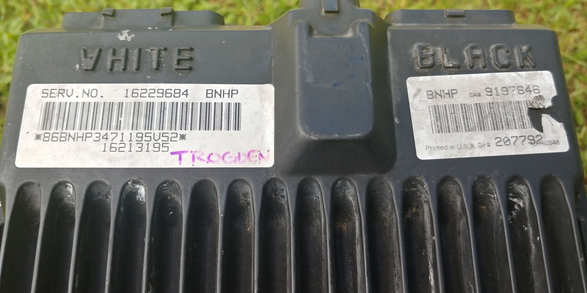

New ECM that came out of a 97 Tahoe with all exact same numbers except BNHM instead of BNHP. Same symptoms with new ECM.

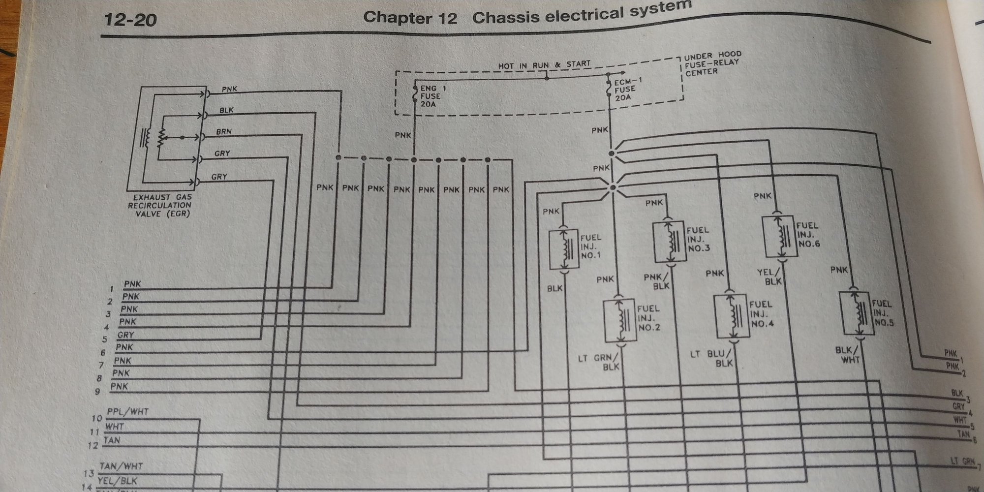

Checked the spider for shorts or corrosion

I'm not sure,I believe the pump will still prime,but power is cut to spider?how about looking in book for power out of ignition switch,crank is purple,I think pink is "run"
Old Oct 12, 2018 | 7:34 PM
geo1's Avatar
Joined: Aug 2018
Posts: 357
From: Adirondacks,ny
Or power wire to icm,live on "run"
Old Oct 12, 2018 | 7:38 PM
Jdurango's Avatar
Joined: Oct 2018
Have 12v to ICM and spider (I believe they're both on that pink wire which is same as crank sensor.. .hooked directly to same place).....but again, this also seems to be "shorted" to ground ....which doesn't seem possible without some electrical magic in the ECM (modulating/switching or whatever) ... I just don't know how this process works
