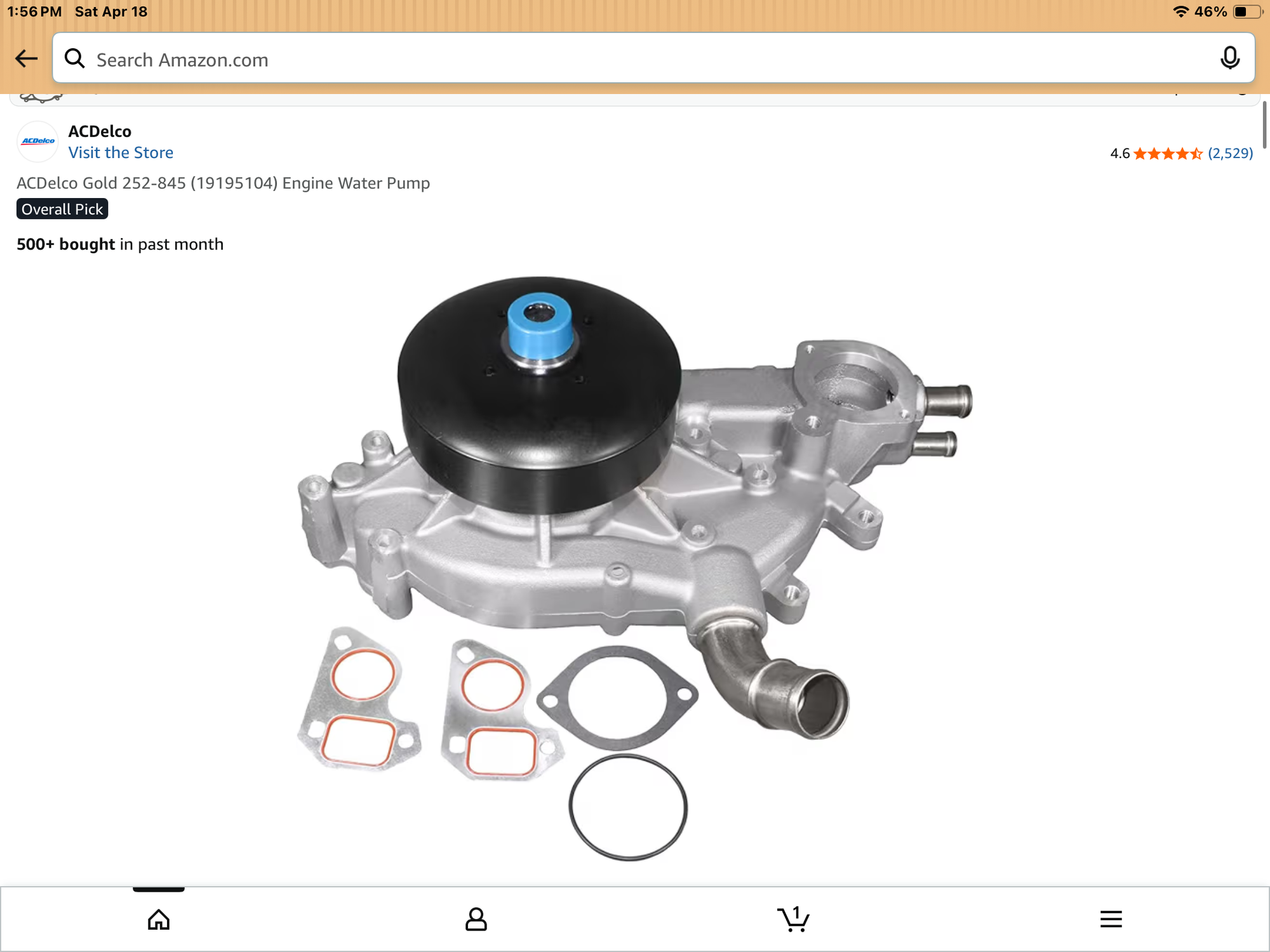

Old Apr 18, 2026 | 12:57 PM
loopedr1's Avatar
Joined: Sep 2018
Posts: 90
Likes: 13
Amazon is a great place to get your water pump..here it is…acdelco gold…$122

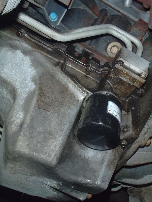

Will someone please confirm for me that the hex plug above the oil filter, in the picture, at bottom, is the engine block coolant drain plug?
The manual illustration does not match what I see.
There are two items 20 and 21 in the vicinity but only one plug.
Manual Page
Manual Page
Picture From Below
Thank you

This shows it farther forward in front of the engine mount for mine. If you remove it and coolant comes out, it must have been a coolant plug. Sure looks like it's going into a water jacket to me. Does it take a 17mm hex?
https://lemon-manuals.org.ua/Chevrol...g%20Procedure/
