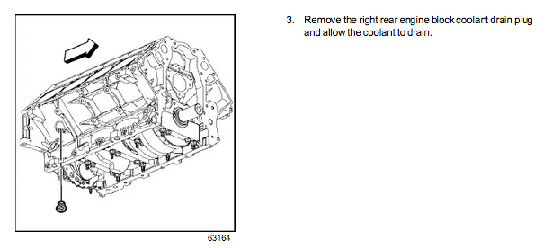

Default V8 not V6 engine block coolant plugs
I was so focused on the coolant plug I missed the manual page shows a V6.
Here are two more images.
Aside: Is there a thread sealant on these plugs?
Passenger Side
Passenger Side
Driver Side
Driver Side

After crawling under the van I do not see the passenger side drain plug.
It would be behind the starter (?). There is a hole that might allow access,
but I do not want to dump coolant onto the starter or remove the starter just to do a coolant change?
No. I see gallons and gallons of distilled water in my future.
