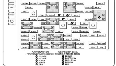

I do have a test light, but am I looking for the ign switch / ign coil Fuses, or the actual components on the vehicle? If fuses, I'm having a little trouble deciphering which ign fuse is which? Other than the ign fuses in this diagram, there are two more 40a ign fuses (ign A & B) above the starter relay.
