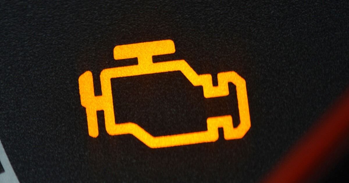

Remember: a decade ago with our 2005 Mrs. Cusser thought a warning light on the dashboard was a submarine, it was an engine with a fan blade. And when we couldn't open a rear door from the inside, thought a diagram on the rear jamb was a spaceman; it was a kid, like to disable doors from unlocking from inside, my daughter must've kicked it on..
