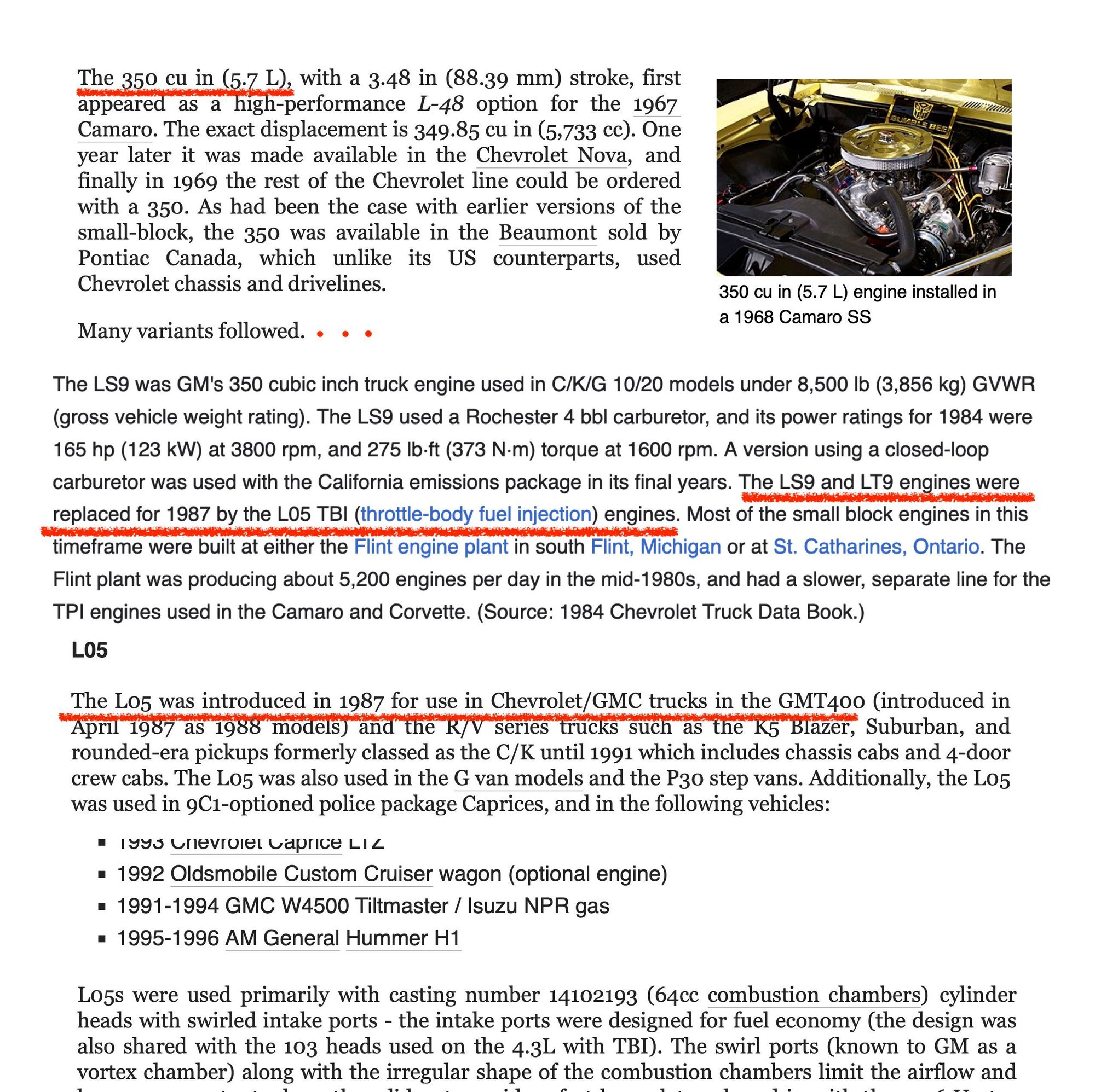

I'm looking at a 1995 Tahoe 4 door. Does anyone know if these have the TBI or Vortec 5.7? I've seen various answers online, probably because this is the first year of the 4-door and somewhere around the changeover from TBI to Vortec.

You're mixing up your terms there.
Vortec refers to a head design and TBI refers to fuel injection. Some Vortec engines had throttle body injection
According to wiki, Tahoe got port injection in '96. It should be easy to recognise with a LOT less hoses going to the throttle body.
https://en.wikipedia.org/wiki/Chevro...eneration)#L31

I'm really asking if the engine is referred to as the 5.7 Vortec V8 and not the 350 TBI. So I'm wondering if the 1995 Tahoe/Yukon had the Vortec or TBI.
With this change also came the change from OBD1 to OBD2, which generally I know GM adopted in 1996.

it's all in the link I gave you

No where in your link tells me that the 1995 Tahoe/Yukon uses the TBI and the 1996 and on use the Vortec. I had to spend twenty minutes looking for that info.

No come on, everyone here knows exactly what I was asking. Does the 1995 have the L31 or the L05?
I didn't know that L31 was the engine code until after I asked this question, so I didn't know why reading about that was relevant.
Just answer a person's question and then follow it with a source and ELI5 commentary. Very easy to do.
Anyway, I found what I needed in a roundabout way. Thanks for your help.

the code doesn't matter. It says right there black on white "1996–2000 Chevrolet Tahoe/GMC Yukon"
