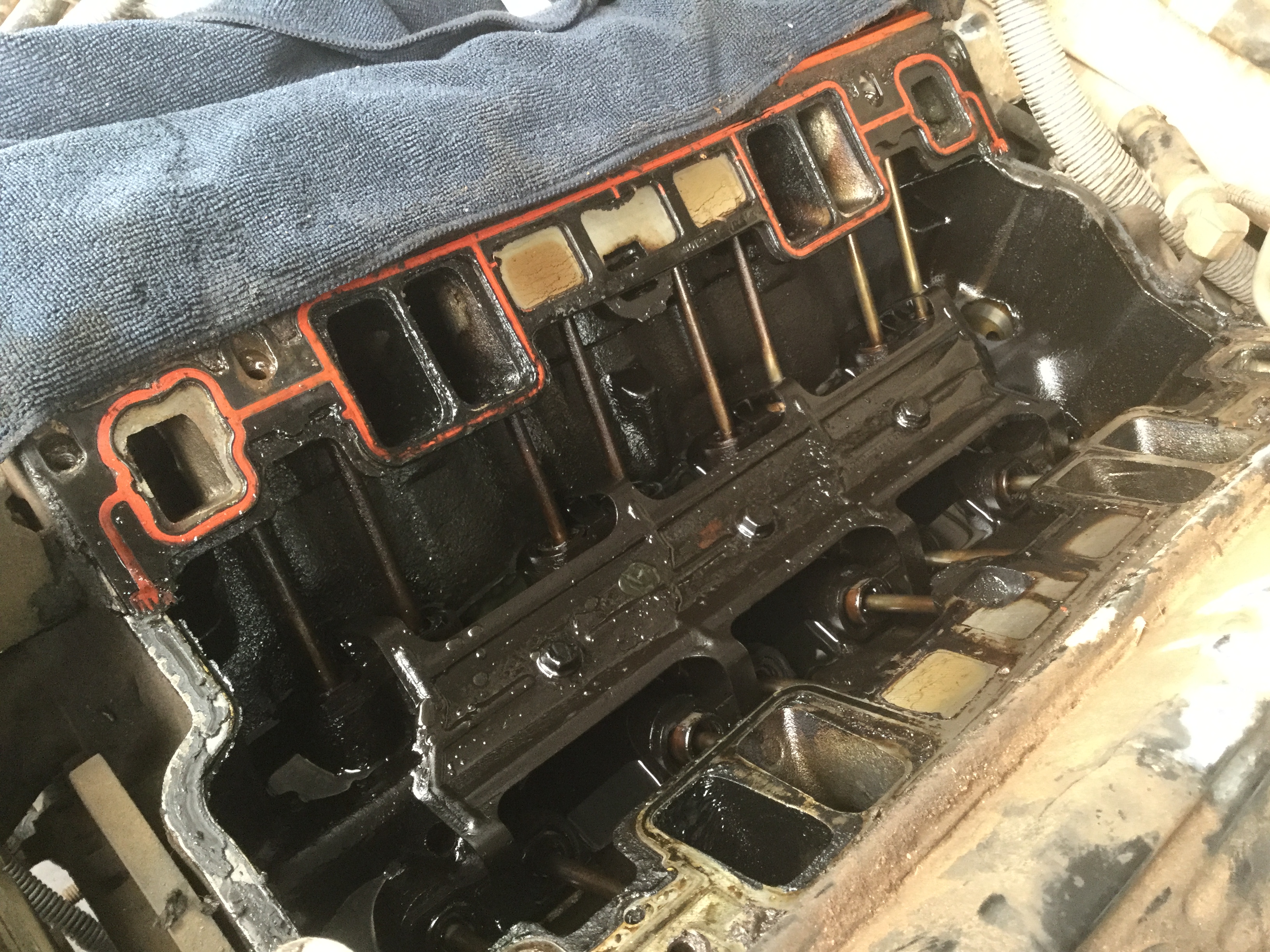

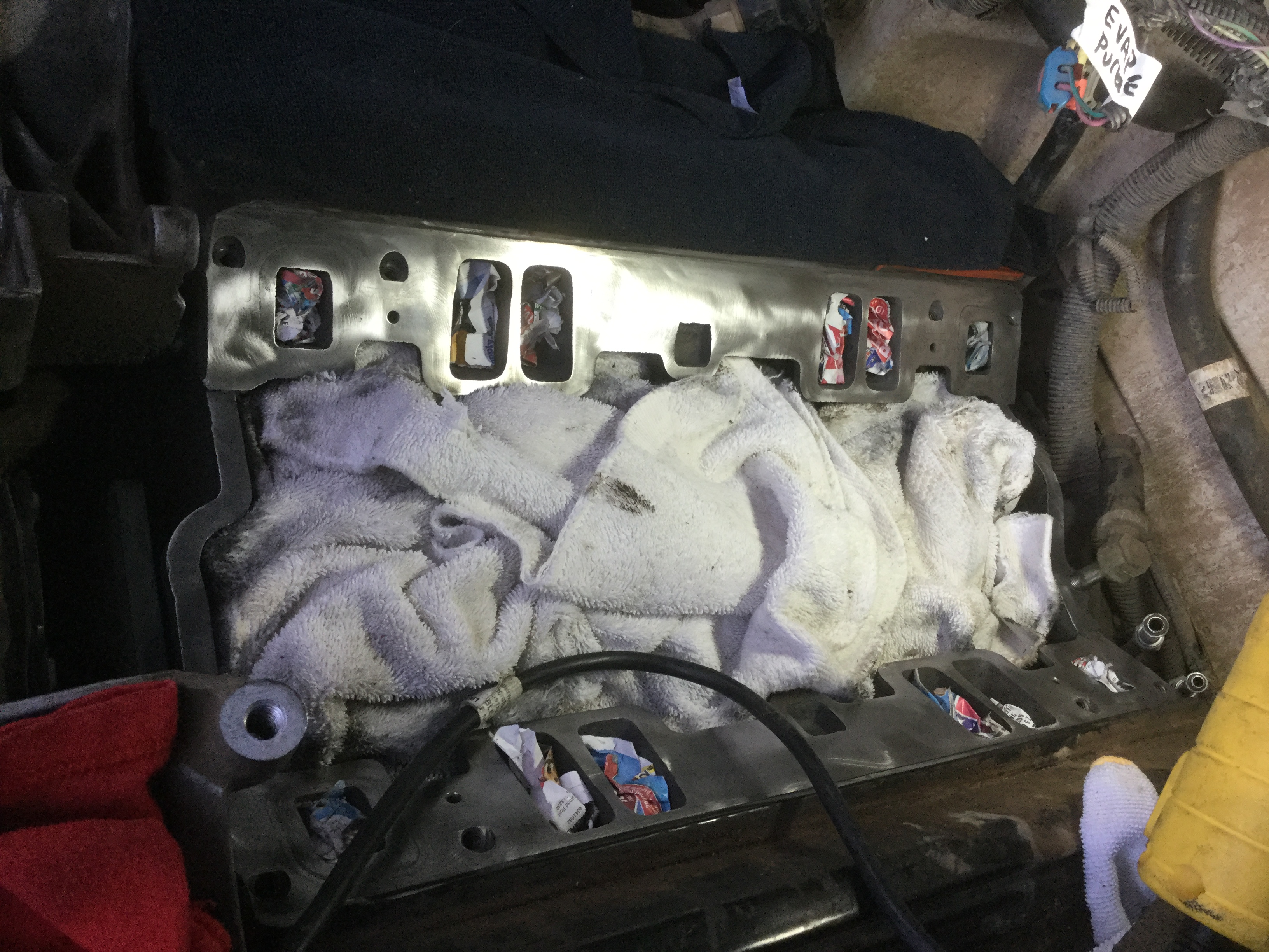

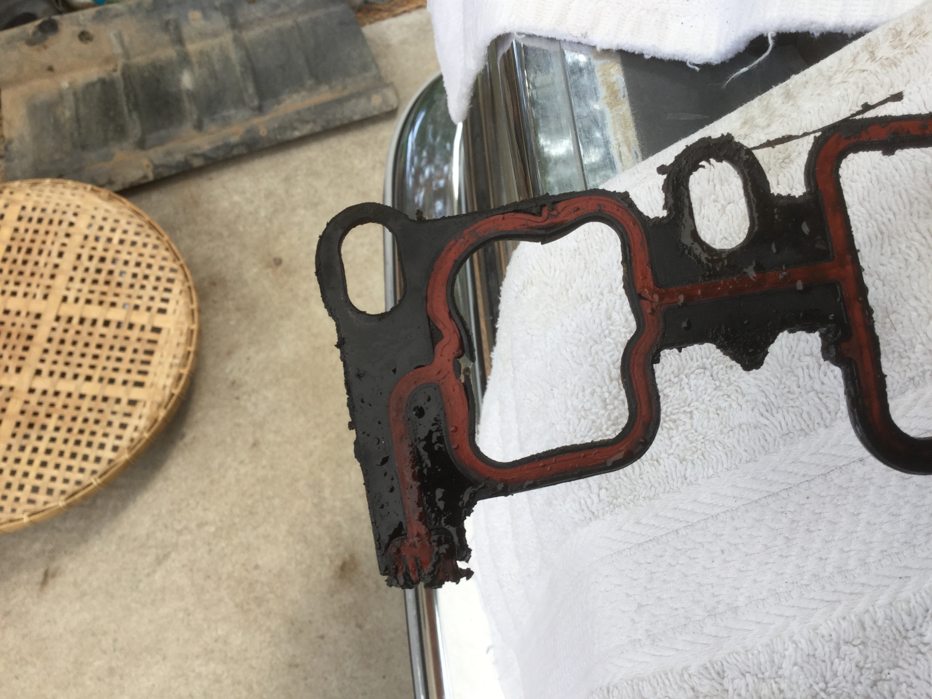

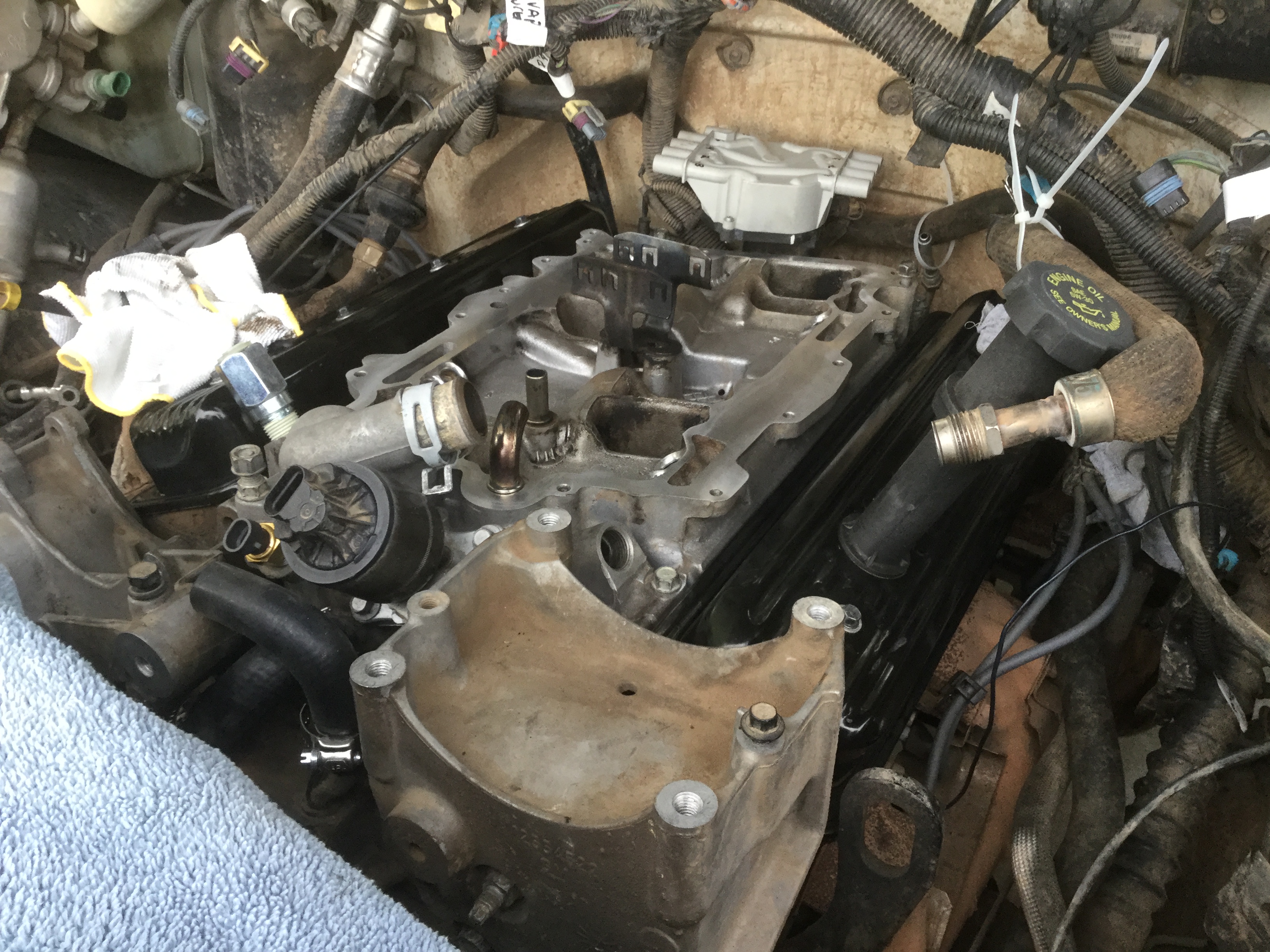

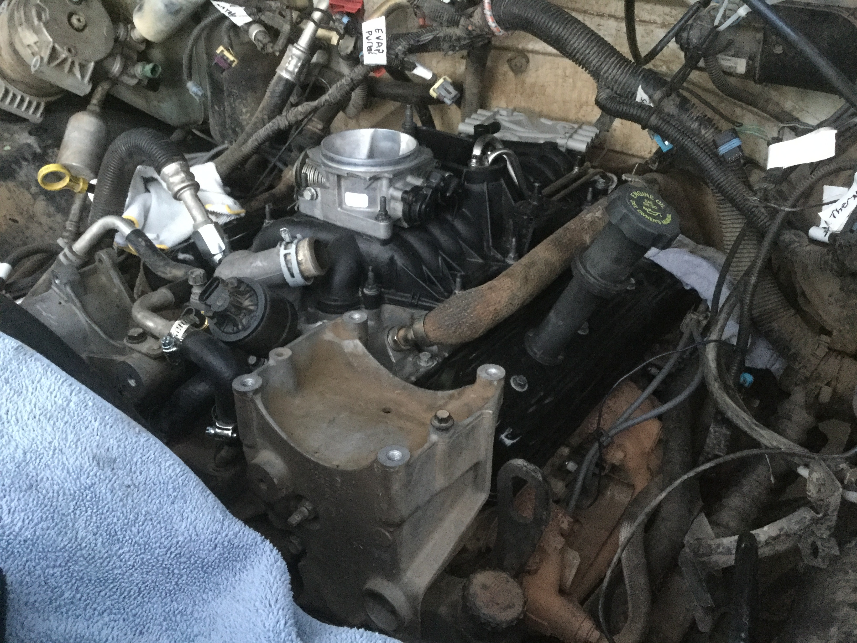

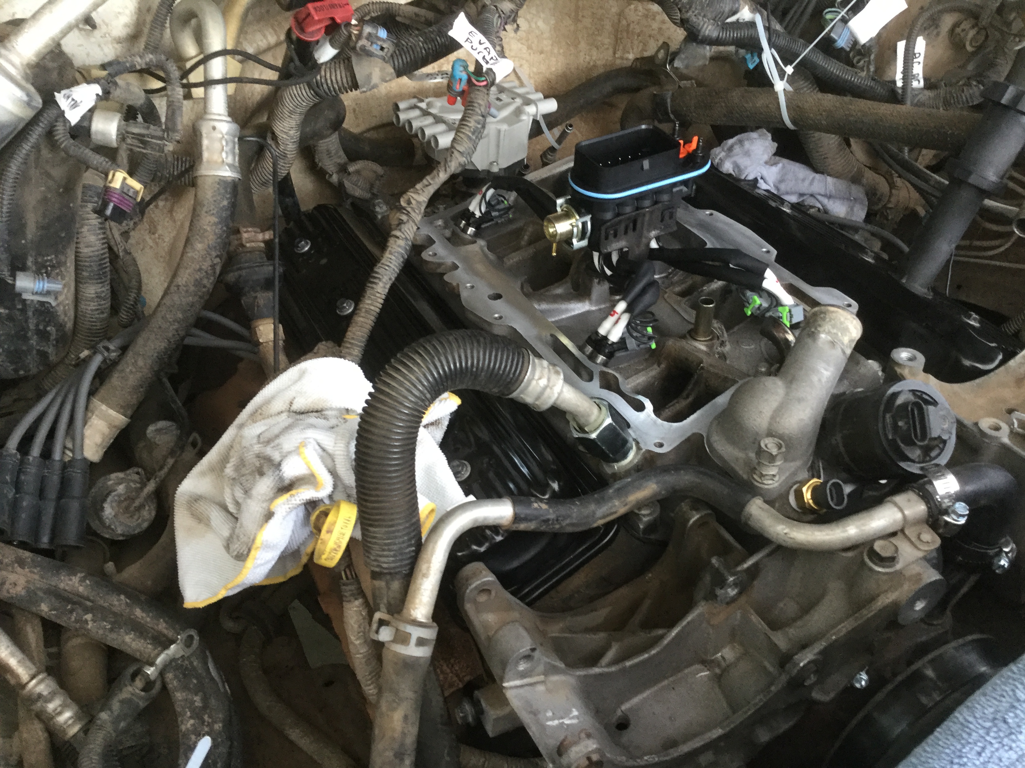

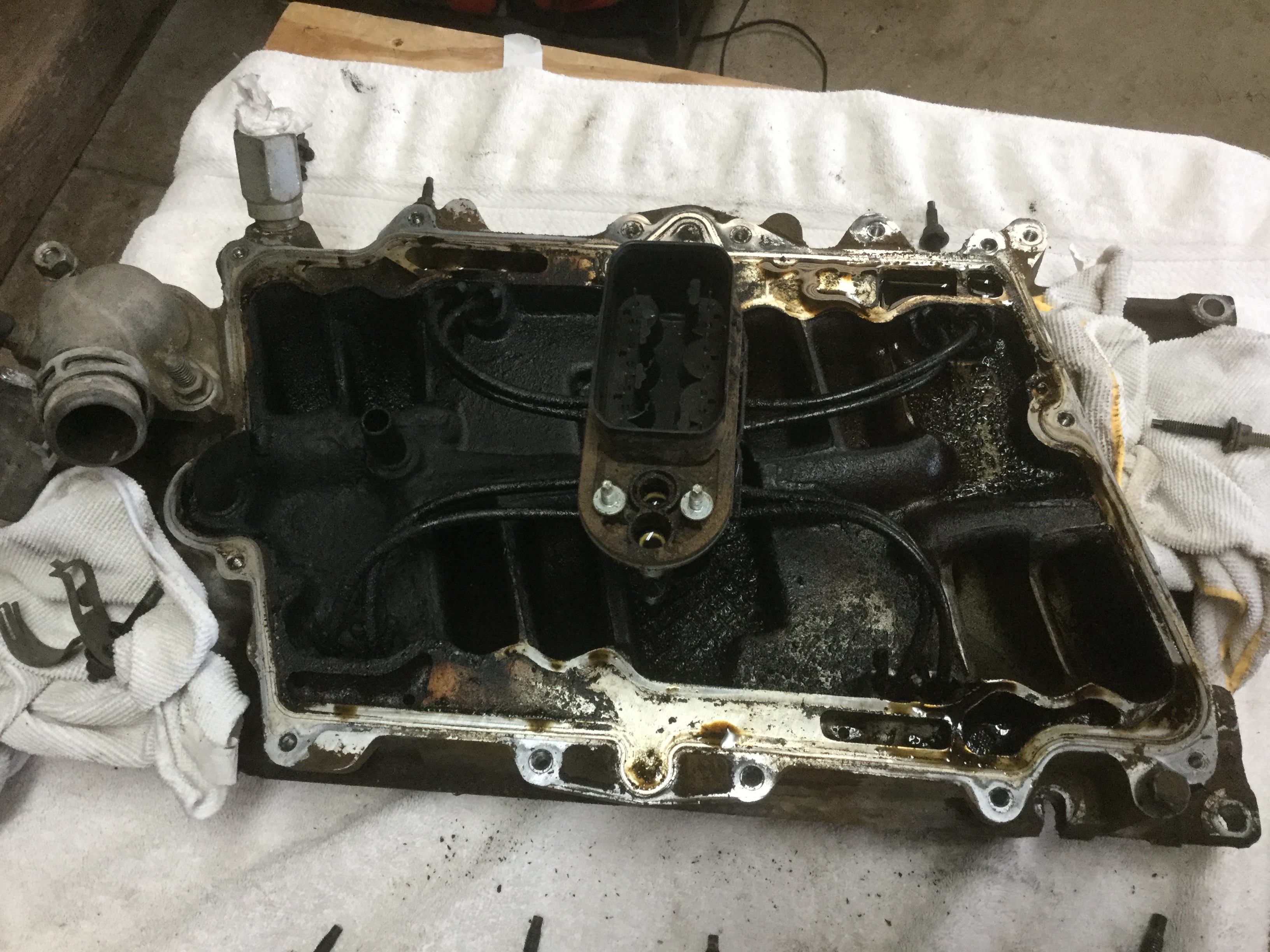

I used brake cleaner and sprayed it around the lower intake manifold and discovered a vacuum leak. I've removed and replaced the lower intake manifold and replaced the failing gaskets. It was throwing a random misfire followed by a cylinder 5 misfire as well as a high and rough idle since I bought it a few months ago. Then the strange sound appeared which brought me to this forum. When I sprayed the brake fluid along the edge of the lower intake I could hear it get sucked in around the cylinder 5 port area. This was confirmed when I removed the lower intake and found that the gasket was curved when installed and was sagging just over the top of cylinder 5 port ..... basically not sealing and creating a vacuum leak. In addition I found the water port seals were beginning to fail. Which possibly explains where the coolant was going and why the oil was turning dark soon after being changed.
I've attached some pics for you to see what I found.
So I've been working on installing the new lower intake gaskets (felpro ms98000 metal back instead of the plastic version) along with replacing the original spider injector with the new version and the upper intake gaskets. I hope to complete this project this weekend. Hopefully this will resolve the high idle, rough idle, random misfire, cylinder 5 misfire and strange squeal. I'll let you know how it turns out. Thanks.

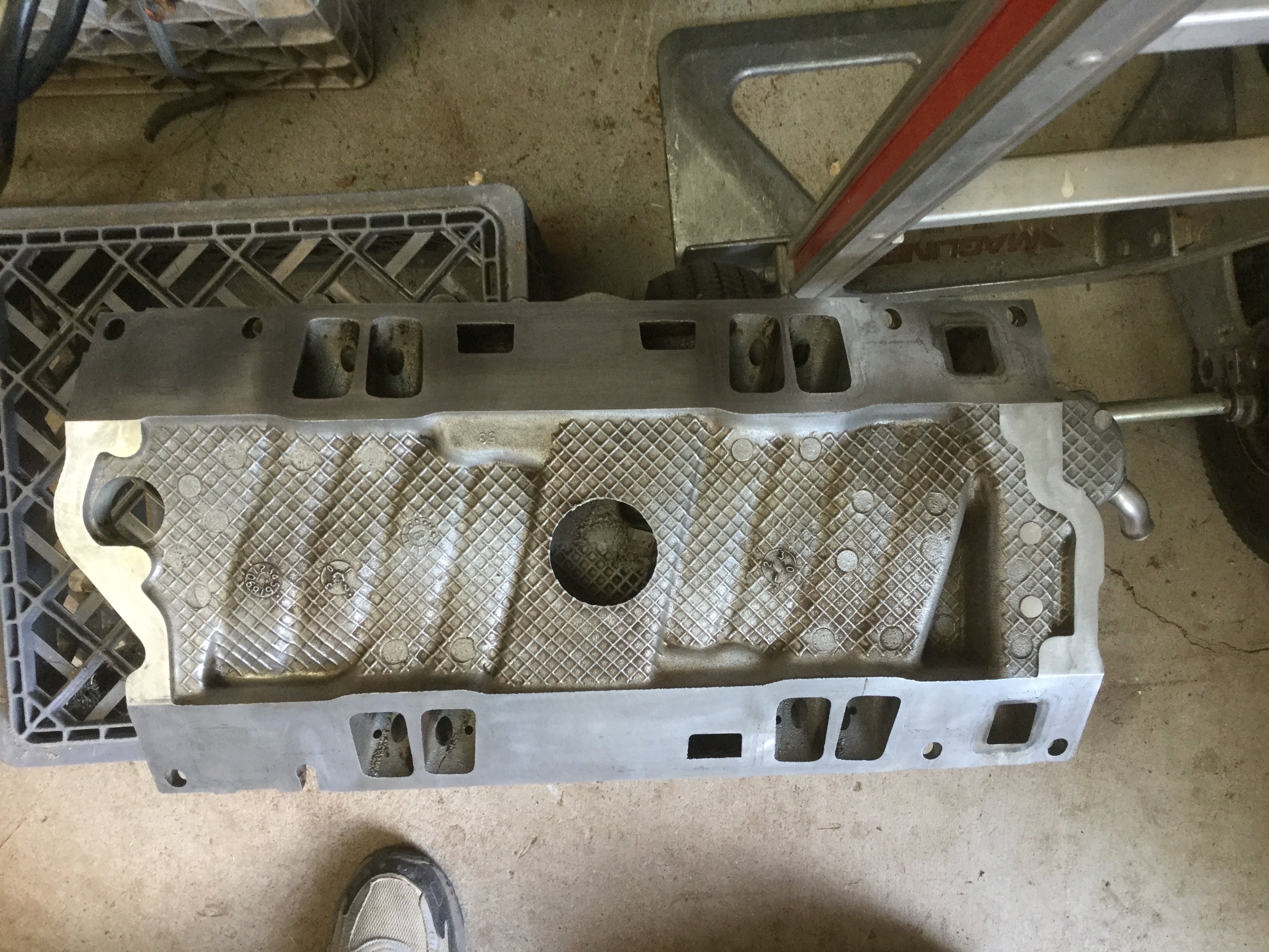

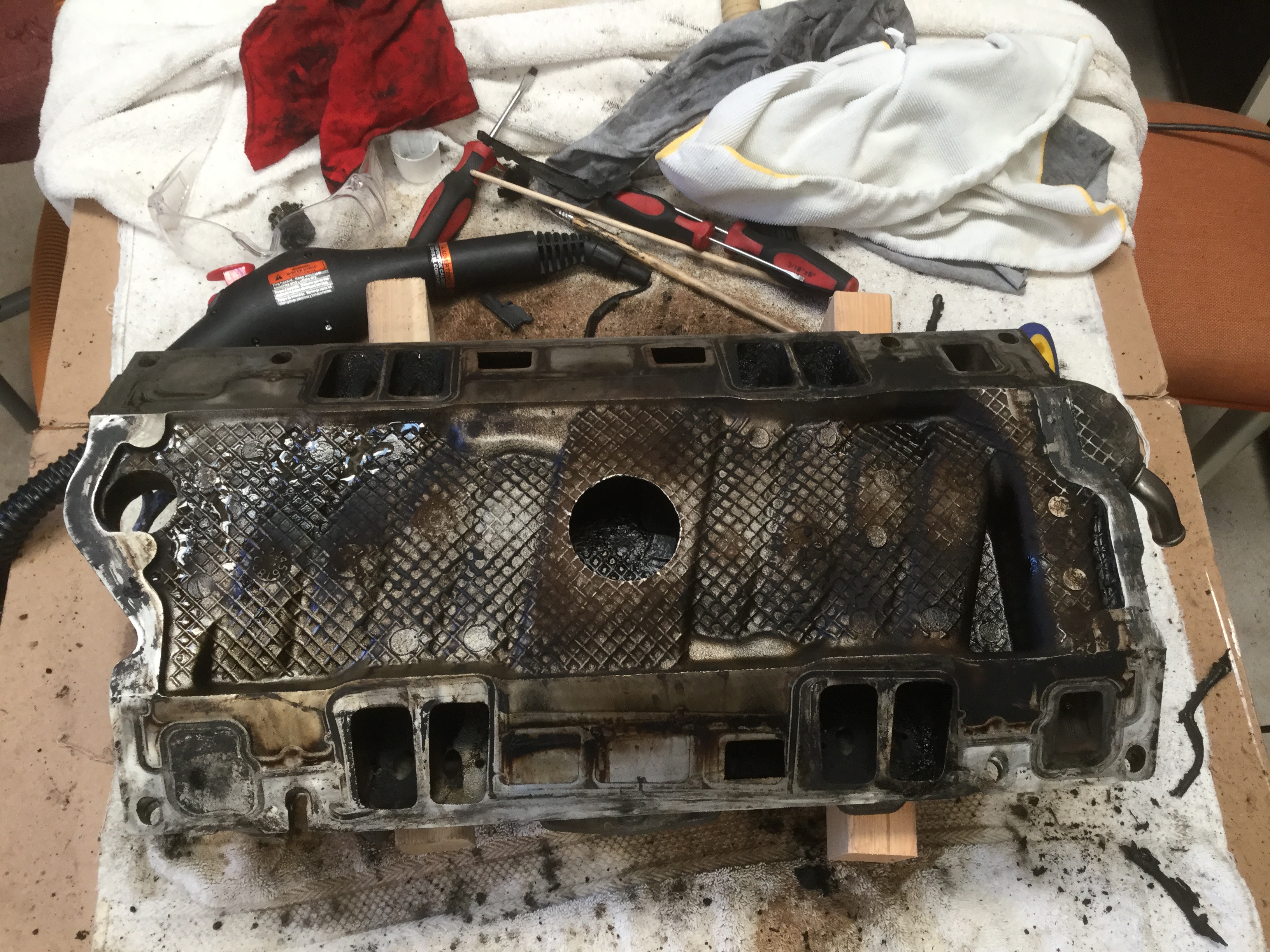

Default Lower intake top/bottom
Before and after cleaning

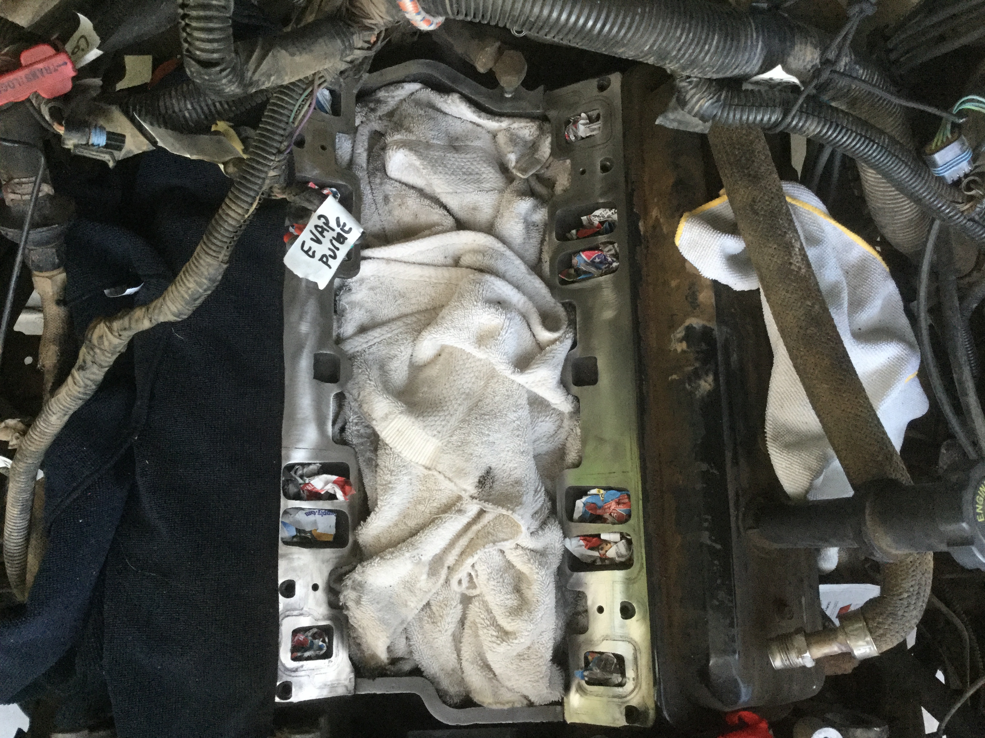

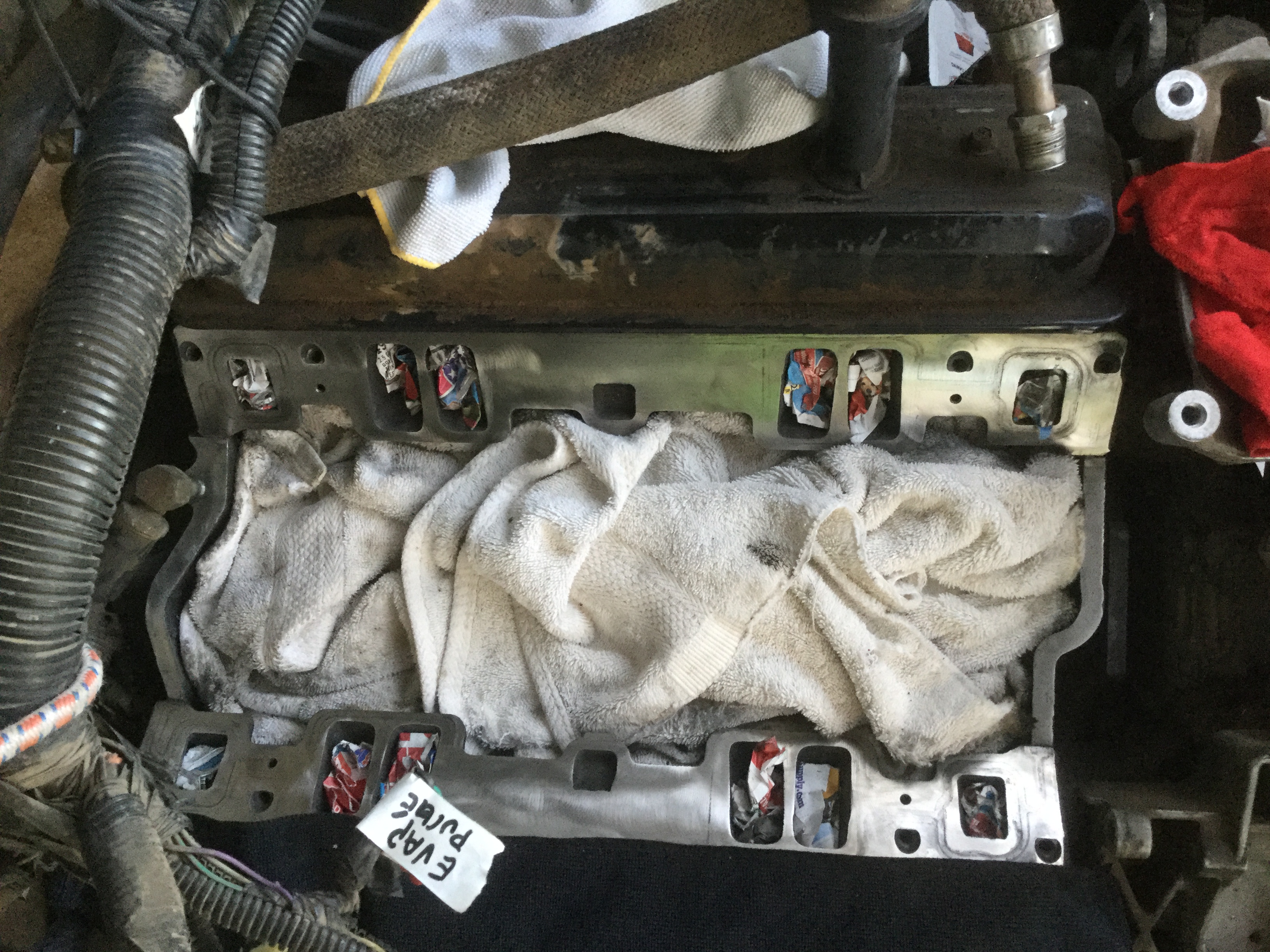

Default Block cleaned and prepped
Pics of the block cleaned and prepped.

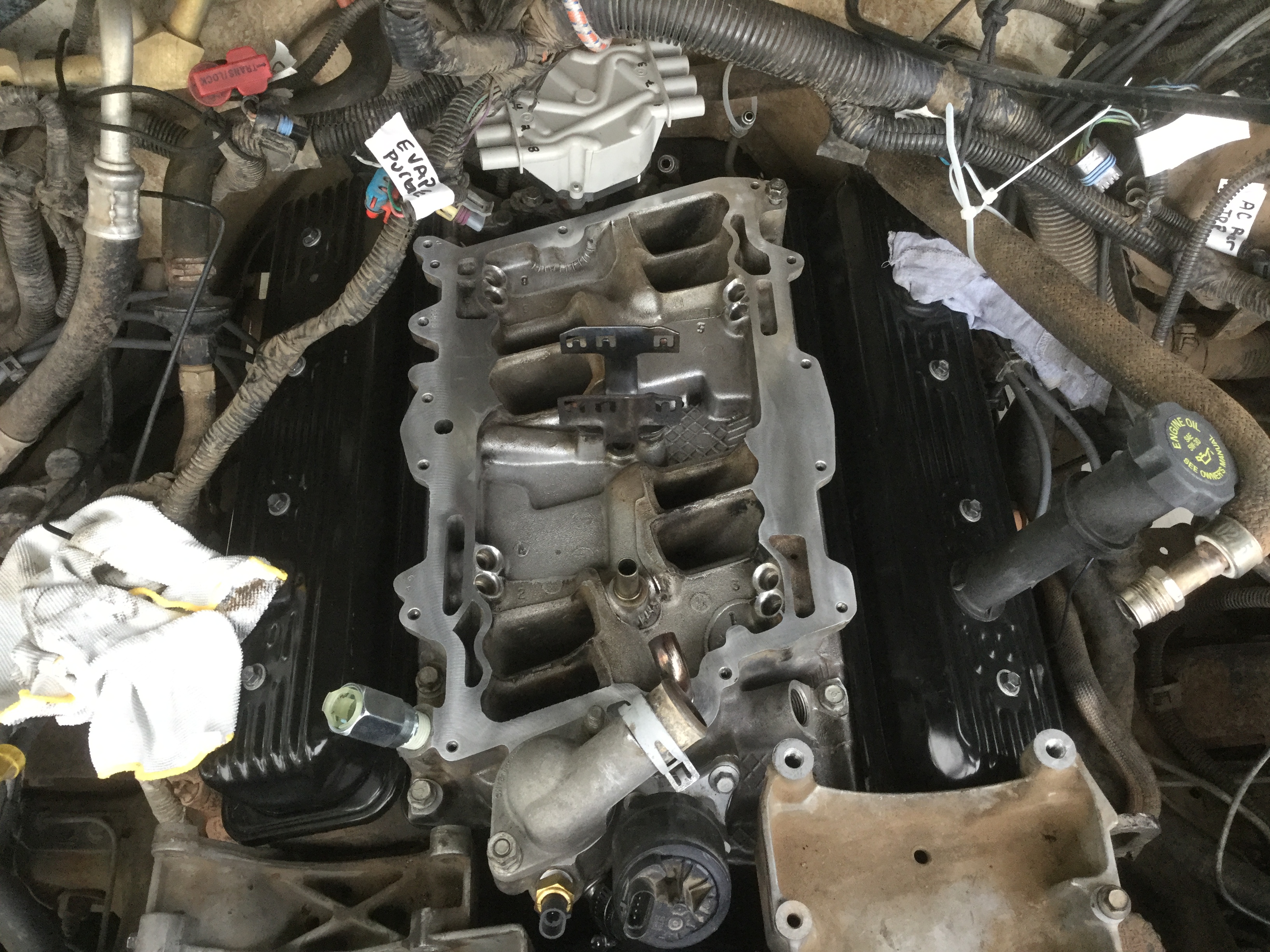

Default Lower intake installed

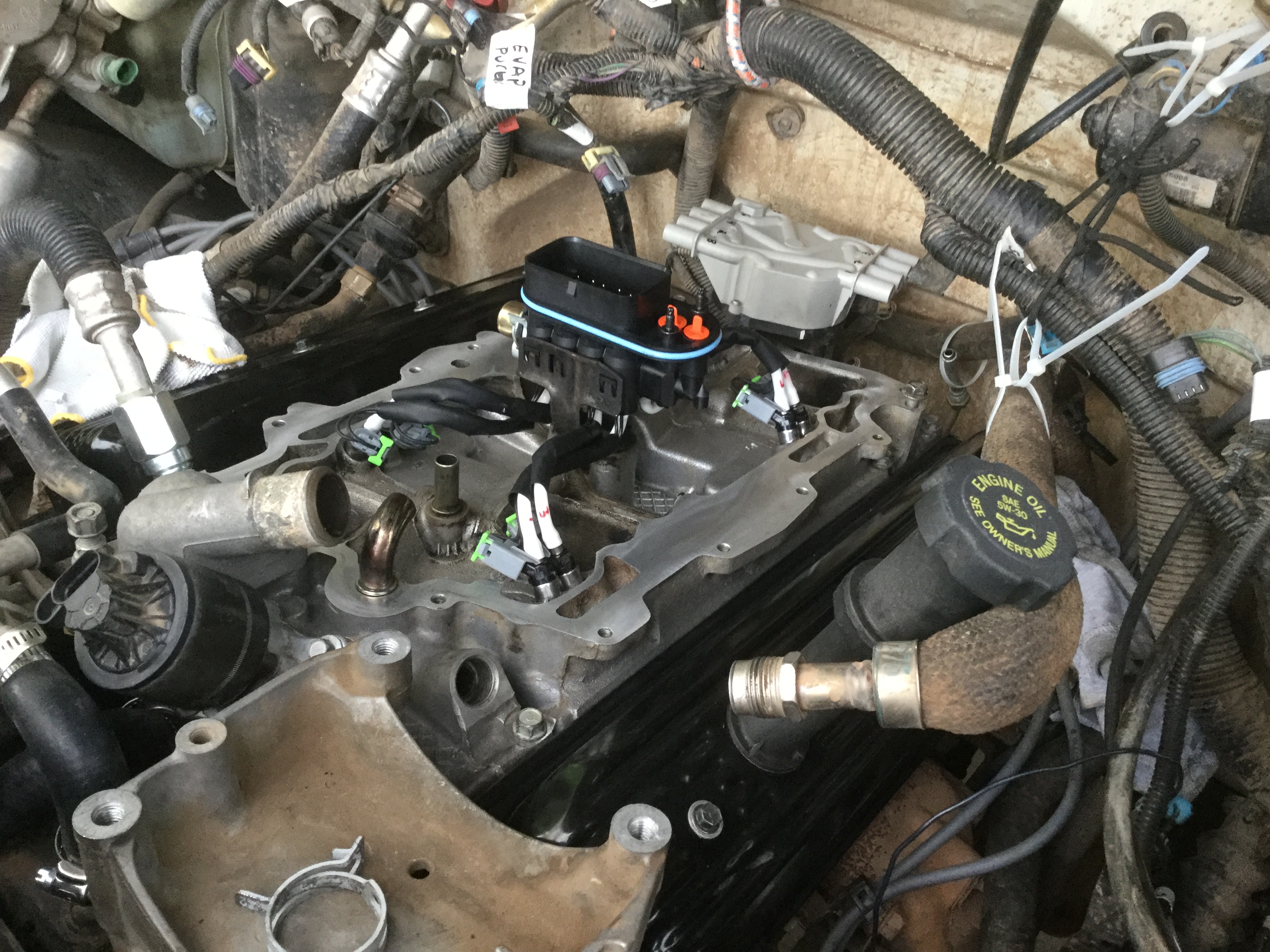

Default Updated spider injector
Updated spider injector Installed
