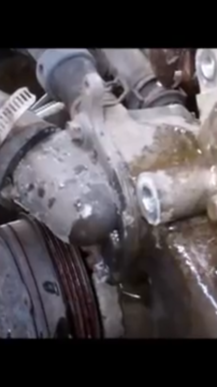

So I was looking online and saw someone post something interesting about the water pump and thermostat. Since this truck is new to me I don't know the maintenance history. They said that if the thermostat had 2 holes on the top of my he housing then it mounted to the original water pump. If it has 1 hole then the water pump has probably been changed to a new style. Below are photos of mine (single hole) and 1 from a video I saw online with 2 holes. Does this info sound reliable, would your guess be it has a newer water pump?
Ok so I was only able to up load one photo but the other t-stat doesn't have the empty hole at the top of the housing.

I assume you are talking about the fan clutch and not the thermostat?
