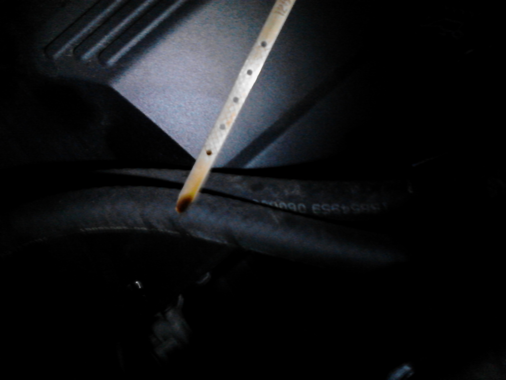

Good Morning All,
It has been a little while since posting....12/18/12 was my last oil change. I am sort of kicking my own butt for not posting about a month ago. I checked my oil then which was near 1,500 miles on the oil change. I was shocked that I was on the fourth hole on my dip stick, so since not really low I did not post?
Last night while out on the two week Walmart run, I noticed a message from the DIC "add oil, low oil." Awesome!!! My wife drives this vehicle everyday, so not sure if this notification was showing earlier in the week or not?
Back at home and the groceries put away, I go back out to check the oil. I am down on the very tip of the dip stick....see first pic at bottom of this post.
I only had a single quart of Havoline 10W-30 on hand at the house, and so added the quart. This brought me back up to the forth hole on the dip stick....see second pic at the bottom of this post. I did start the engine for about a minute to circulate this quart and to see if the "add oil" message went away. This did remove the DIC message.
My oil life is currently at 64% and my mileage is 97,674 which puts me at 2,348 miles on the this oil change. So once again we are at a little over one quart consumed in around 2,000 miles. I am going to grab another quart on my way home today to bring it up to the max capacity and the fifth hole on my dip stick.
I am going to talk again with my auto shop this week to see which of the multiple ideas we should try first on correcting this problem and if he thinks I should get a dealership involved in this mess. I did not purchase any type of extended warranty on this "used" vehicle, so not sure that I will get much done without hurting my wallet and just not a lot of "EXTRA" cash laying around these days!!!

I doubt one qt in over 2K miles @ 97K miles is going to get you any relief. Don't know what the current trip point is but 40 years ago, it was one qt/500 miles.
