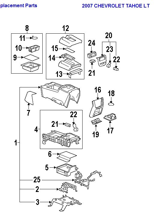

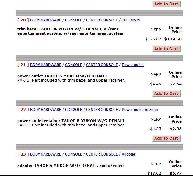

Thanks for the replies guys. I was able to get the outlets working however I need to find a replacement for the one in the rear of the console. Anyone know where to find those outlets I looked on gm parts direct can't find them.

I believe item #21 is what you are looking for on GMPartsDirect
Checking with your local Dealer as CCS stated is a good source also... they may also match the GM Partsdirect price...
[ 21 ] BODY HARDWARE / CONSOLE / CENTER CONSOLE / Power outlet
power outlet TAHOE & YUKON W/O DENALI
PARTS: Part included with trim bezel and upper retainer.
MSRP Online Price
$4.46 $2.64

That is it in2pro thank you ordered 2 so I have a spare
