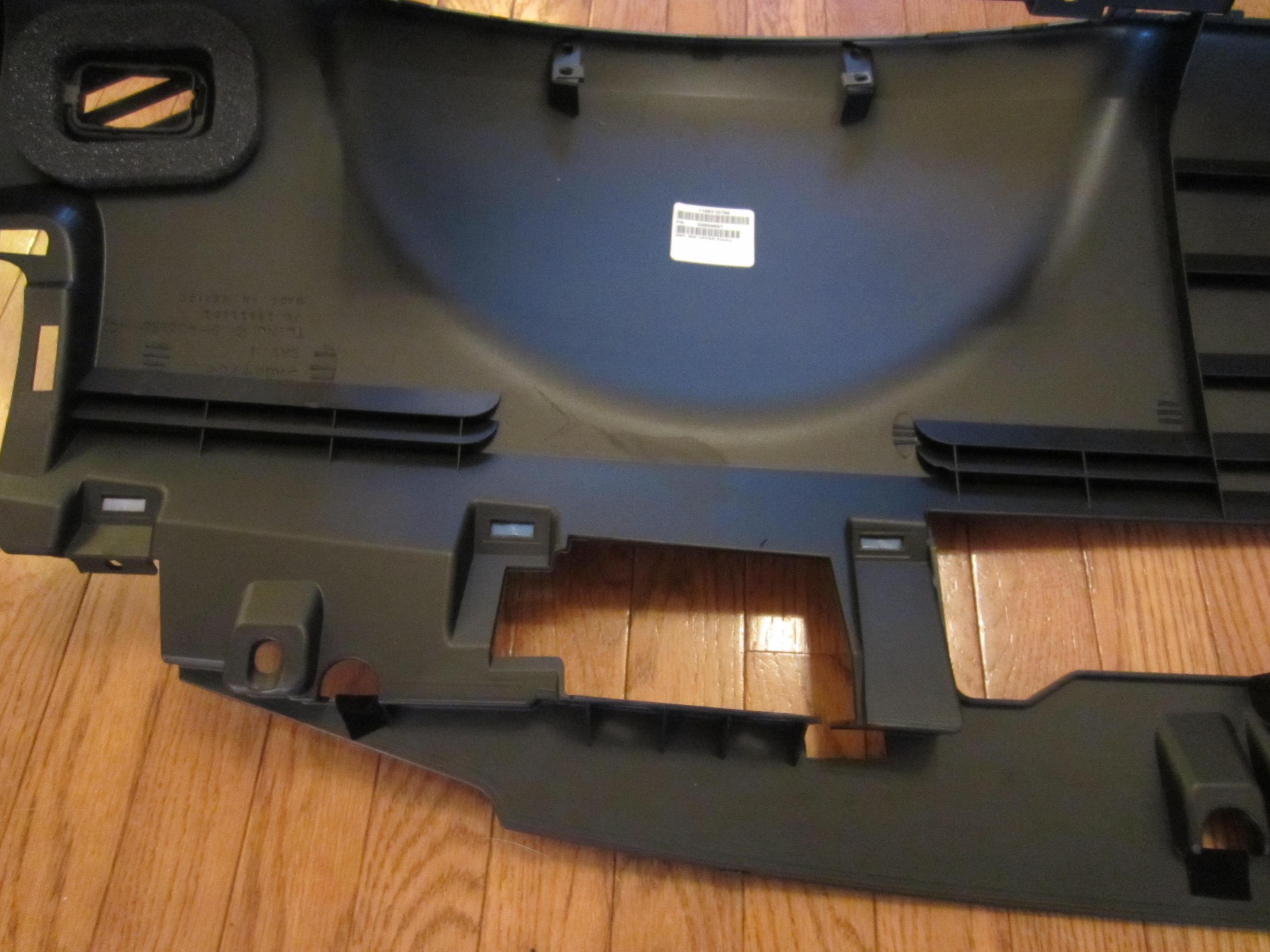

Note the difference in the design between 2007 and the part just installed
Attached Thumbnails 2007 tahoe ltz dash has cracked????????-img_2702.jpg   2007 tahoe ltz dash has cracked????????-img_2706.jpg
Interesting, they put reinforcements at the cracking point....
They put the re-enforcements, probably because they know the old design is garbage. Now they need to fix their mistakes.
