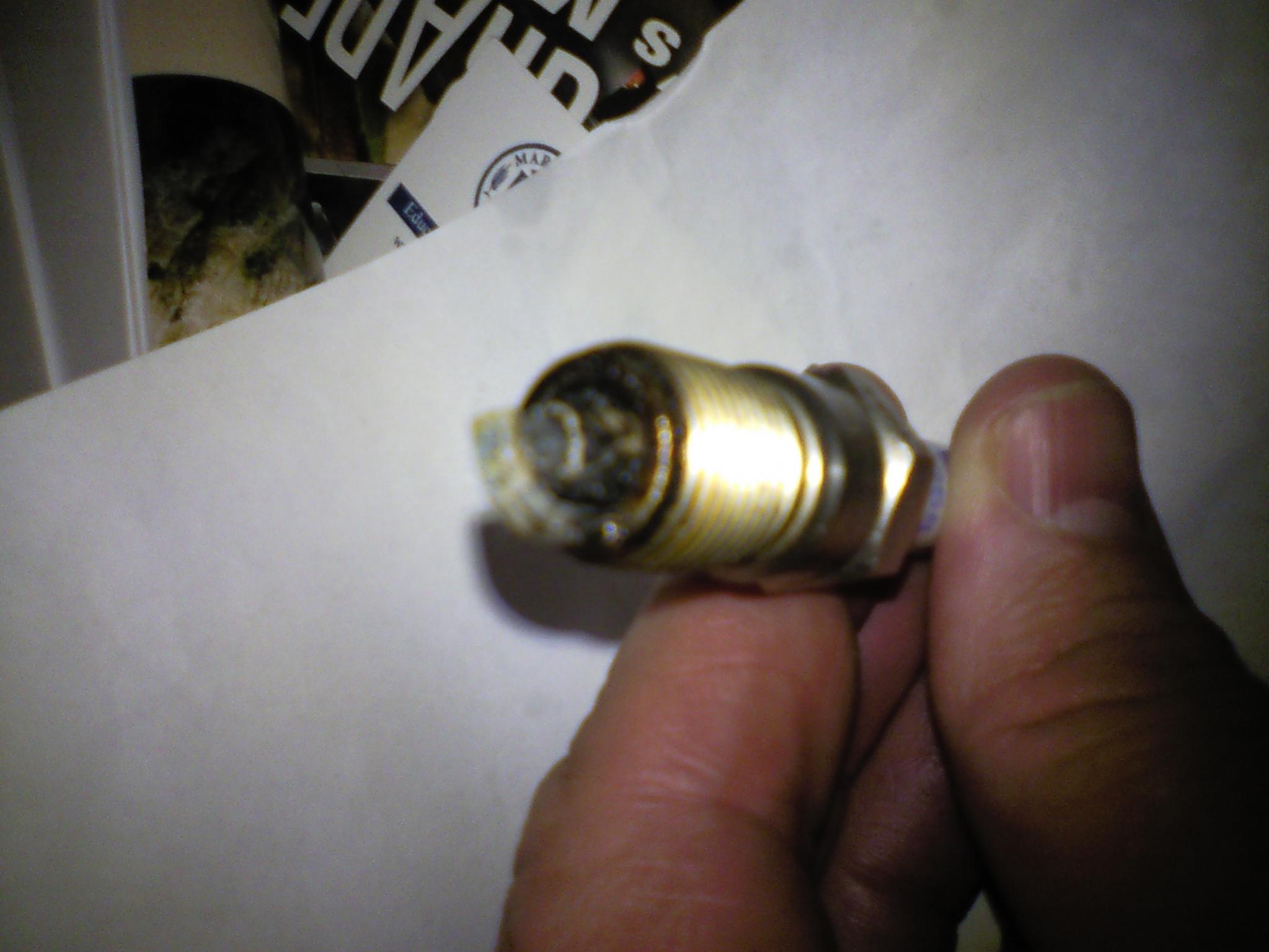

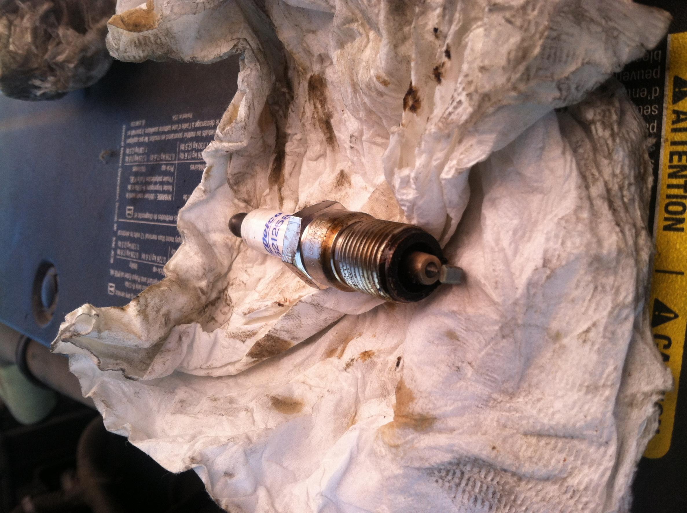

I pulled my #1 plug as well as the #2... at 82k miles on my 07 mine was not too bad, did have oil on it though... I do not however have any issues burning oil I might add a half quart between oil changes... attached # 1 and #2 spark plugs...
Not a good shot, but this is after I cleaned it. It was packed with carbon between the electrode insulator and the metal body. Not good. Mine chuggs a quart every 2000 or a little less mileage.

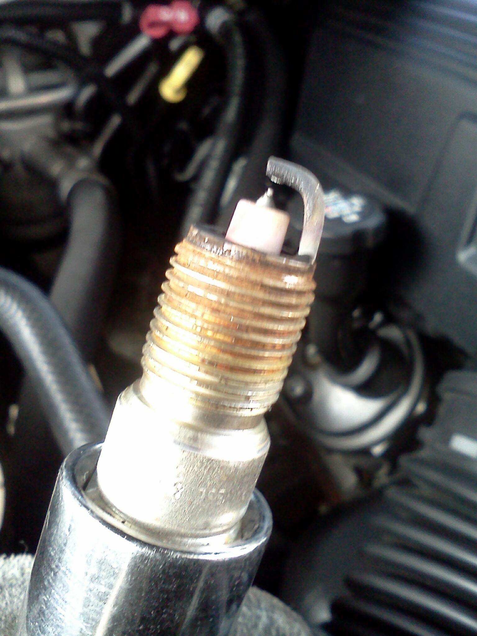

I changed this with less than 3000 miles. I started to feel a miss. Notice the oil up the threads. Not as bad as the last plug which had less than 10K on it, but it's heading in the same direction. The engine took 1.75 quarts after 3000 miles. That's through one piston. Thank you Chevrolet.
