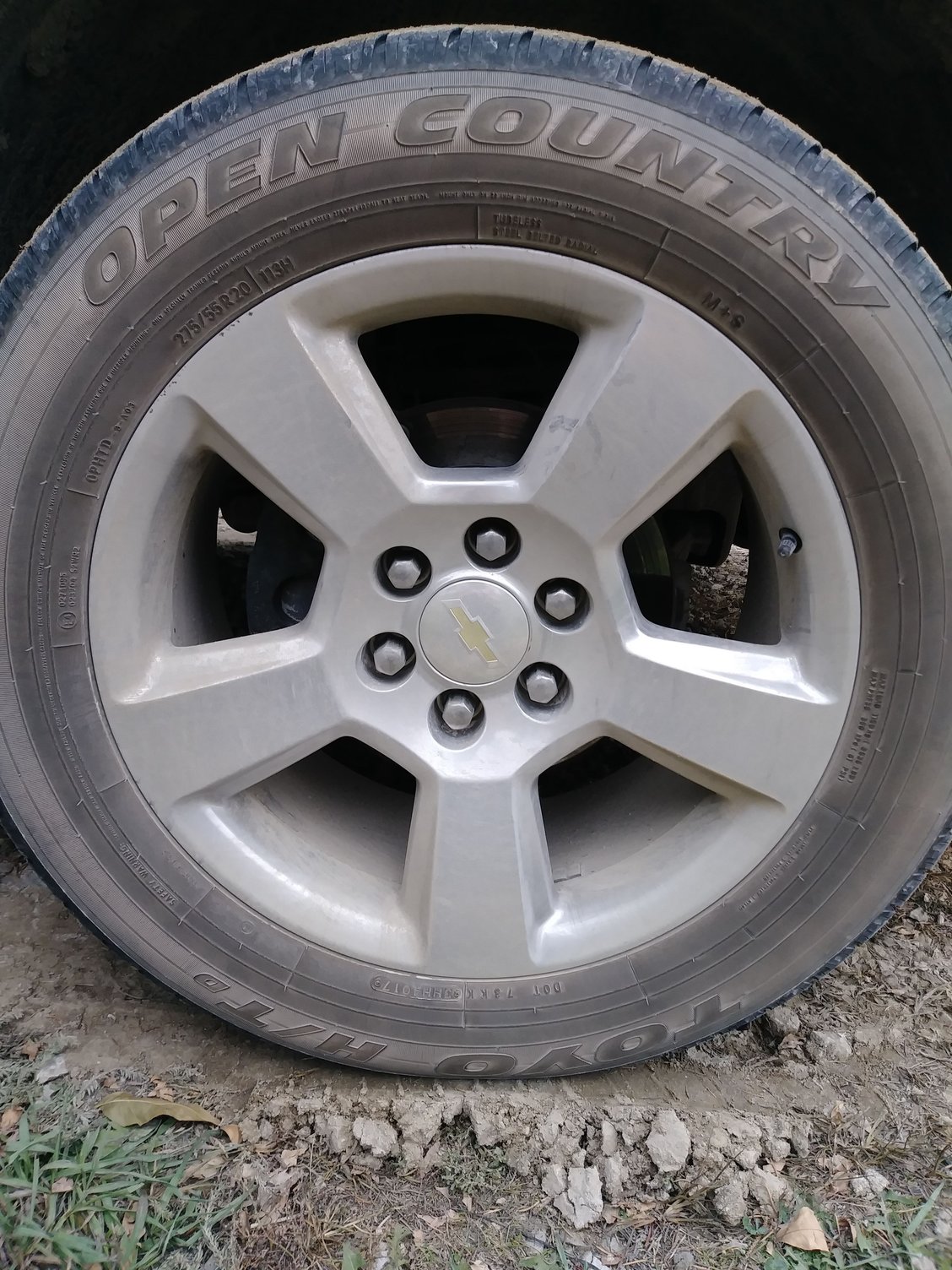

Howdy!
I just purchased a 2009 Suburban and noticed that the spare is a 17" rim size, but the wheels that are on the vehicle are 20". If I find a matching 20" rim to use for the spare, will it fit up under where the 17" spare is now? I think it should, because, I think the 20's are a factory upgrade.

Easy enough to check. Measure the spare tire seating cavity and check the size of tires on the rig and see if will work. The 20's likely have a different/lower sidewall profile and likely will fit.

My Tahoe with factory 20's has a 17 spare. P265/70/17 . Take a look at the tire sticker inside the drivers door and it will tell you the correct spare tire size for conformation. The spare has the correct diameter to match the '20's if you get a flat. No need to mess around with swapping out the spare.
