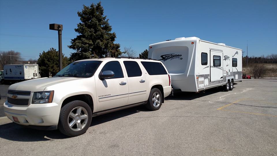

Trailer weight is estimated to be 7700 lbs fully loaded with dresser in the garage.
I am reading that the answer is to buy a bigger truck. Not financially possible at this time.

Well, then just understand that you'll be at or even over the limits of what your truck can handle. Be careful if you take any long trips pulling the trailer. My '01 Burb is currently wearing rear end #4 due to failures while towing.
Make sure you're using weight distribution, and keep an eye on your rear axle weight and gross vehicle weight. A properly-loaded 7700-lb trailer will have about 1000 lbs of tongue weight. Your Suburban only has a payload of around 1500 lbs, so that leaves you about 500 lbs for people, gear, and your trailer hitch. That ain't much. Ditto with your rear axle rating of 4200 lbs.
Have you ever weighed your rig? If not, next time you take it out, stop at a CAT scales for a weigh. Costs $10, and it'll be a real eye opener for you.

I am taking it to my buddys grain elevator and weighing truck, trailer empty, trailer loaded, tongue along with the bikes and quad separately.. I want as much information as I can get.
I also have an 05 Sub LT that has never had any problems pulling skid loaders, cars, other cars on trailers etc etc, and I have never felt underpowered the way I feel in this truck.
I really do appreciate all the advice, Y'all are awesome for helping me out.

Attached Thumbnails 2012 Suburban Tuner for towing a good idea?-12-sub-toyhualer.jpg
