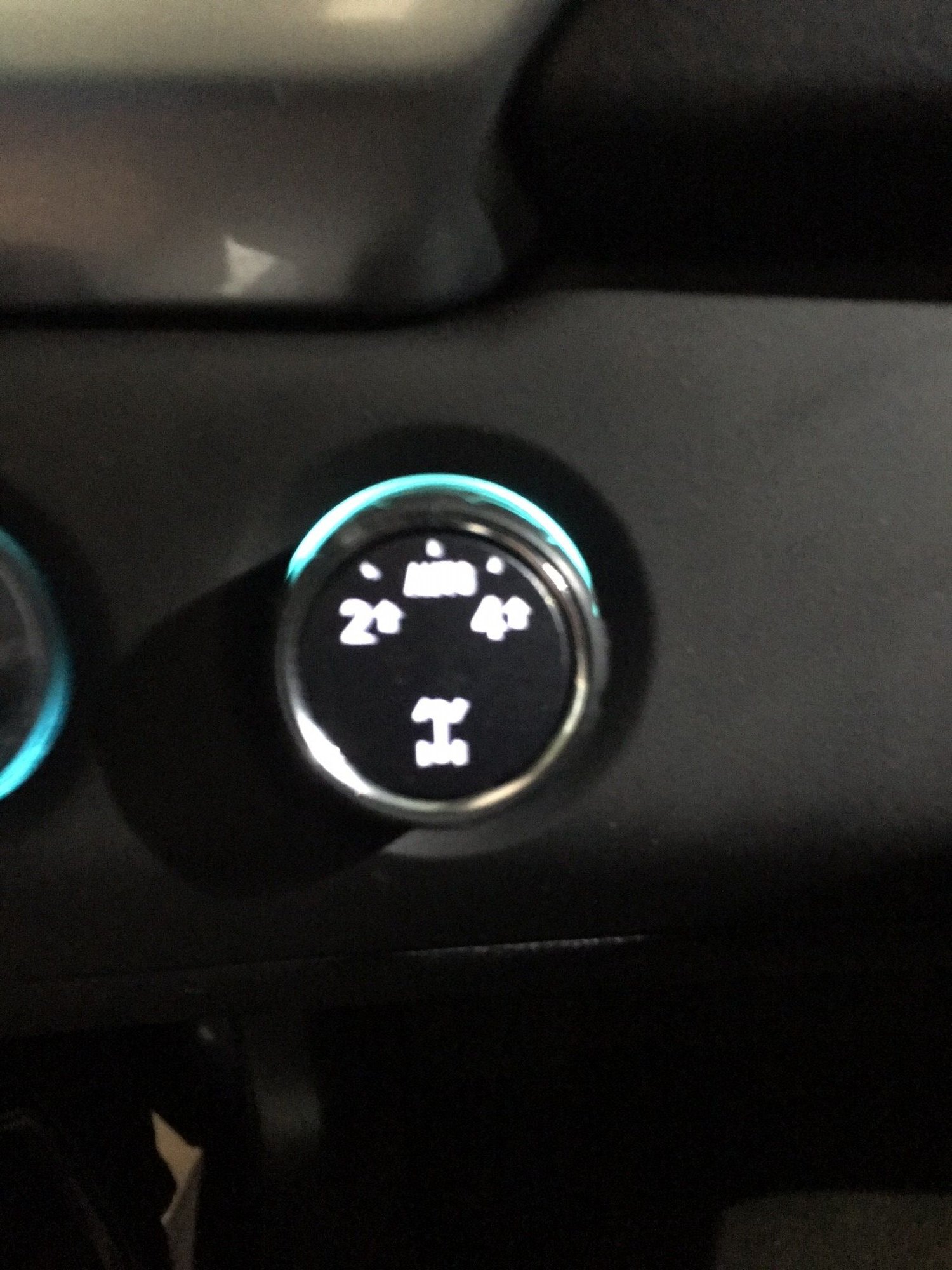

Hello everyone. I just purchased a 2015 Suburban LS 4x4. My questions is how do you put it in 4x4 low? My switch does not have the option like the others I have seen or like the manual states. Also does anyone have any experience with a front leveling kit and if so what are the Pros/Cons.
Thanks
Here is my switch
No 4 low option.

It might be automatic as to keep people from putting it in low. 50 years I've NEVER used 4wd low

you can't put it in low. the tcase is a one speed tcase. there is no low option.
if you like the look of a 1.5" or so raise or want slightly bigger tires go for it.
you will need an alignment afterwards.
ebcm recalibration for speedo correction if you change the tire size.

I'm guessing GM realized that 99.5% of drivers never used 4-low. Thus decided to save weight/cost/etc. by omitting it.

As others stated, you have a one-speed transfer case and no 4-lo.
I'm not a big fan of the leveling kits. It puts extra stress on your front CV joints and will likely cause premature failure. Is that really worth it for a "look?"

If by book, you mean the sales brochure, it lists a two-speed transfer case as an option. I think that started around 2009 or 2010.
Old Jan 29, 2017 | 11:07 PM
the owners manual is generic showing all build options.
