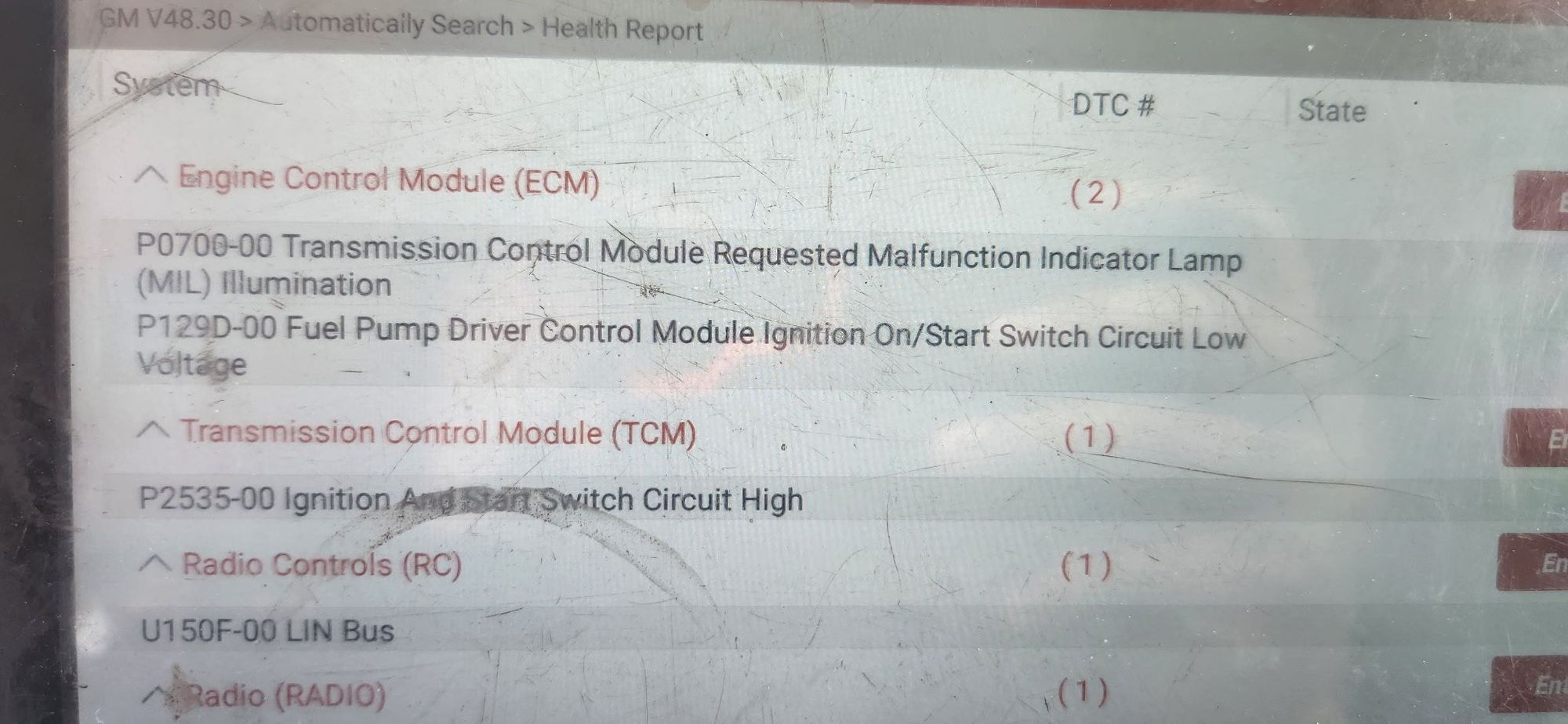

After a week of ownership the vehicle would not start. Brought to my mechanic and his computer showed the diagnostic below.
He changed fuel module, started right up. One week later, same thing. I bring it back, and it shows fuel module and ignition. He replaces fuel module under warranty and installs new ignition switch. Starts right up.

At this point I bring it to local dealership. They get similar codes, consult with GM tech support and go hunting for electrical. Check all fuses and boxes. Find corrosion on B2 terminal, clean that up and it starts.
