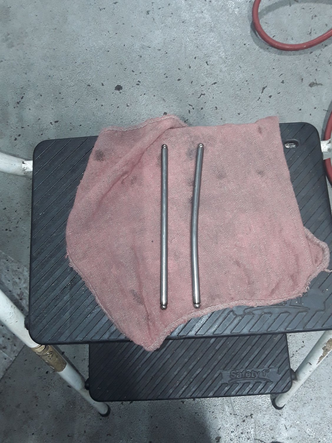

Have a 2021 1500 AT4. Bent pushrod at 9,000 miles, dealer replaced all lifters on that side of the engine. Today, at about 15,000 miles, engine light came on, took it to dealer, and they are going to replace the other side lifters. If it is worse then just a lifter swap then they said they will replace engine. Sad, as this is my first ever truck and GMC/Chevy. Makes me regret this large purchase, and totally lost confidence in this vehicle. Will share any more details I can get from the dealer. Sadly, no loaner or rentals available, so I rode my bike home 17miles in 100 degree heat. Terrible from a customer experience standpoint.
This can’t happen every 7-10k miles can it?! Lord have mercy.
attaching a photo of the first bent pushrod for reference.
