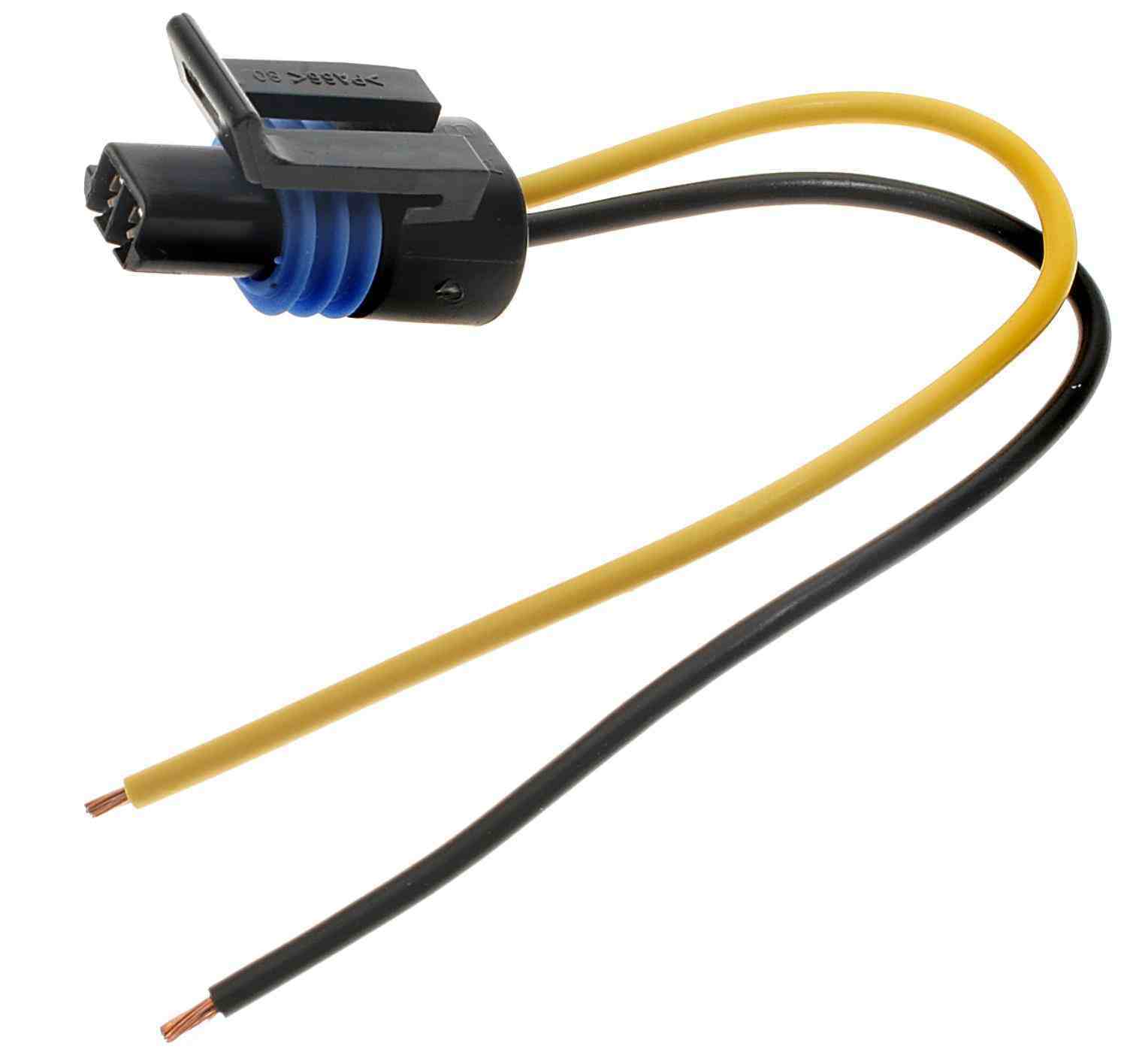

Coolant temp sensor connector part # is 88862305. The part numbers i gave you are all GM OEM part numbers. Sorry but I can't find a part number for the oil pressure sensor connector.
Here's a pic of the temp sensor connector.
Good luck!
