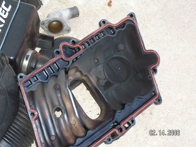

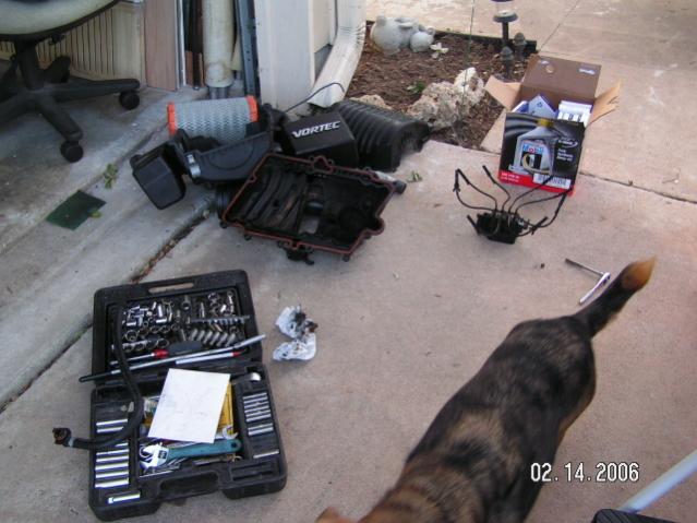

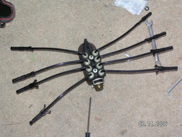

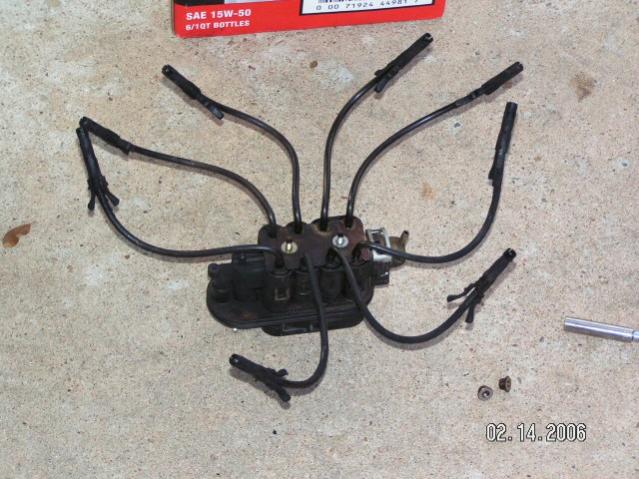

I did this on a Saturday, make sure you have everything you need
poppets, injectors, gaskets (fuel meter body, intake and fuel line) anti-freeze you will need to remove the top radiator hose and snorkle to remove the intake cover.
correction: I did it on a Tuesday not a Saturday, I would plan for 4-6 hrs to complete that's taking your time and stopping for lunch and explaining to kids what you are doing
Attached Thumbnails 97 flashing CEL & Running Rough-intake-cover-tbi.jpg   97 flashing CEL & Running Rough-intake-manifold-under.jpg   97 flashing CEL & Running Rough-intake-removed-.jpg   97 flashing CEL & Running Rough-intake-removed-view-2.jpg   97 flashing CEL & Running Rough-old-fuel-met-bdy.jpg

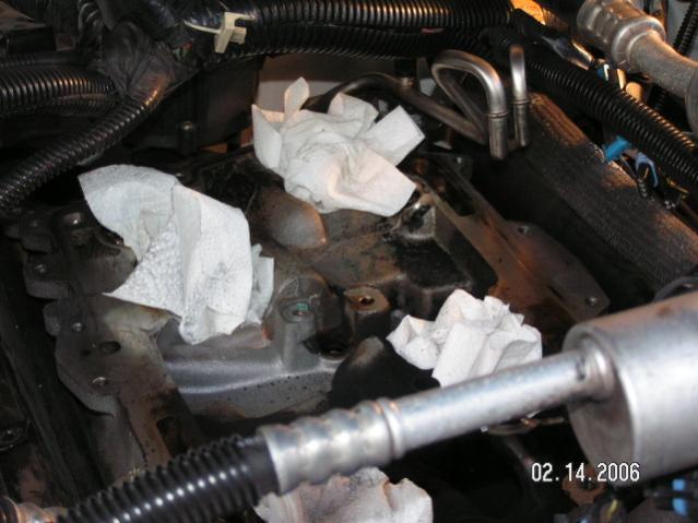

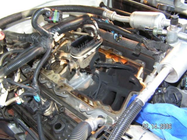

I used all AC/Delco parts, if I recall the gaskets came as a kit, also replace the pressure regulator while you have everything off, the regulator looks like it should have something connected to it but it does not..
Note the paper towel in the TBI, that was for when I was removing the intake to prevent anything from falling thru to the intake
protect the cylinder intakes after removing the intake cover, I was under a tree (lol shade tree) and didn't want leaves or twigs falling on the windshield and sloping right off into the intakes.
DON"T for get to removed the paper towels before installing the cover back on. I did use paper towels with the reasoning that if they did go it they would cause the least amount of damage and would probably burn and pass thru the system if it did happen, a shop rag would not.
Attached Thumbnails 97 flashing CEL & Running Rough-old-fuel-metr-2.jpg   97 flashing CEL & Running Rough-old-injectors-poppets.jpg   97 flashing CEL & Running Rough-protect-chamber-intakes.jpg   97 flashing CEL & Running Rough-rebuilt-fuel-body.jpg

a better view of pressure regulator and no special tools needed, worked with my 99pcs Craftsman set (okay yeah I have a few more pieces in it then it came with but nothing special )
the dog was supervising my work....
Attached Thumbnails 97 flashing CEL & Running Rough-rebuilt-bd-meter.jpg   97 flashing CEL & Running Rough-pict0015.jpg
