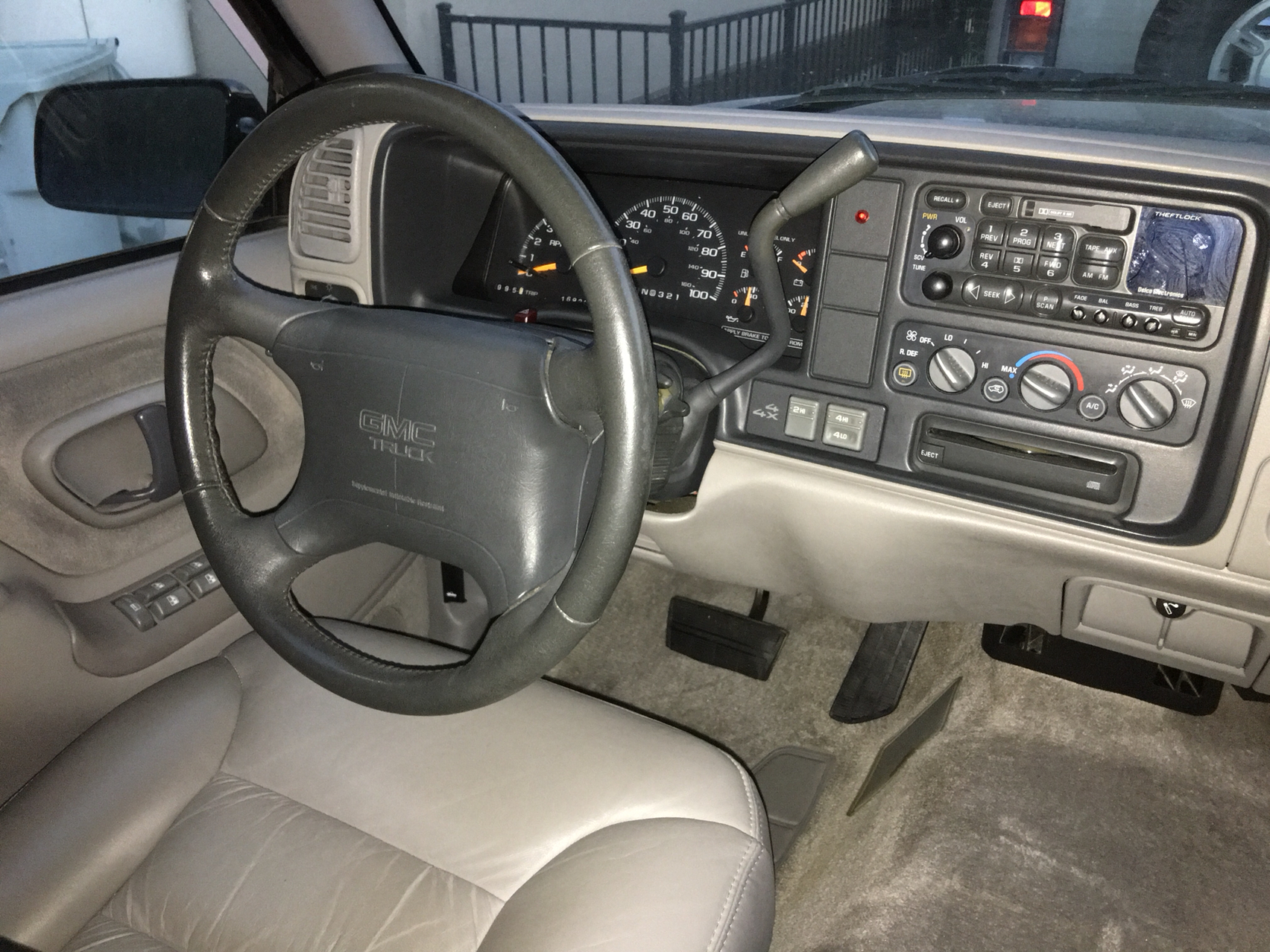

I was thinking about parting it out last week so I'm extremely happy in how it turned out. Thanks for your helps and encouragements.
Interior is good for a 20yrs old rig. 97 K2500 Suburban - Get or No-photo402.jpg97 K2500 Suburban - Get or No-photo319.jpg
Now things make sense as the Indy shop guy was willing to buy a broken rig for more than the market value.
