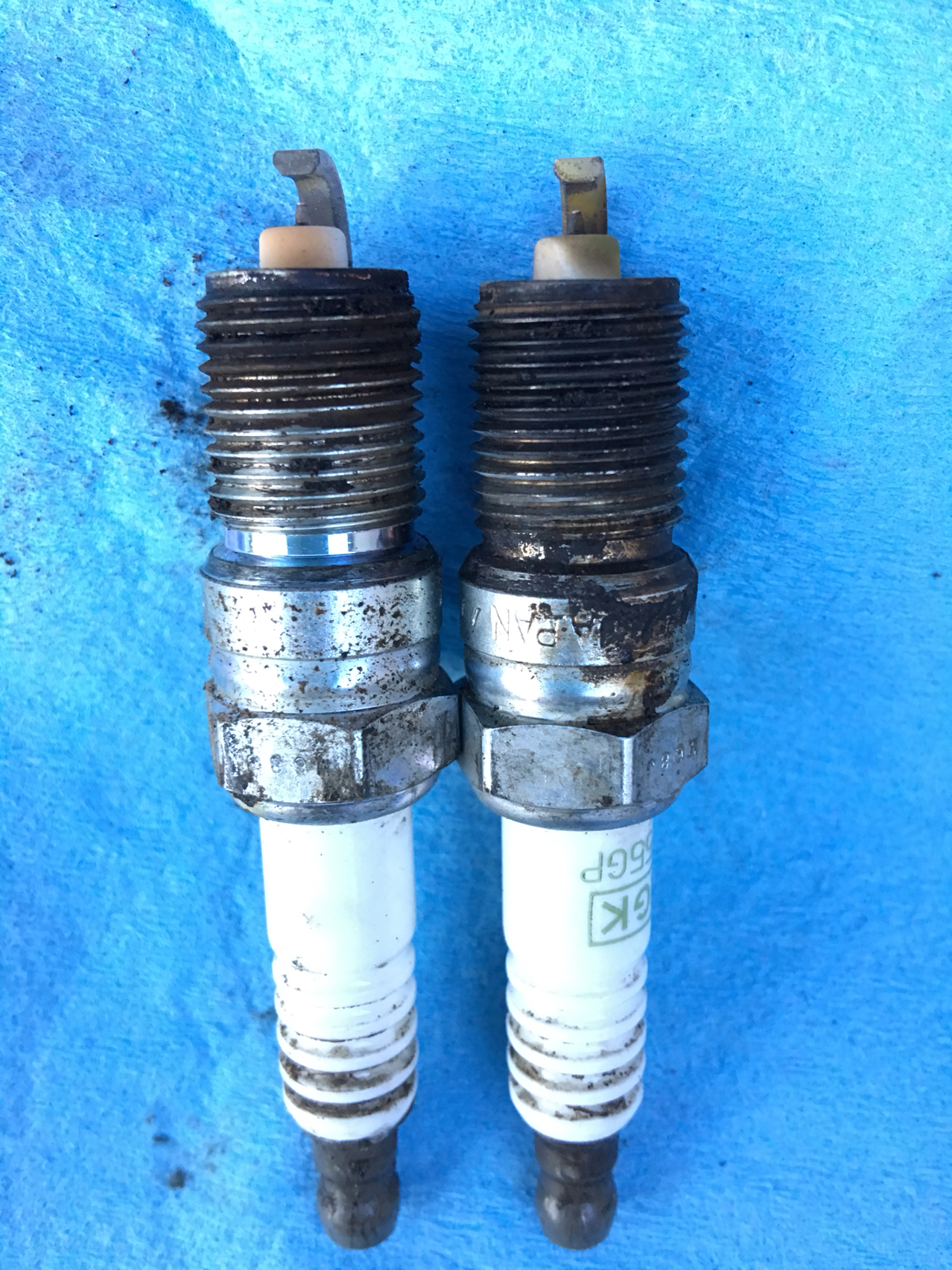

I pulled the spark plugs. No compression plug is on the right. Plug from good cylinder is on the left. Any thing obvious?
Attachment 10031
Also I need to mention that I can remove the plug from the no compression cylinder with bare hand. It wasn't torqued down at all.

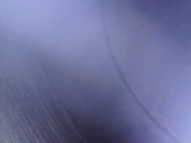

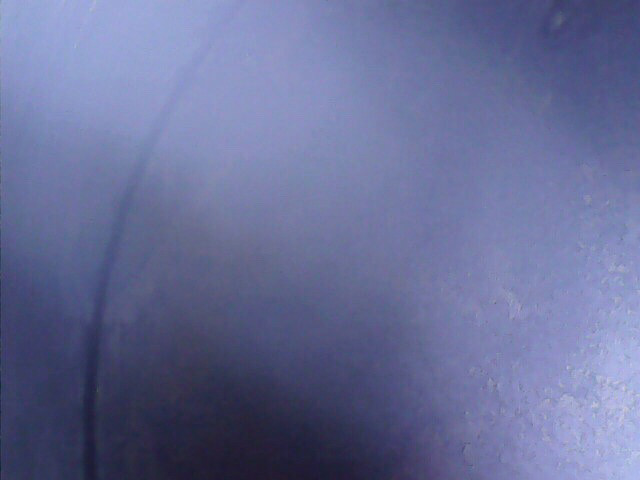

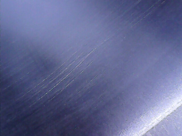

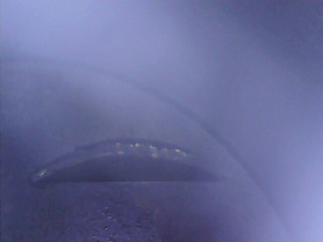

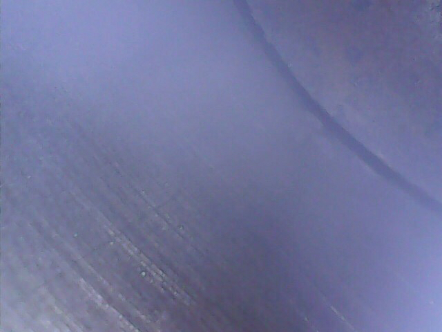

Here are a few images from the zero compression cylinder. I don't know what I'm looking at. Please let me know if needing more images Attachment 10036Attachment 10034Attachment 10033Attachment 10032Attachment 10035

The crosshatching on the cylinder wall looks OK. I might have seen a scratch in there..? Looks pretty normal. The valve seats are what you need to know about. That's where you most likely lose your compression. That's why a compression test works so well. Otherwise you wont know for sure without pulling the head.

Perhaps my camera wasn't looking at the right angle? Plug valve would be at the top of the chamber? Plug looks to be firing?
