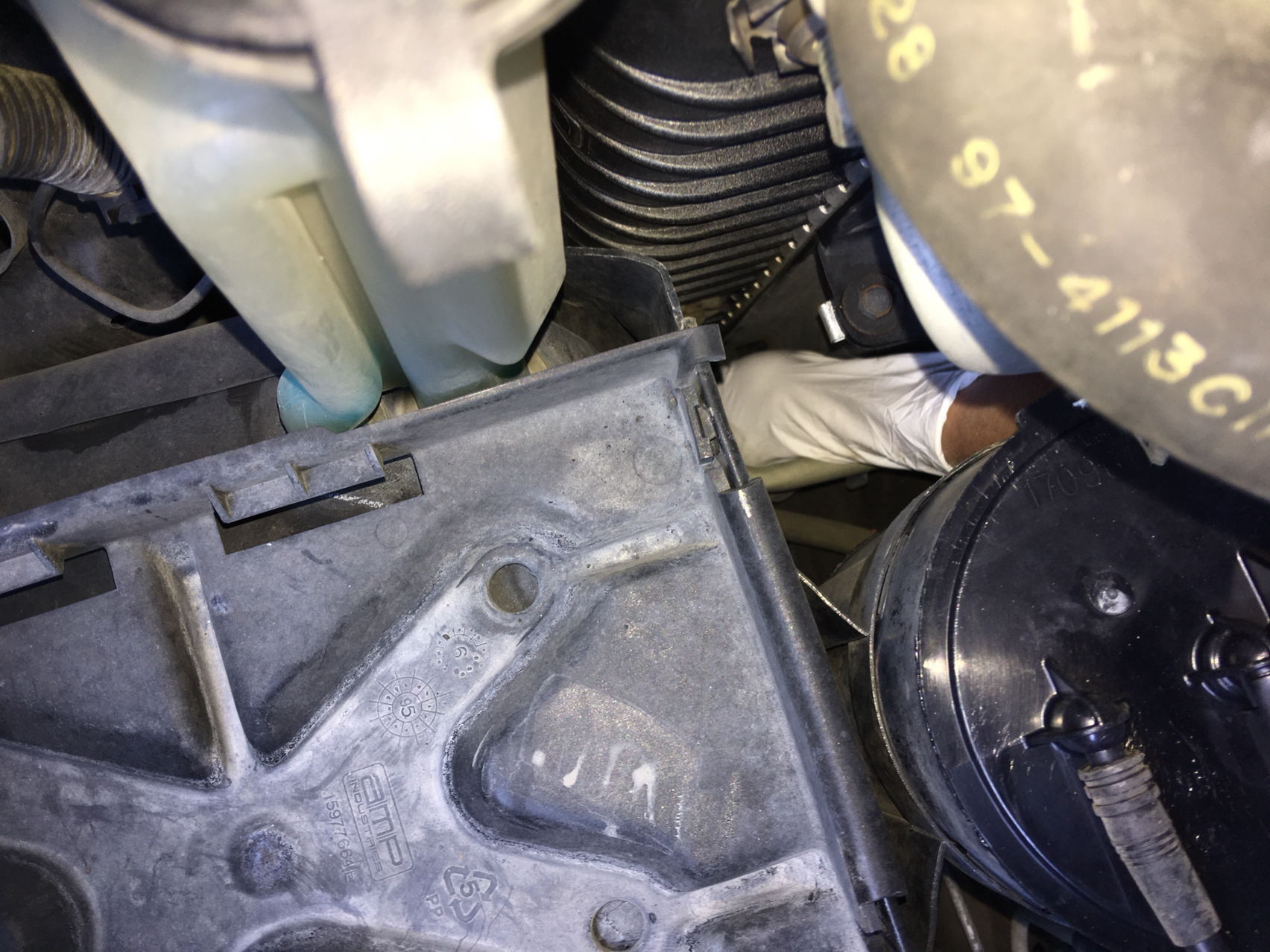

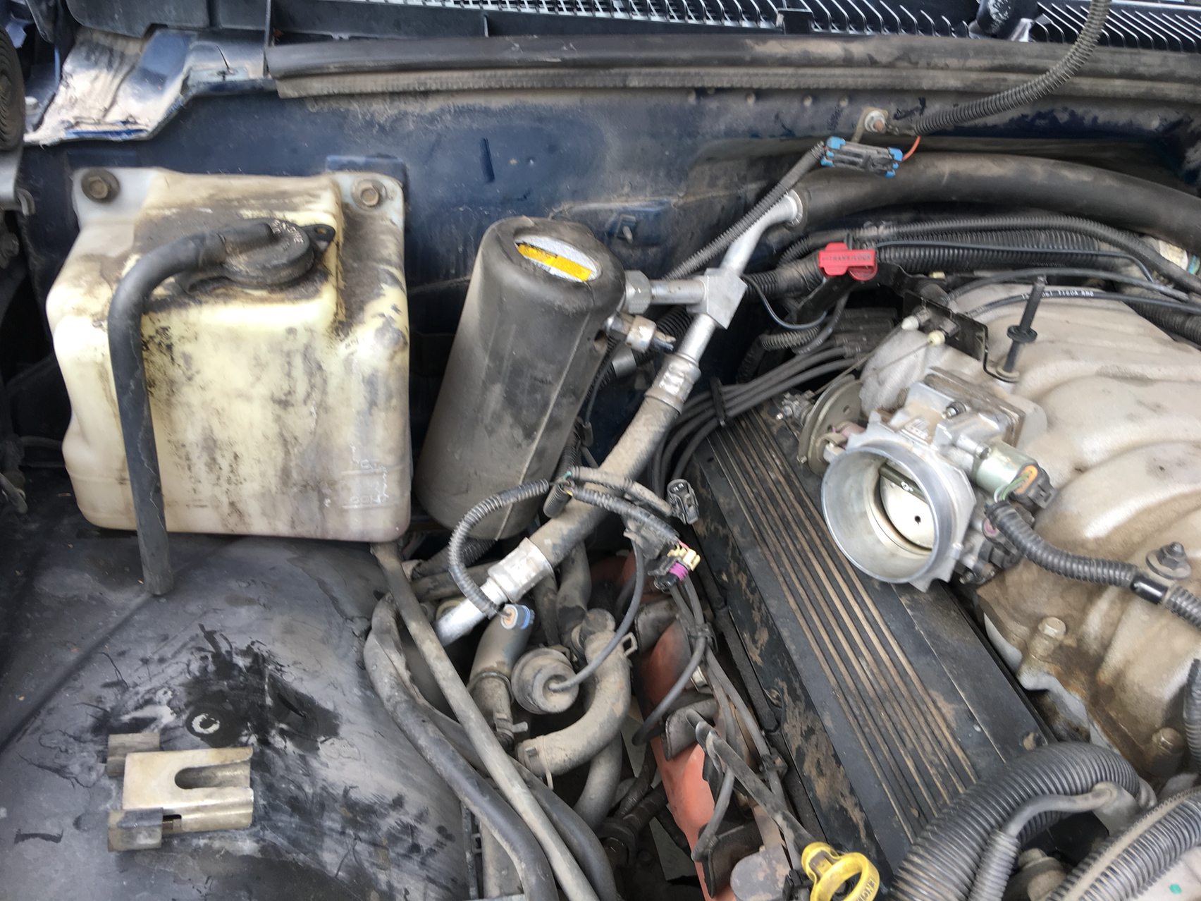

Let the journey begin. The main issue with this rig is no compression on #4. Looks like a coolant leak caused the issue.
I will document everything with pictures so I can revert to it when I get lost. Tricks and tips are welcome.
Engine bay before starting the surgery:
Engine air filter looks new so I saved it. Washed out the dust from the air box. 97 K2500 Suburban - Get or No-photo294.jpg
Mass air sensor removed and cleaned with CRC cleaner. Covered both ends with foil and washed the tubes. 97 K2500 Suburban - Get or No-photo419.jpg
Next is the throttle body. There are 3 nuts to remove but I can't figure out how to remove the cables yet. Looks like it's time for a break.
