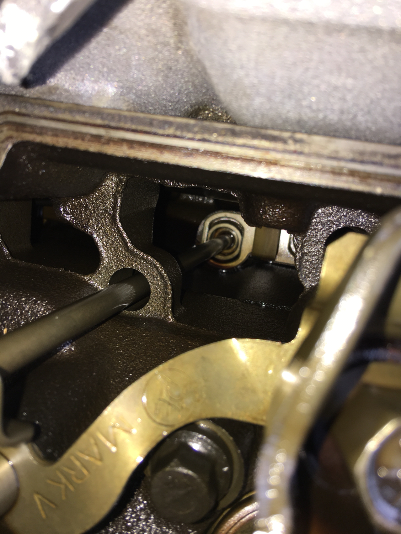

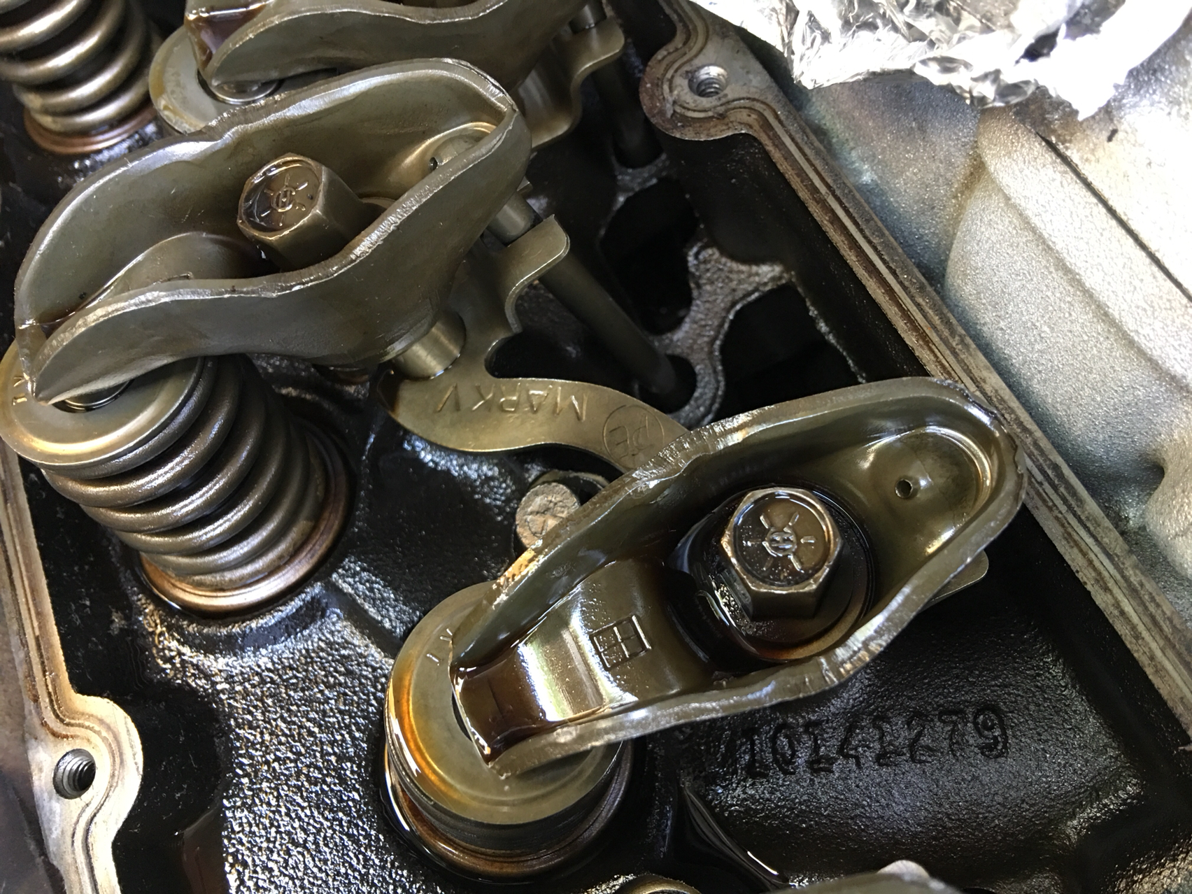

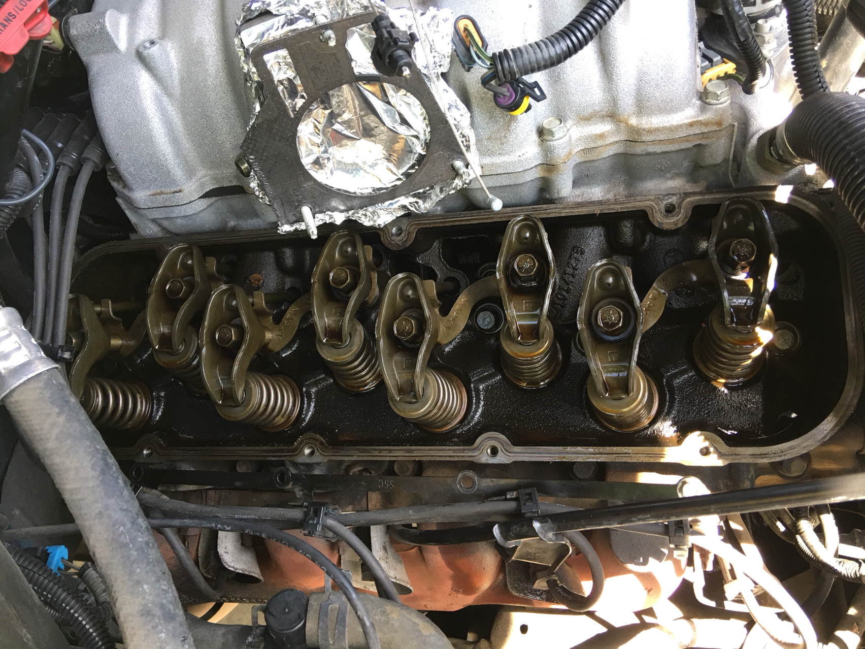

Decided to attack the issue with no compression on #4 as my top priority, I removed the passenger side head cover. 97 K2500 Suburban - Get or No-photo439.jpg
I can't see anything obviously wrong with it. Here are the closer looks at cylinder #4

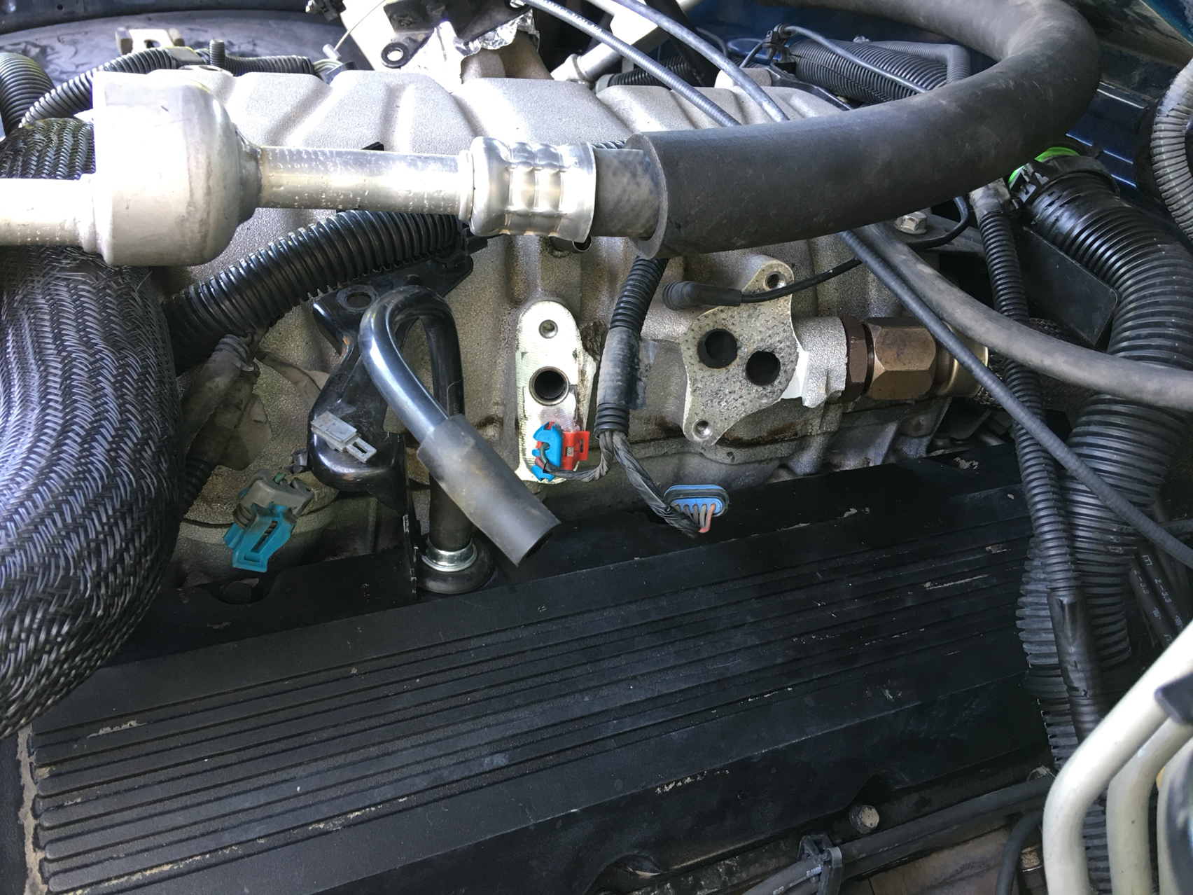

Looks like I will have to remove the intake manifold in order to remove the head. Moving to the driver side and I was able to disconnected everything relatively easy until I reached the EGR connection. I don't have anything of that size to loosen the nut. It's time to put things away and go shopping. 97 K2500 Suburban - Get or No-photo4.jpg

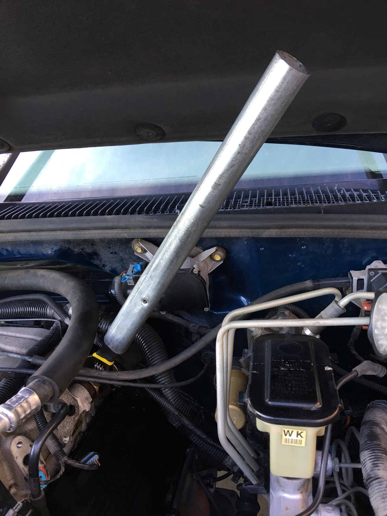

My trick for loosen EGR nut: 12" crescent wrench with DIY extension bar
My head keeps hitting the hood and it seems like the hood can't be raised vertical. Such feature would be nice for this job.

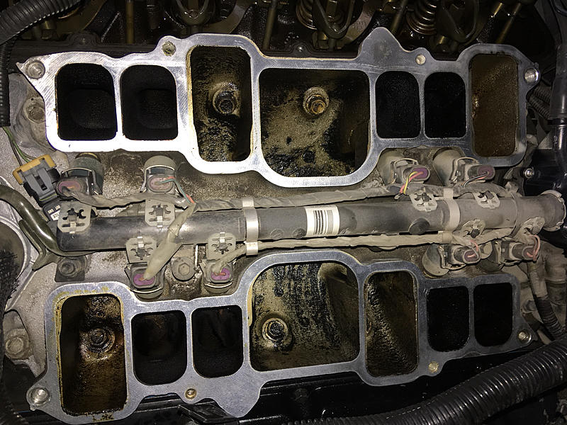

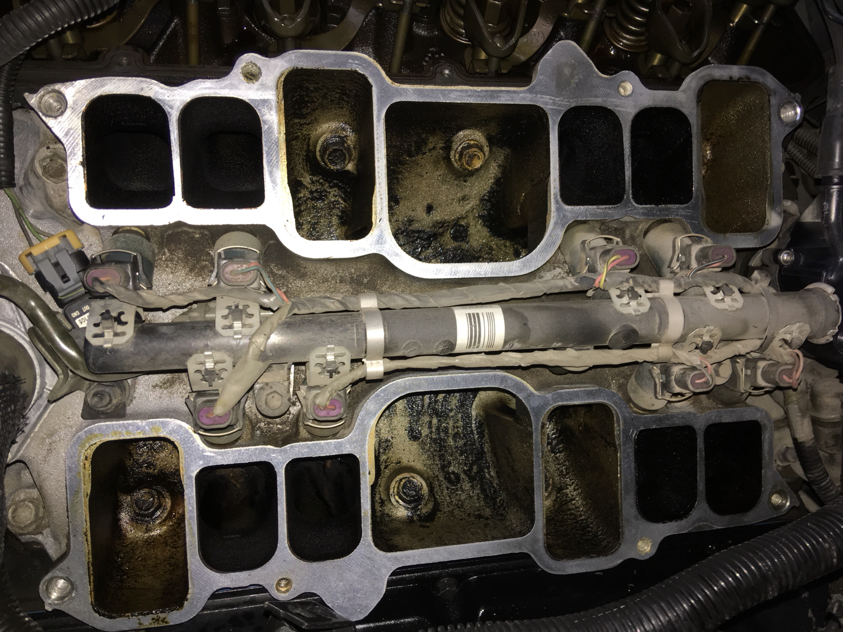

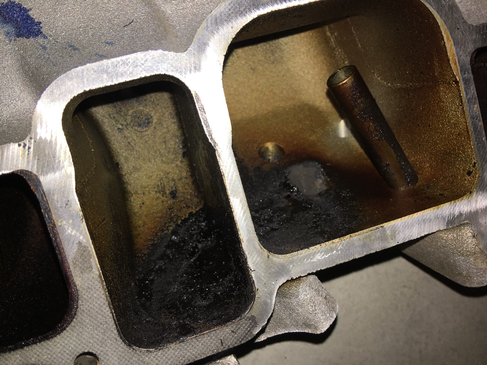

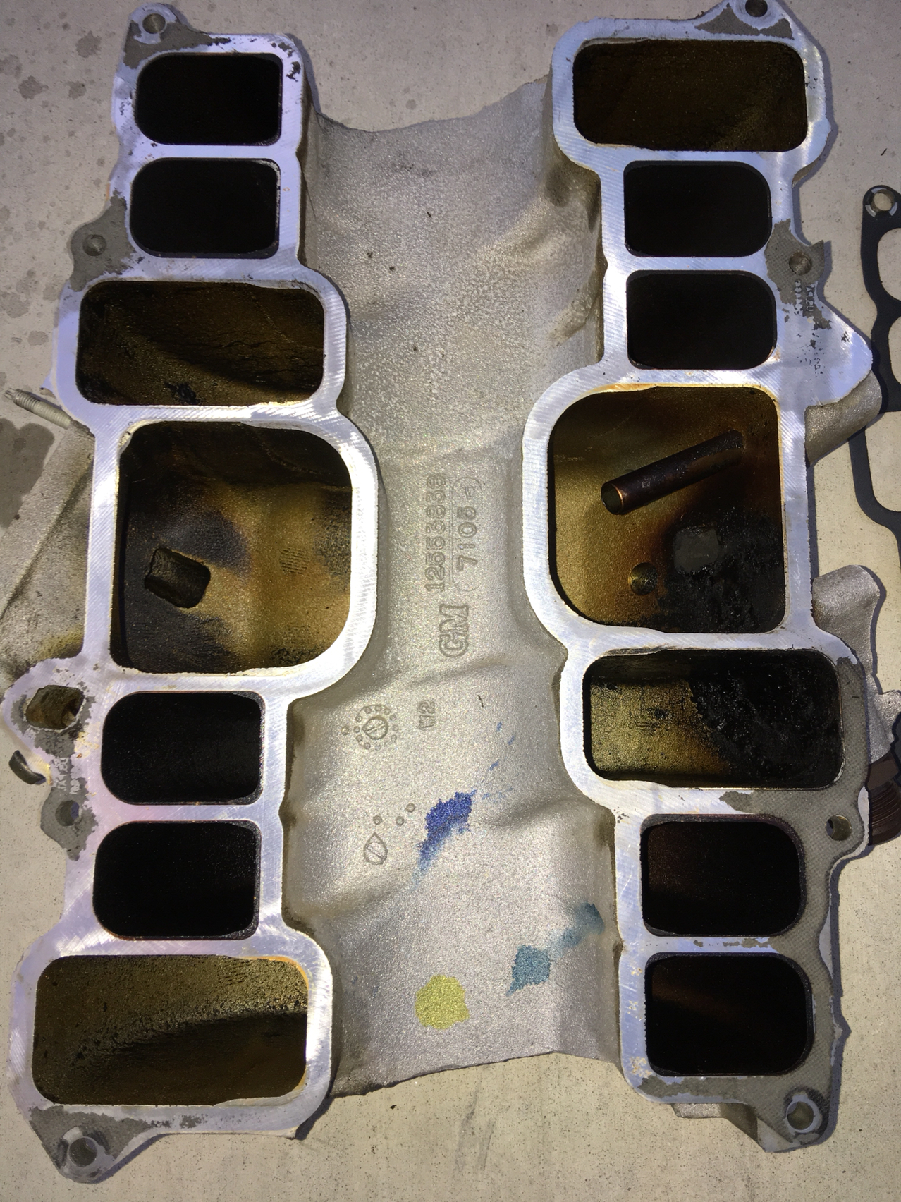

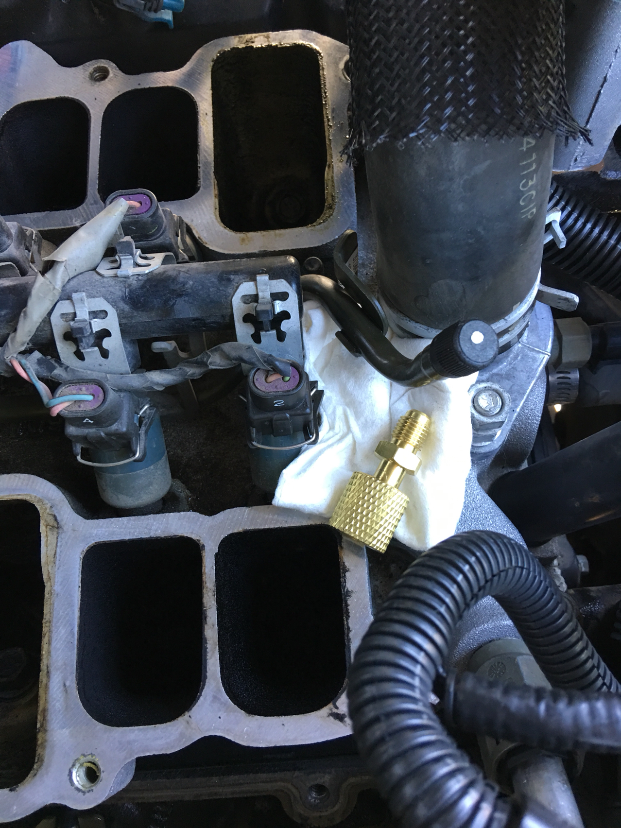

The upper intake manifold piece is out. Not sure if this looks normal for a 170k miles rig or not. Carbon build up and heavily deposited carbon on EGR chamber97 K2500 Suburban - Get or No-photo616.jpg

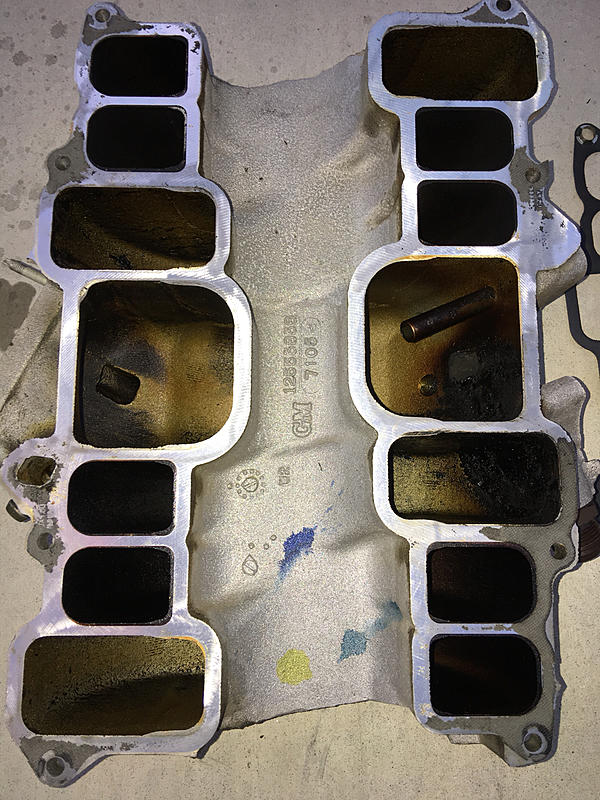

Here is intake manifold lower piece. Next two items to order are intake manifold gaskets GM 12559099 and GM 12559098.

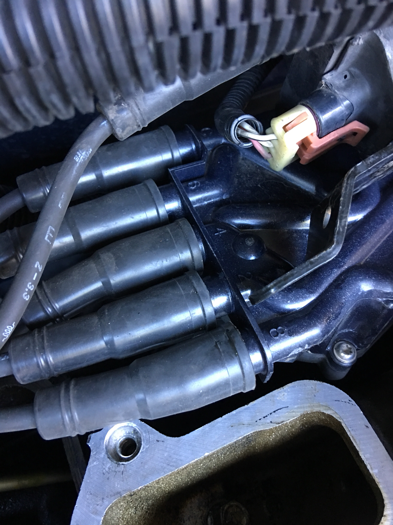

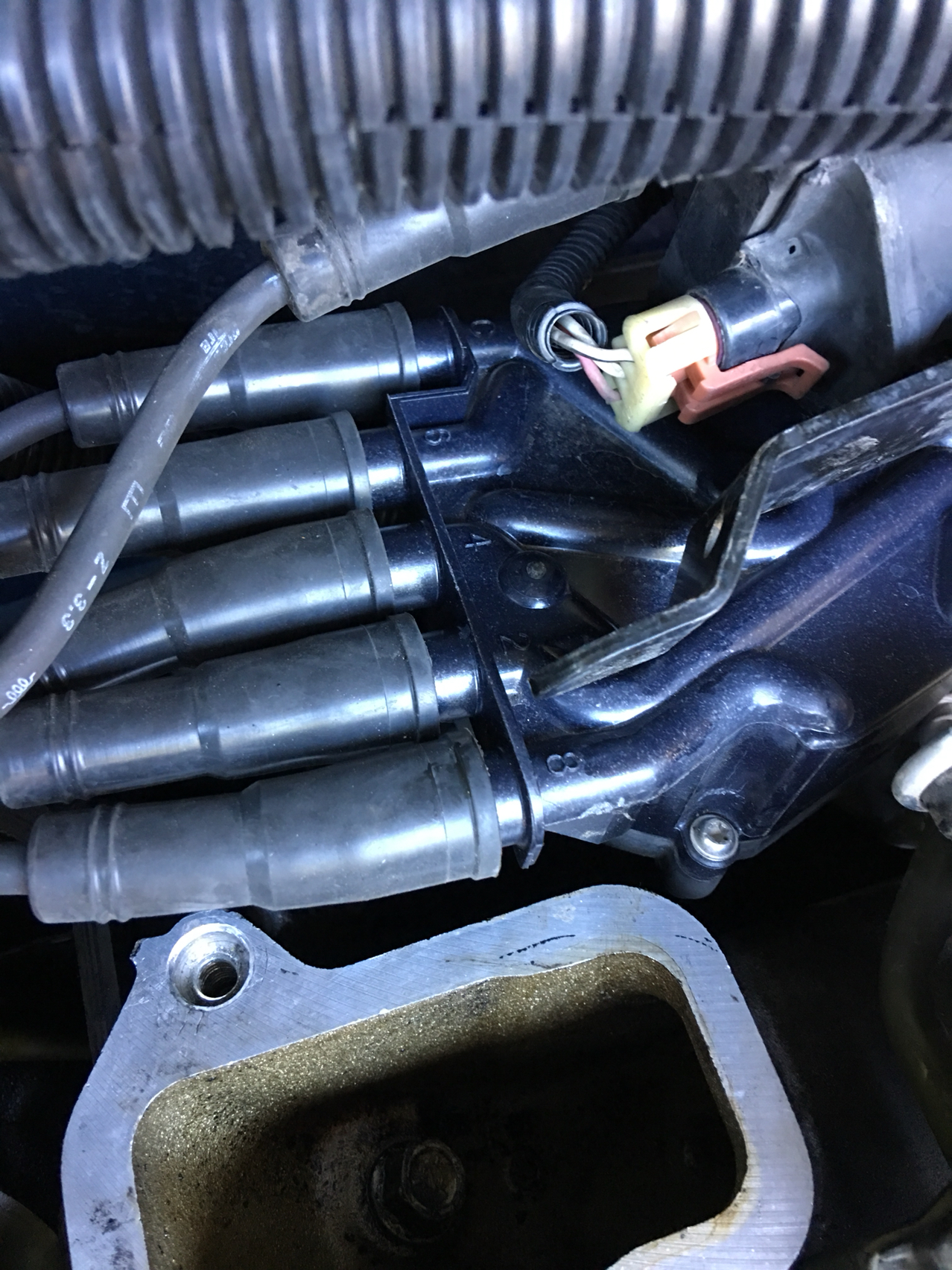

The #4 connection on the distributor looks suspicious 97 K2500 Suburban - Get or No-photo384.jpgSee how it wasn't pushed all the way in? Should connections be pushed in all the way to ensure contacts? Is it too late to stop or should I go all the way?97 K2500 Suburban - Get or No-photo837.jpg

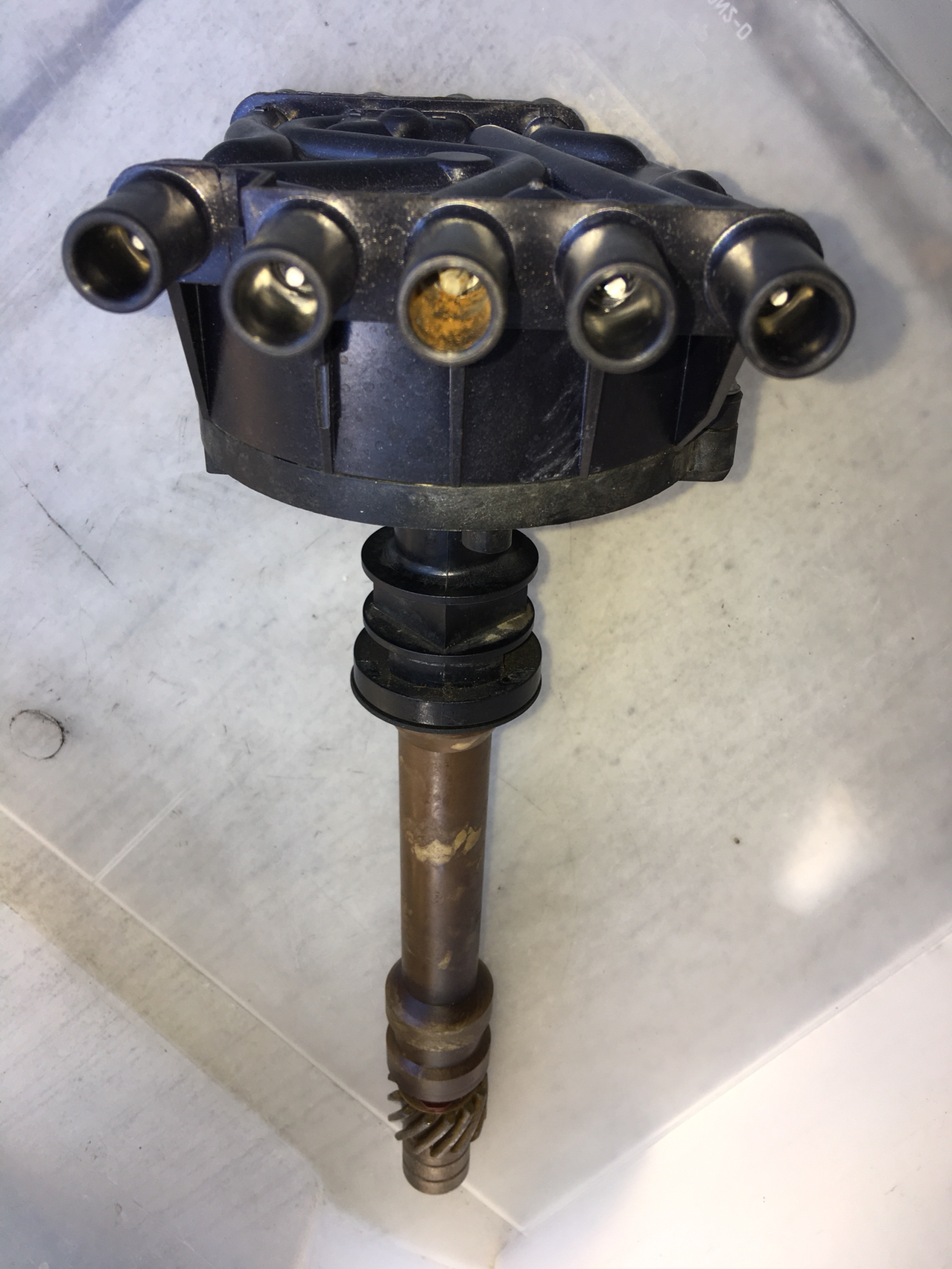

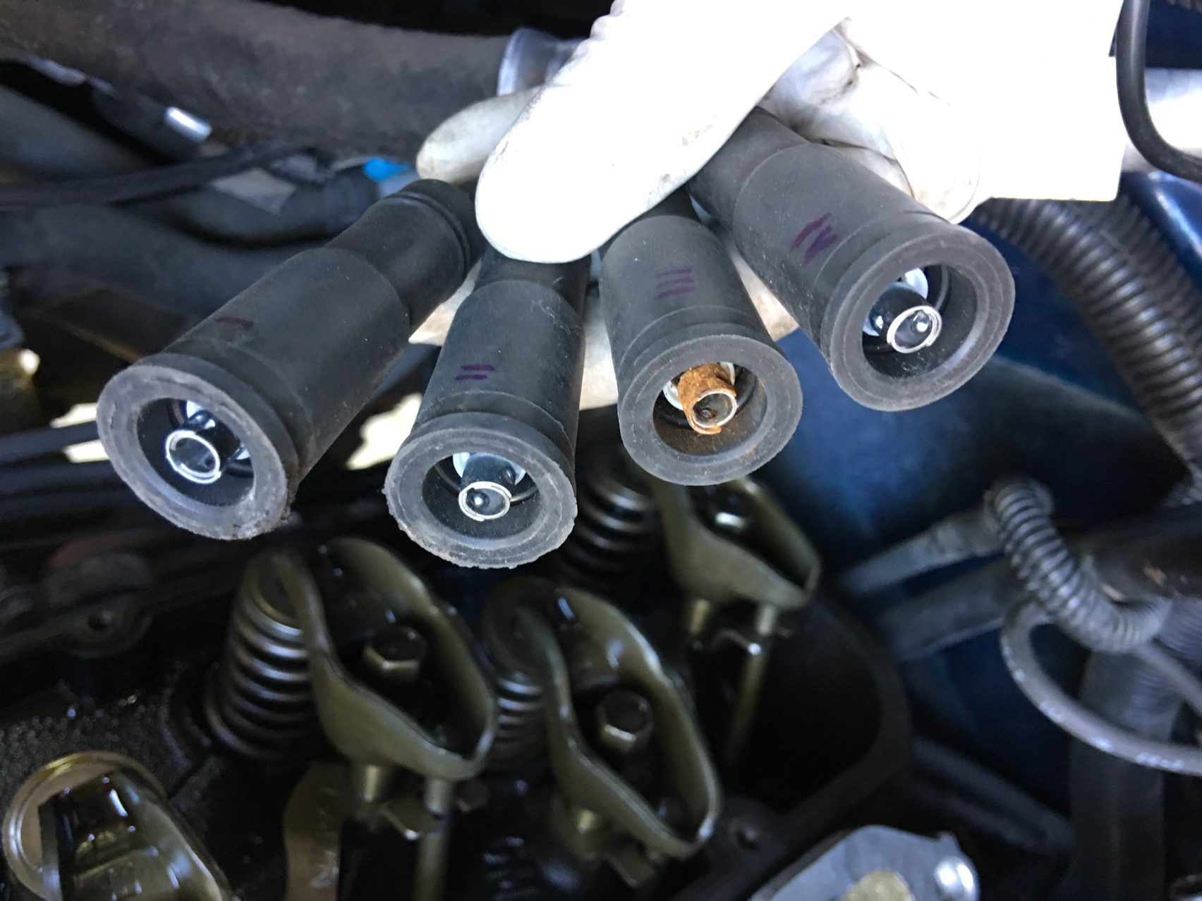

Removed the distributor and found corrosion on #4 connector 97 K2500 Suburban - Get or No-photo988.jpg
I think I am going to stop here waiting on the expert to tell me if it's worthiest to go all the way or not. Happy father day to all!

That could be your issue for sure. Not suggesting what you should do..I'm lazy. I might roll the dice and assume that this was the issue. It sure looks like a genuine issue.
Old Jun 18, 2017 | 10:26 PM
  #40
V12TT's Avatar
Joined: Mar 2017
Posts: 103
From: Snowville
Those corrosions are from the sparks right? The distributor and the wires were replaced last March 2017. And that mechanic is willing to pay $2000 for this rig where the book says it worths under $1000. Something is fishy about this whole thing.
