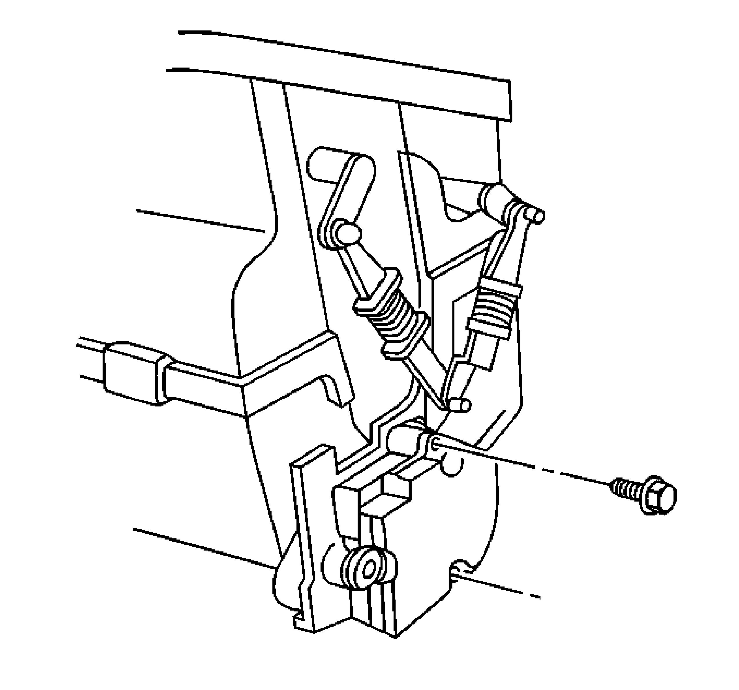

Front Fan only blows on to floor will not adjust to side vents, screen etc, all suggestions welcome please!
Old Feb 19, 2011 | 9:13 AM
Likes: 48
blend door is probably stuck or the actuator is not working....
You should be able to see the actuator under the dash, try having someone work it while you watch for motion

It was the actuator, cogs fine, motor appears lazy. Thanks.
Would anyone know where I might locate one in the UK, either whole unit (N16177412) or the motor itself please?
