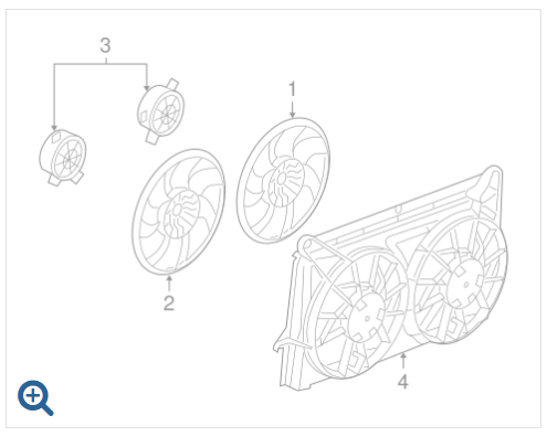

are you saying the vehicle uses a electric rad fan and not a clutch fan
Old Jun 24, 2017 | 5:39 AM
trottida's Avatar
Joined: Feb 2011
Posts: 12
From: Ontario, Canada
Yes, the 2005 Suburbans have two fans that run in tandem. Both are electronically controlled and no clutch. Here's what they look like....
