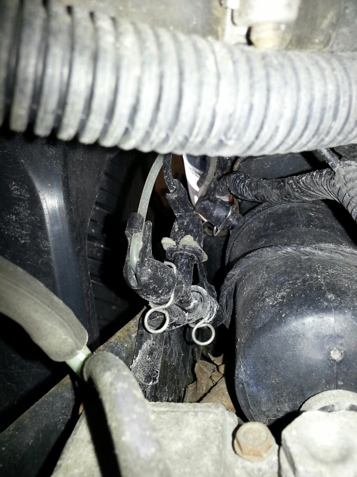

I was able to take a look at my compressor, but didn't see anything obvious. Replacing the air line going to the passenger side looks like it would be very challenging. Tough to get a good look at everything without taking the compressor off the car.
Attached Thumbnails Autoride - Air Leak - Tube Part Number?-20140223_123043_resized.jpg   Autoride - Air Leak - Tube Part Number?-20140223_123047_resized.jpg

Here's a better picture of the tee that connects all the high pressure lines.
Attached Thumbnails Autoride - Air Leak - Tube Part Number?-20140223_130209_resized.jpg
