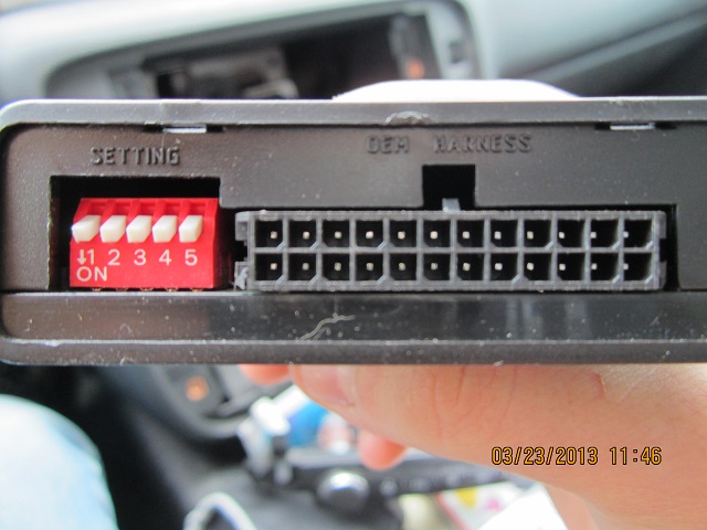

OK. As you will see in the pictures the unit is very basic, just the main connector and the 5 dip switches. Now in the back ground you can also see that everything is disconnected. I have had the radio, override, and battery un hooked for several hours now.
The LockPick has 5 switches, when i pulled it ALL 5 were DOWN, as in ON. so from what i can gather from their website, that means that all the over rides are disabled
So if that is true I have no idea how on earth the thing worked,
Thanks for any info,
Joe

Joe,
It is too bad that it doesn't have the usb. Mine does have the usb and I was hoping that it may help if you tried to update the firmware. If you can find a model number of it, you may be able to check the dip switch settings. Based upon the new unit, everything should be off. I guess you should be able to try it that way and see if it works. If all else fails, send an email to support@coastaletech.com and ask them for some guidance.

never mind its the stupid factory head unit. Right now i have the LockPick completely removed and its still doing it, but if i hit any button on the unit it gets out of the camera mode...
Idk what to do, I am NOT dropping $1500 on a new head unit.
