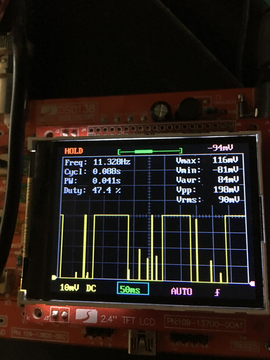

I have validated that my new MAF works using an oscilloscope, but I finally decided to pull the PCM tonight to access the camshaft and crankshaft sensor wires to needle probe them. First I tried the crank sensor and got perfect square waves starting at 0v and going to 5v and back to 0v. The frequency was not consistent, but it was probably the lack of a stable idle. Then I tested the camshaft sensor and got square waves that looked ok between engine vibrations and shakes, but as soon as the engine started another misfire episode, I saw the following on my oscilloscope.
These all look different because I changed the timing view for different perspectives.
To me, it looks like I have a noisy ground connection, so I'll probably go ahead and change the sensor and harness. It's only $75 or so for ACDelco brand. Anyone think I'm right or wrong? I'm still not too familiar with oscilloscope diagnostic tests. What stands out at me is the fact that the sensor is located in a known trouble spot on this vehicle where the water pours down off the windshield and the fact that these sensors tend to act up more when they're warm or hot.
