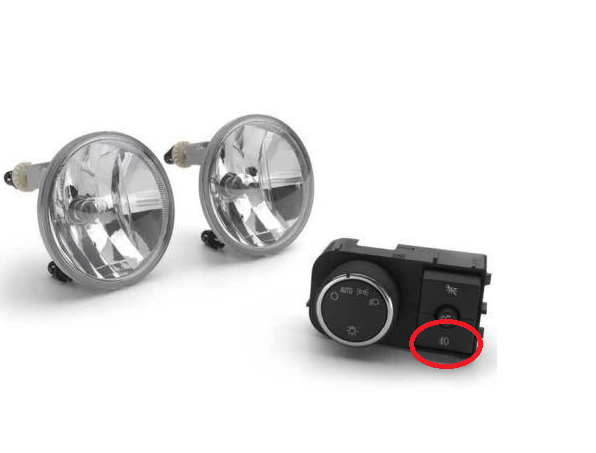

I just bought a used suburban ls 2011 with foglights already installed , and theres no foglight switch ????? Help plssss ?????

are you saying stock factory installed foglights?

The factory fog light switch is the lower half of the rectangle surrounding the dome light/gauge cluster dim ****. If it ain't there, then someone put in aftermarket and the switch can be anywhere.

As intheburbs stated , here is a picture
