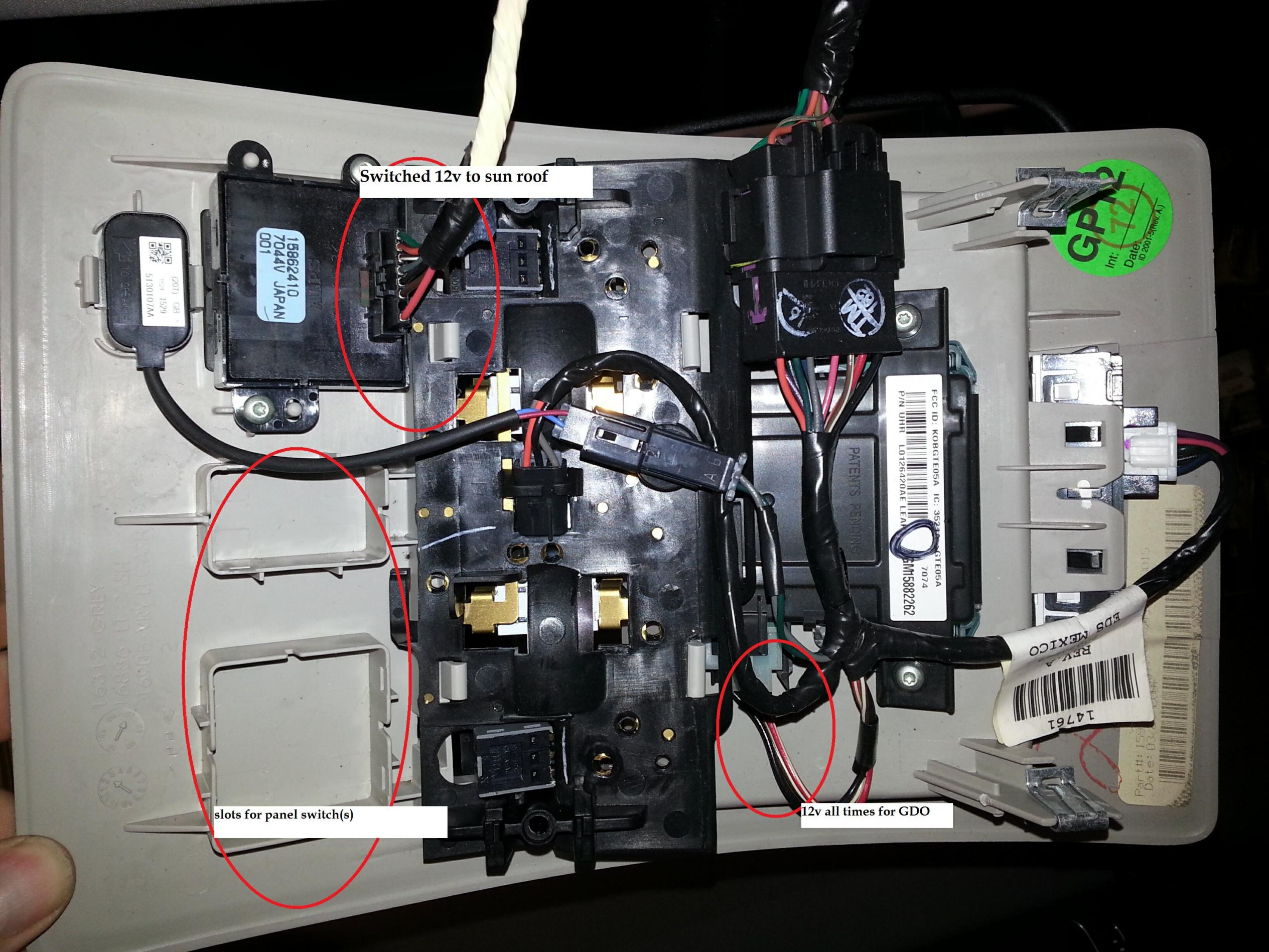

Yeah I just found in the manual that its 5v so I'll have to disassemble the 12v adapter to get it to fit in the overhead unless I can find enough room to tuck a 12v outlet in the headliner...
Old Aug 15, 2014 | 11:45 AM
  #13
Likes: 48

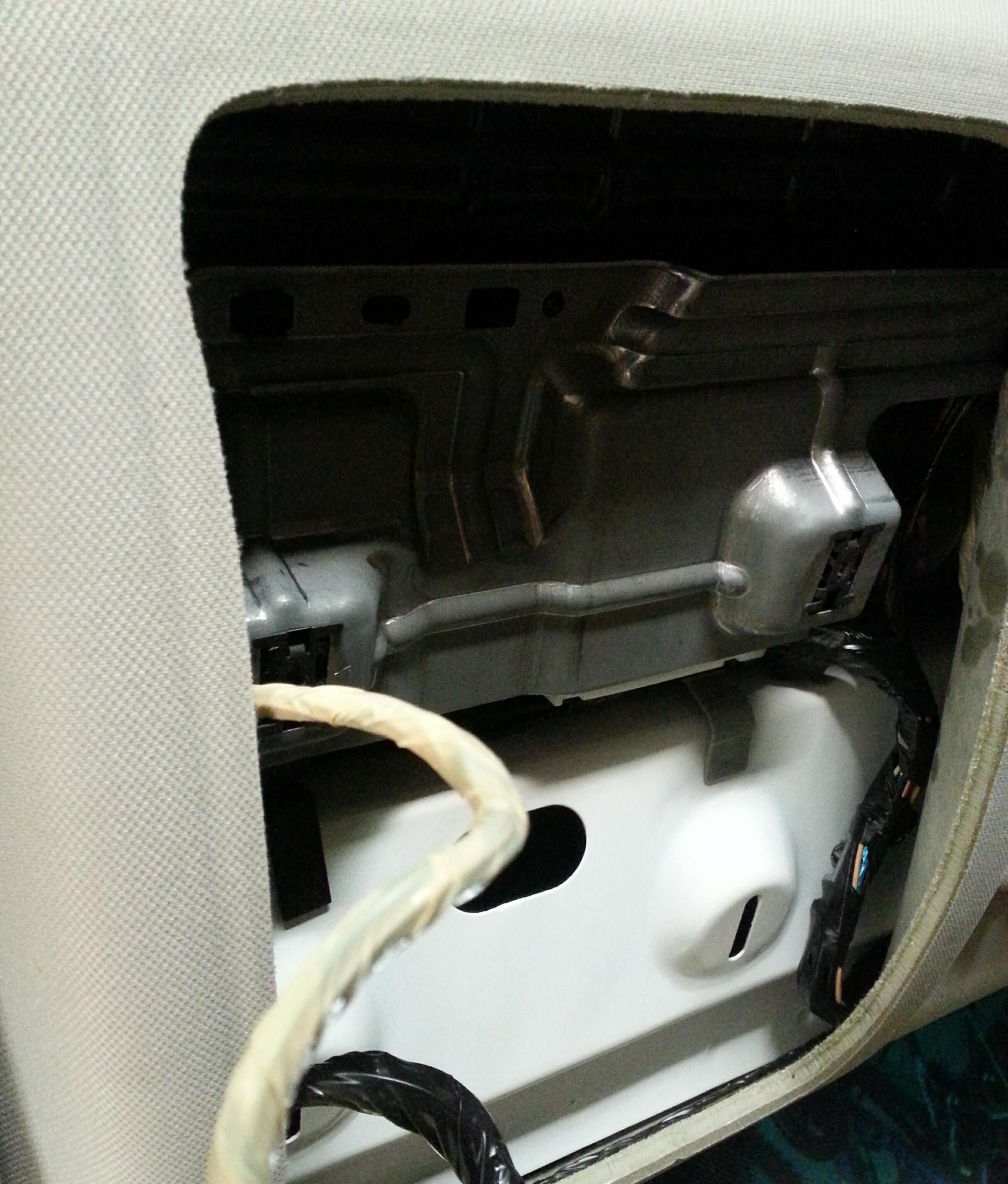

There is for sure power available both switched and un-switched as well as room to stuff cabling a convenient place to put a small panel switch if I so choose...

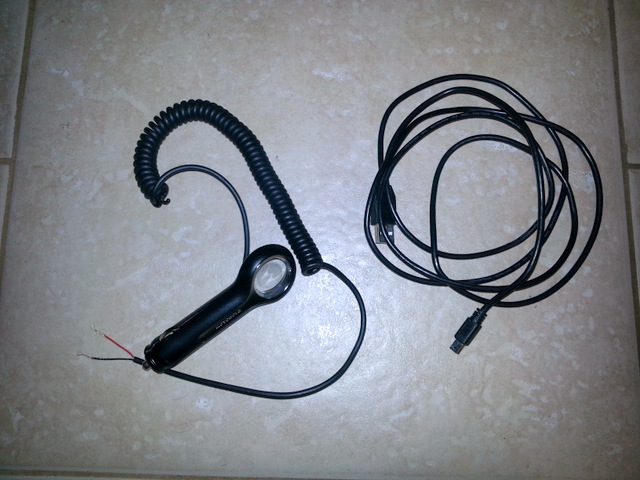

The power supply module is for the most part a standard 12v to 5v cigarette lighter phone charger.
What I ended up doing it taking another charger and butchering it down to its power supply and using the remaining case to encapsulate it to about the size of a lip stick tube and concealed the power supply within the headliner above the GDO and map lamps.
I ended up tying into the rear view mirror power as you suggest 73shark but did it within the head liner and I used the pink Ignition 1 wire so that when key is off the cam will auto power down and power on with key on..
Its now a very clean and concealed setup... I did purchase an extra mount and still have the original cigarette power cord that is about 6 feet long so I can move the dash cam to other vehicles if so desired...
