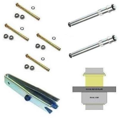

That loud embarrassing squeaking midway on your door closure is an indication that the door hinge roller pin has seen better days.There are two hinge pins on the top hinge. Careful inspection will indicate it is the roller itself is shot. The noise will continue until replaced. The roller pin is connected to the door camming behind the spring that keeps the door from slamming shut on its own. Google "door hinge roller pin". I have included a jpeg file of the hinge pins and door hinge roller pins for identification purposes only. The door hinge roller pins are in the top right corner of the jpeg. This should help to identify the problem, if you have the dealer or a repair shop do the work. If you are a do it yourselfer, YouTube has vids that will help through the hinge pin rebuild. The spring compression tool is needed in order to remove and reinstall the spring. Greasing, as indicated in earlier posts, is a very short term fix as it does not address the fact that the roller pin is beyond the benefit of lubrication and requires actual replacement. When I replaced mine, the roller was not even close to being parallel to the pin. If you have vertical movement or sagging on the door that no longer aligns (tough to close because of sagging), best to replace the hinge pins and bushings at the same time.
Attached Thumbnails Driver door clicking squeaking aquard to close-door-hinge-kit.jpg
