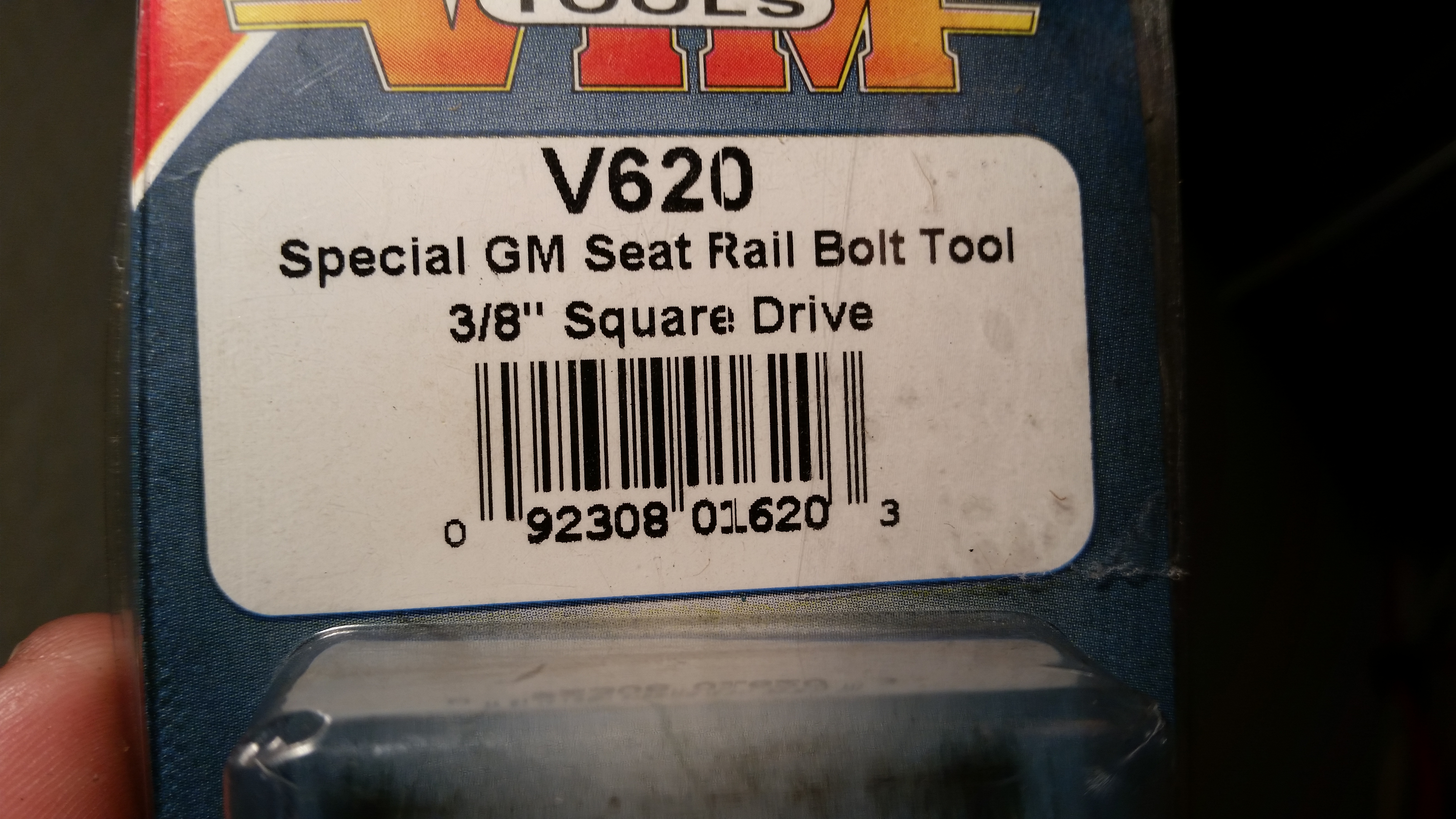

Anyway, it's not just a quick 3/4 in drive socket anymore, you have to have a GM specialty seat rail socket aka V620 socket to remove the front 2 specialty nuts and the nut holding the seatbelt to the seat itself to fully remove the seat from the vehicle.
*you might be able to use a Torx bit but it will have to be a deep well one to throat the floor pan bolt, mine would not work and you ain't gonna drill out the tool steel socket with your Dewalt... I tried.

V620 specialty socket for front rail nuts
