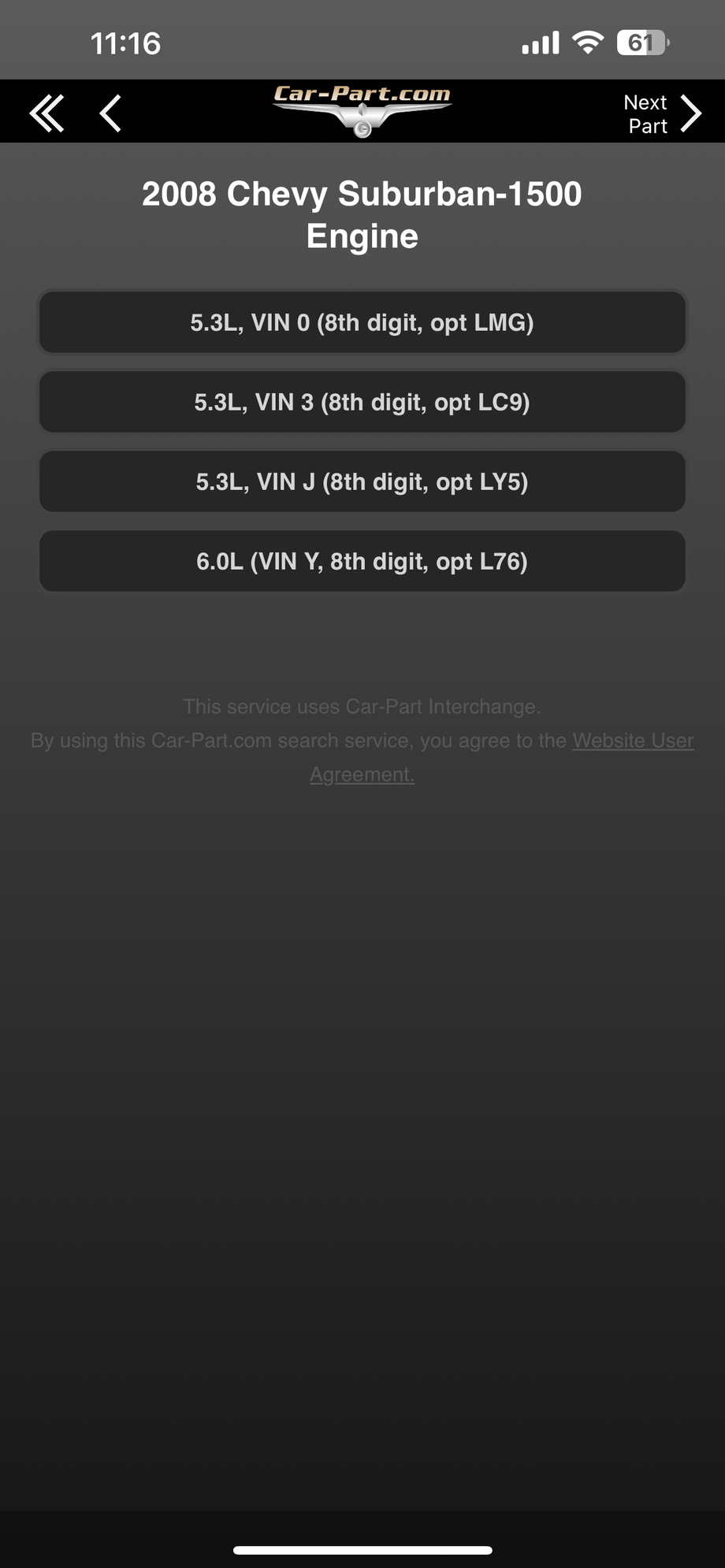

Hey all
I’m sourcing a motor and found a good low mileage engine. Question is,my 8th digit is 3 and the donor motor is a 0. what’s the difference with opt LMG and LC9? Would this be a plug and play swap?
any help please.
Old Nov 13, 2023 | 4:57 PM
According to wikipedia, LMG is a flex fuel engine.
FF engines require an alcohol sensor and a beefier pump.
https://en.wikipedia.org/wiki/Genera...ock_engine#LC9
The LMG is an iron block. LC9 is aluminum
https://www.onallcylinders.com/2018/...otec3-engines/
