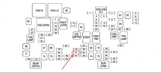

My first question is do you have a lock pick? If not, then skip ahead. However, if you do, that could very well be your problem. I can clarify on this if that is the case.
The fuse you should be looking at, I believe is fuse #41 located in the "under the hood" fuse block. That is the "Audio System" fuse. You can confirm this in your manual.
