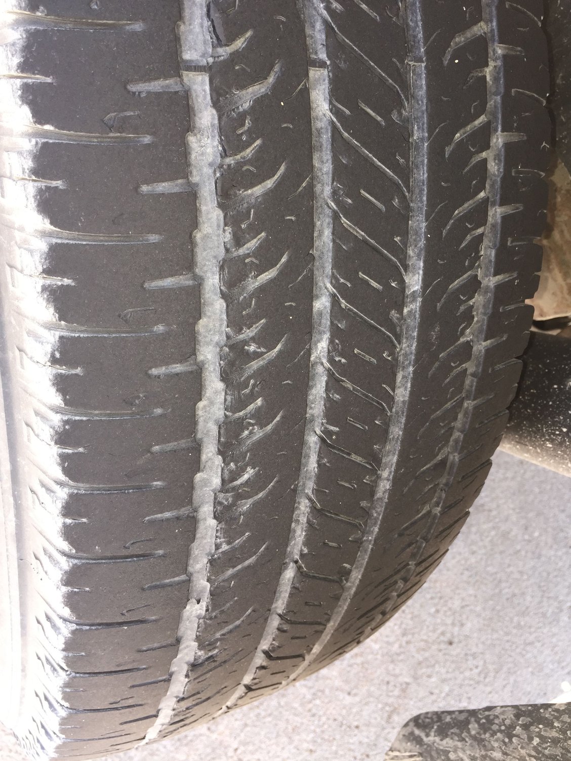

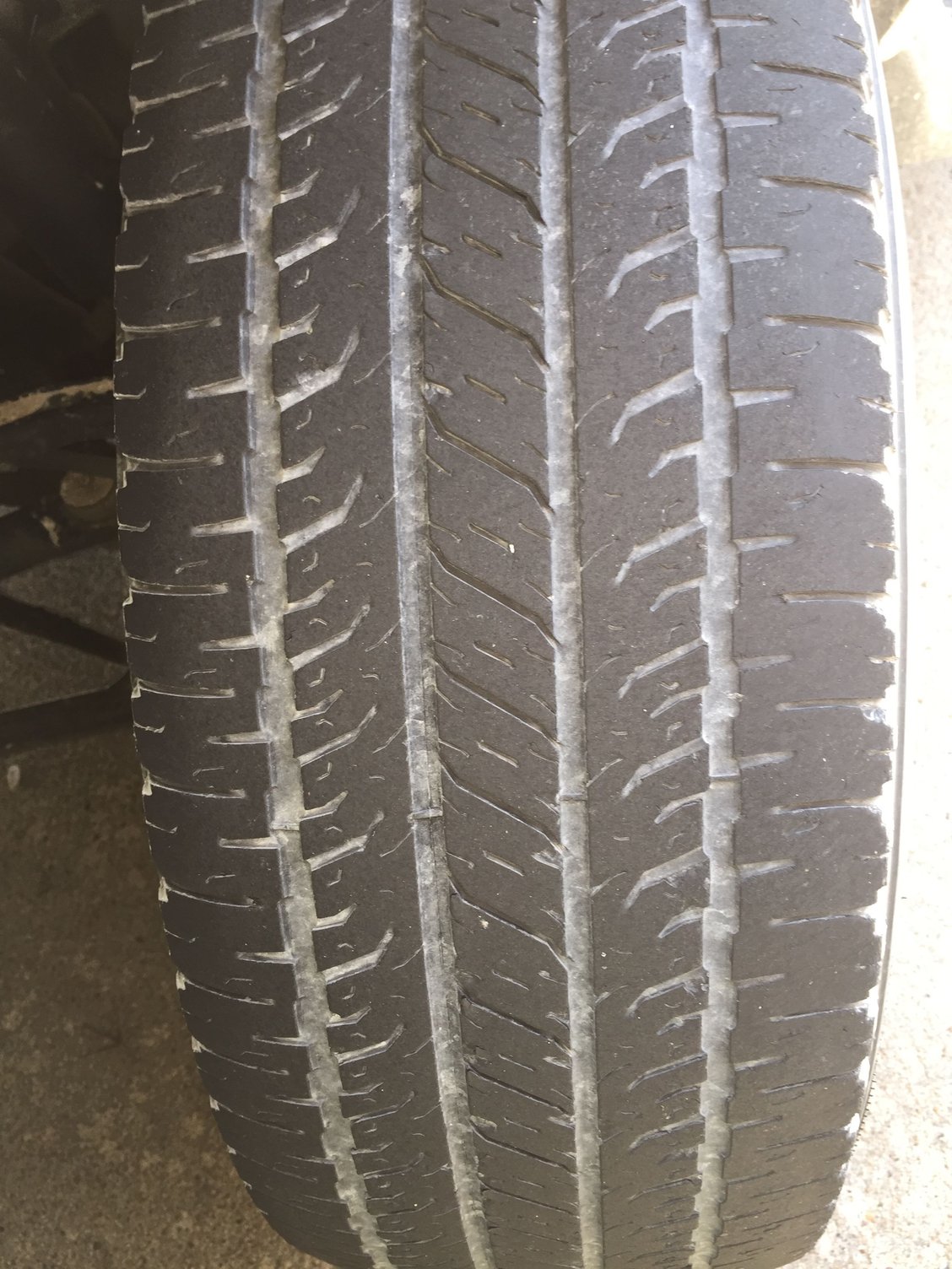

Any ideas or suggestions? Front and rear tire pictures attached.

-the images show no irregular tire wear pattern. the tire is worn evenly across the tire. are you rotating your tires?

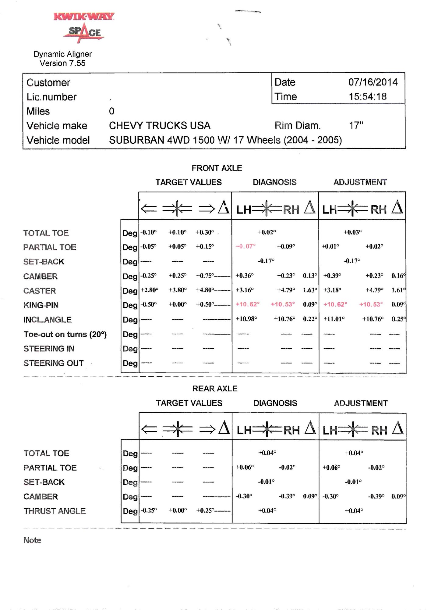

post the printout of the final alignment.

The pull to the right stopped after the last alignment on 7/16/15. I am attaching a copy of the alignment specs. Just before the 7/16/15 alignment, the dealership suggested I replace the tires which were in horrible shape. The alignment was done on brand new tires.

If the pull is gone after new tires and the alignment...the pull was from the tires as they only set the toe...which will not cause a pull.
the alignment has a large cross caster which should have been adjusted but was not. the caster readings indicate a pull right. Caster is not a tire wear angle. None of the current alignment setting will cause accelerated tire wear. the diagnostic angles do not indicate any bent parts are present.

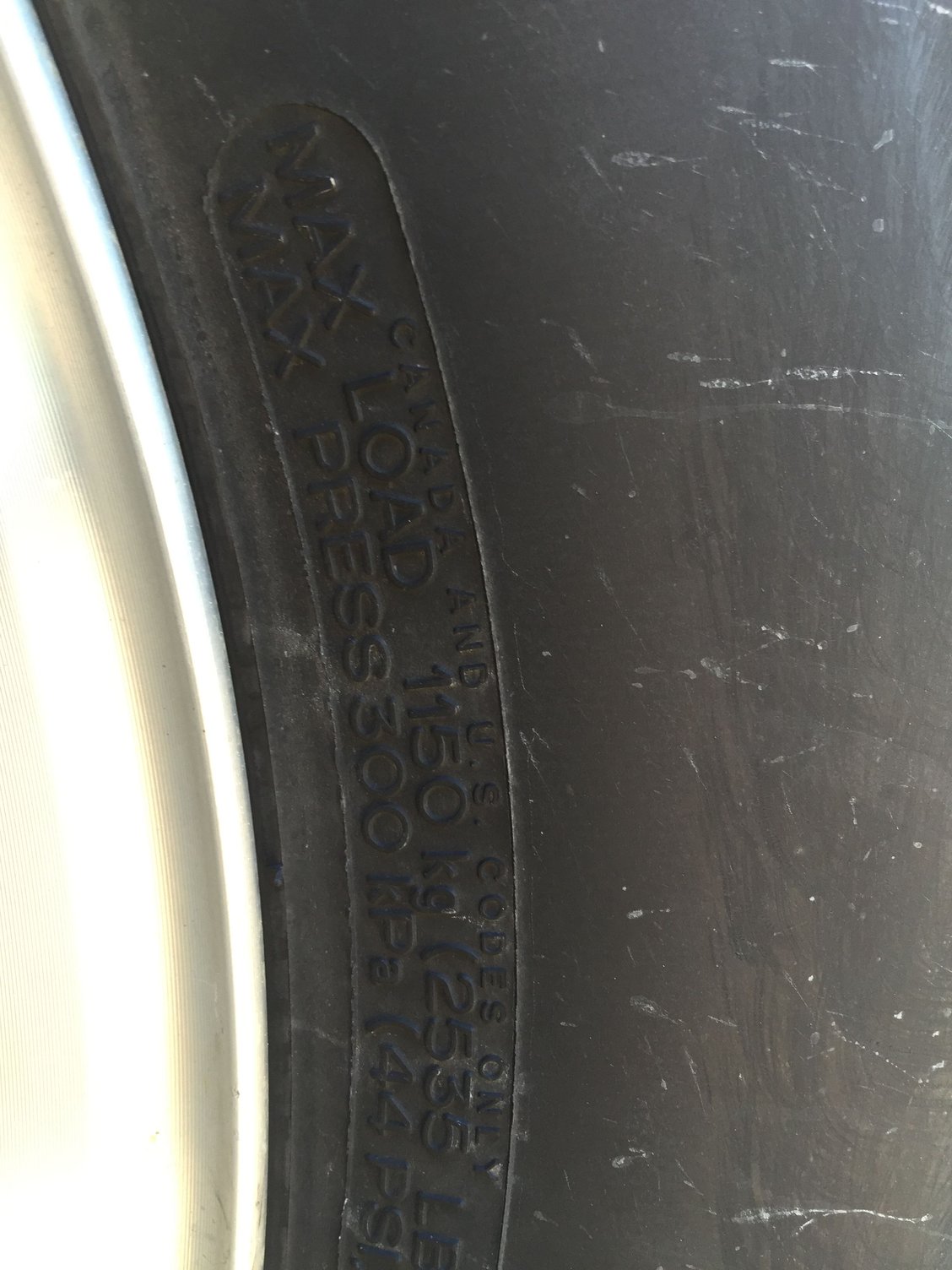

Is this vehicle used for towing? How heavily is it loaded? What load range tire is on the truck and what type of sub is it 2500, 1500, model year? do you have teenagers who drive this truck?

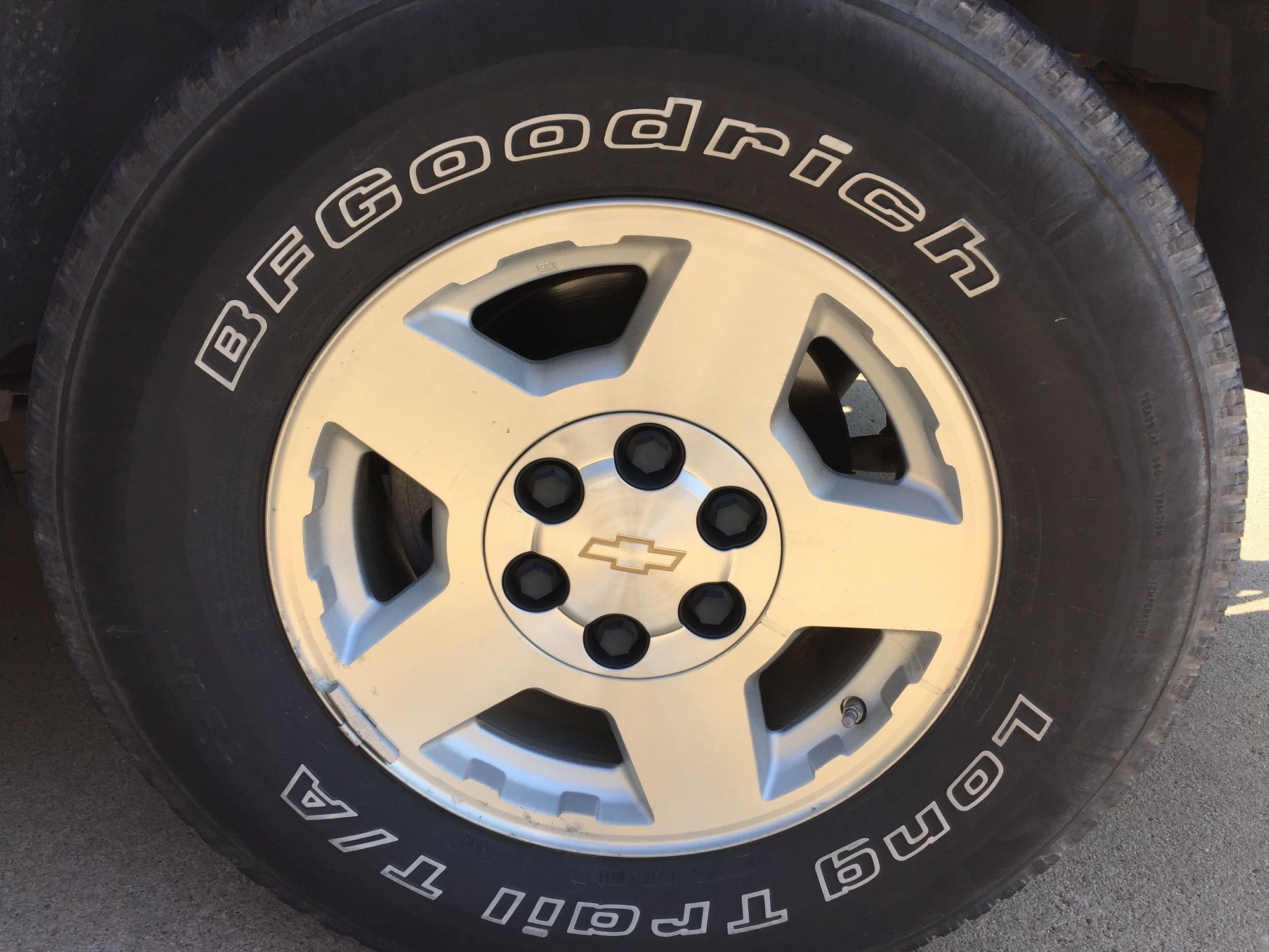

list the specific tire that you had on it and I will check its ratings.

LeftSeat's Avatar
Joined: Jun 2016

I googled the tires in question and came across several reviews; people reporting the same mileage as you and the tires were worn out. 30 000 - 35000 kilometers.
I love my goodyear wrangler duratrac...they are a load range E tire...so will $ more but so much better in the winter than the bfg. the long treads are a cheap tire.
