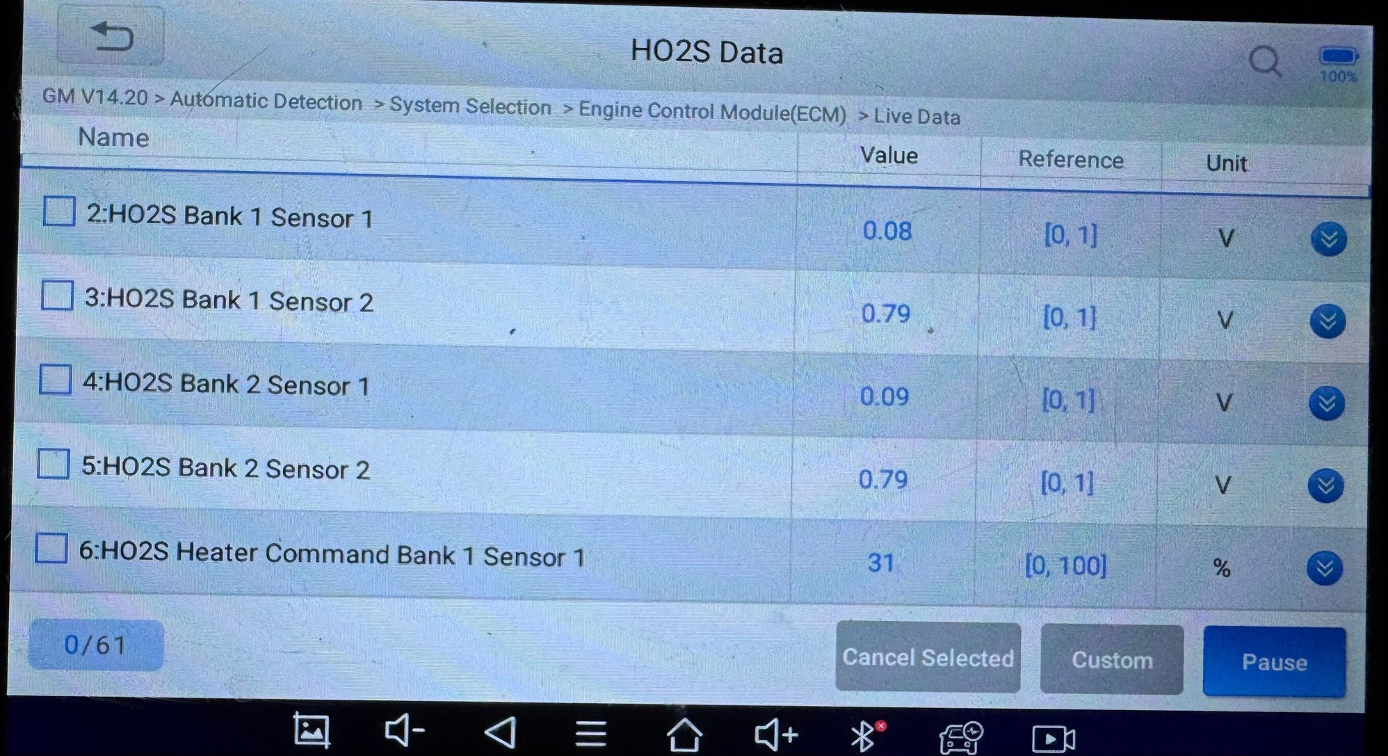

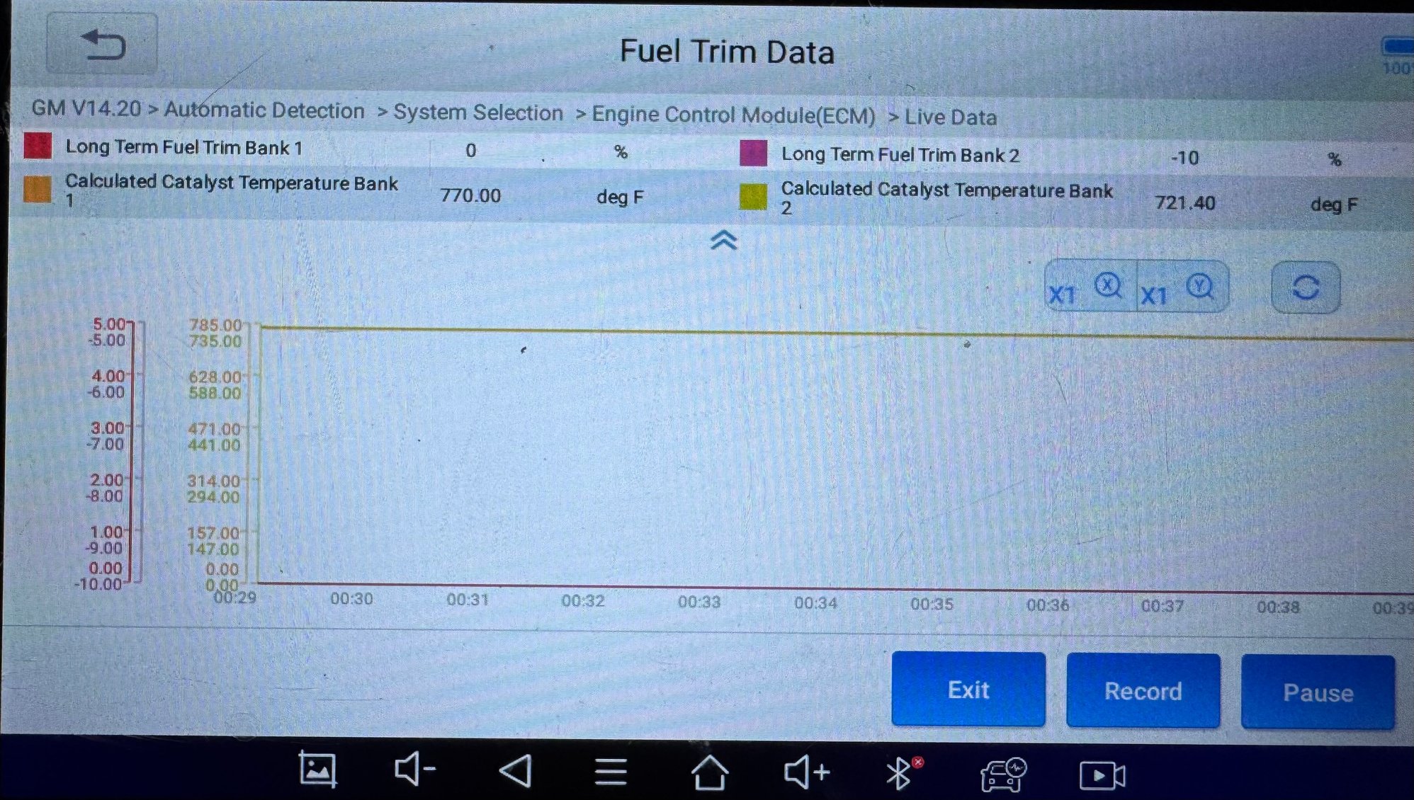

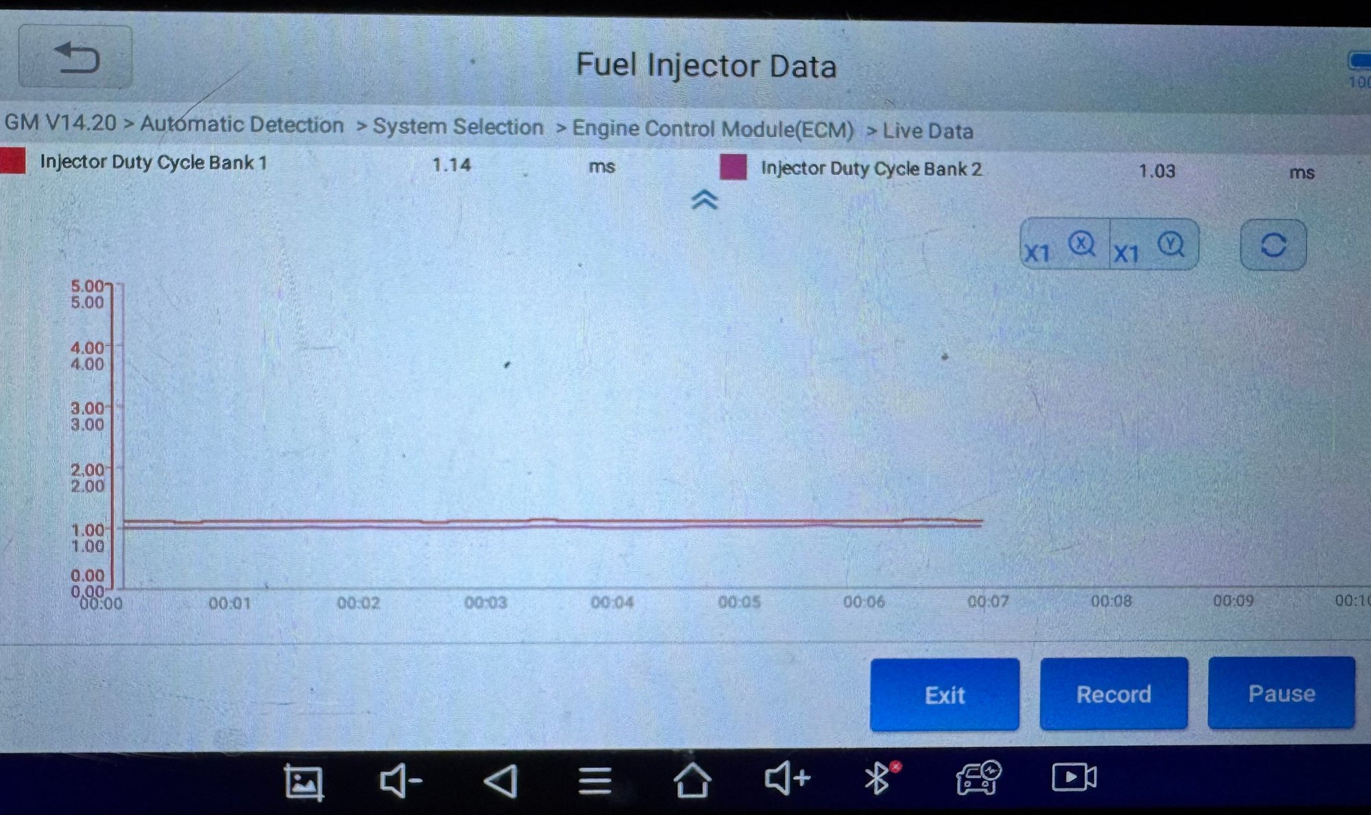

Having some fuel trim issues on bank 2. I don’t understand why the temps on the catalyst are so much lower on bank two. Is this indicative of a false reading ?

When were these readings taken? The engine needs to be at operating temperature and idling in park to accurately assess fuel trims and converter efficiency.
