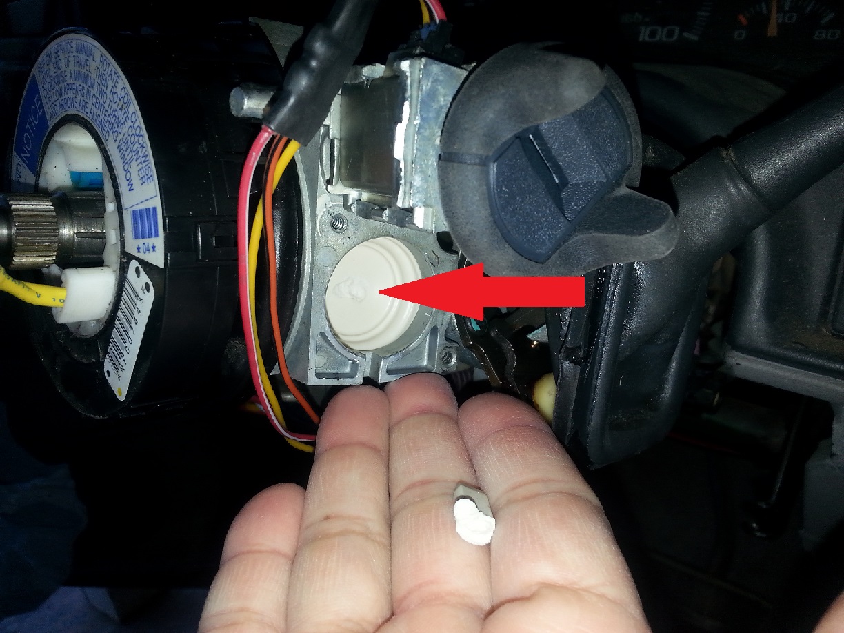

Thanks for the information! That's having to wait, however. The first picture shows part of the current problem and the second picture shows where that broken tab went. That happened while trying to remove the old ignition switch with those oddball screws, no proper tool, and almost no space to work in. Apparently the housing is sold without the actuators, so a new search is underway. I tried supergluing the tab back on, but this is some weird ceramic-like plastic that doesn't stick to superglue well at all.
Also, any system that would activate when the key is in the "On" position is nonexistent. I tried with the original lock cylinder, but with the actuator being broken it's really difficult.
