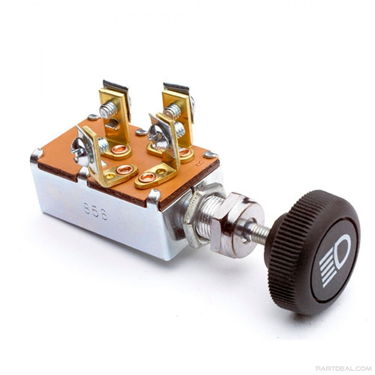

Old Jul 14, 2019 | 9:41 AM
captnjak's Avatar
Joined: Nov 2013
Posts: 16
What does that mean? Is that a replacement switch? It's not the type I have.

Old Jul 15, 2019 | 1:30 AM
oilcanhenry's Avatar
Posts: 4,605
Likes: 269
From: USA
It was both meant to be real and a bit of a joke. I was born in a time when such automation in vehicles was not commonplace. The unit you see, is a separate headlight and tail/front light unit that was intended for manual use only with no automation at all. You pull it all the way out for headlights/and warning lights and half-way for tail and front signal/yellow lights only, rear tail lights only.
If my headlights fail I will convert them to such a unit but they are manual now. I run every vehicle I drive, be that an M/C, light duty vehicle or semi-truck at all times lights on. That said, you likely have an issue with a relay or the device or unit that senses daylight. You may even have an issue with the ECM. I would install this unit rather then the ECM, should my vehicles cause any similar issues.
I do not need a vehicle that runs everything through the ECM, and will keep my 1998 K-1500 running until I die. Its designed to be simple, which I like. There are no power windows or mirrors and no cruse control and no power locks. The transfer case is manual only with direct input from the floor mounted shifter only. I have no need for the front axle being nothing but solid with manual locking hubs, but it came with the suspension it did and no changing that at all. It would be too expensive for that to happen.
Old Jul 15, 2019 | 9:55 AM
captnjak's Avatar
Joined: Nov 2013
Posts: 16
Manual switch over rides daylight sensor day or night. Since I don't really know how that is wired I can't say it's not the problem.
I agree that bypassing the existing wiring may be an option on this vehicle.
