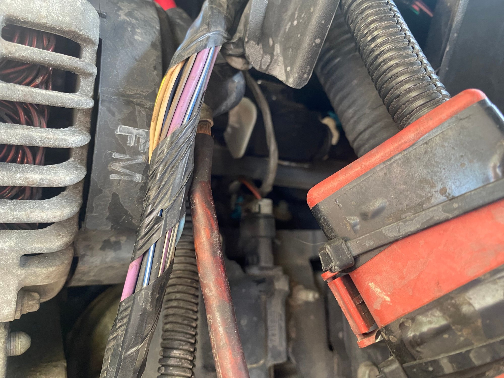

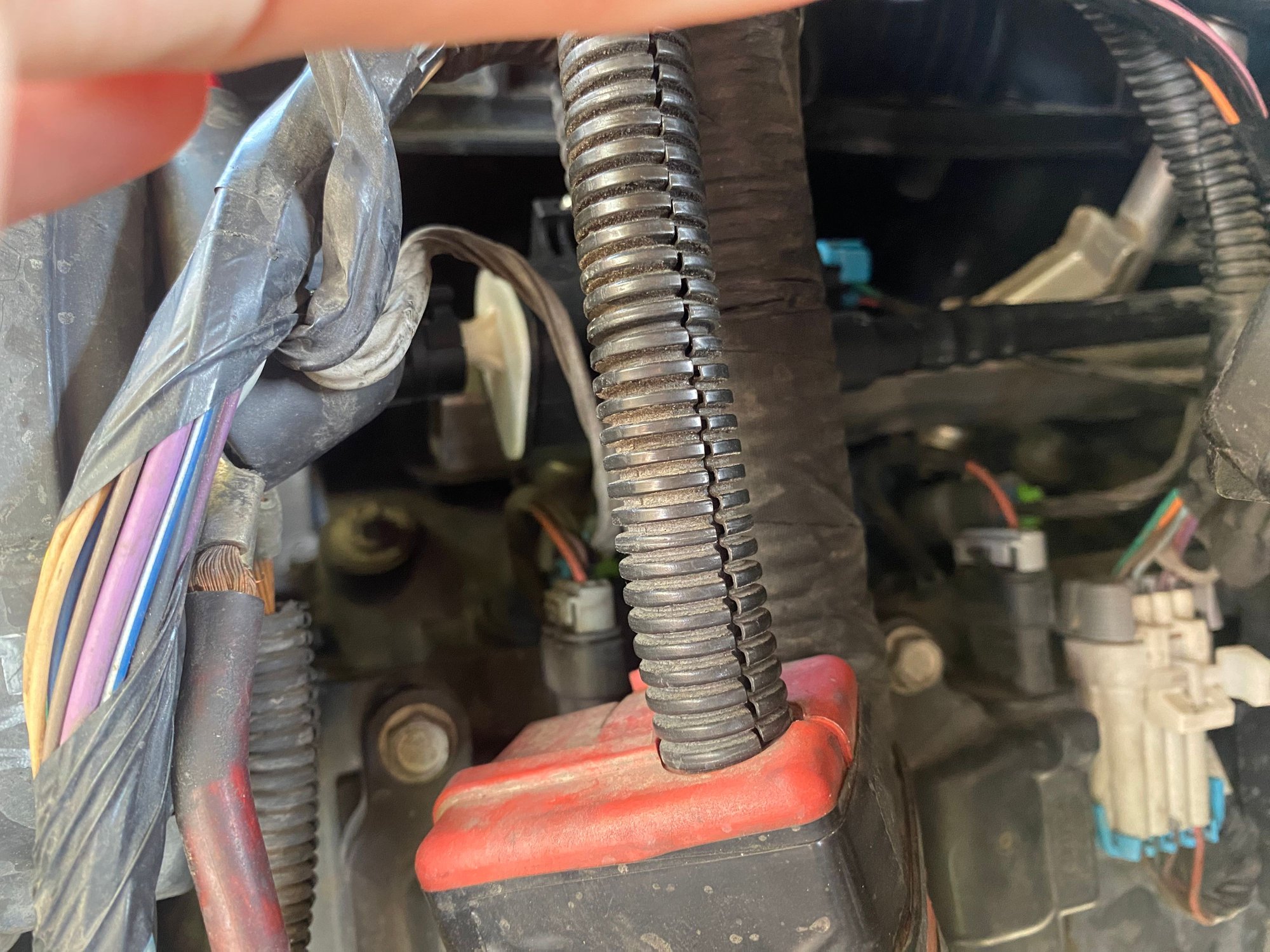

Originally Posted by tech2
post a pic of the engine bay showing the purge solenoid
Old Mar 7, 2023 | 1:31 PM
  #13
one tube on the purge leads to the rear of the vehicle and connects to the charcoal cannister. the other tube connects to a vacuum port near the throttle body.
disconnect the line at the purge solenoid that goes the back. With the engine running and the electrical connector unplugged...you should feel no vacuum from the purge.
with the back line disconnected...refuel....if it is still a hard start its not the purge causing the problem.

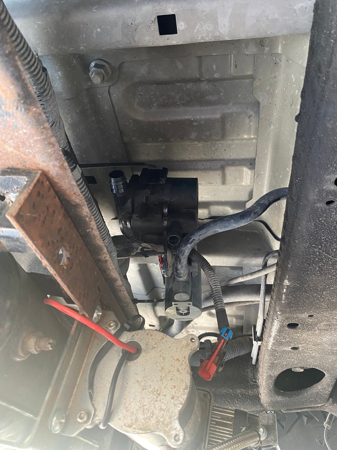

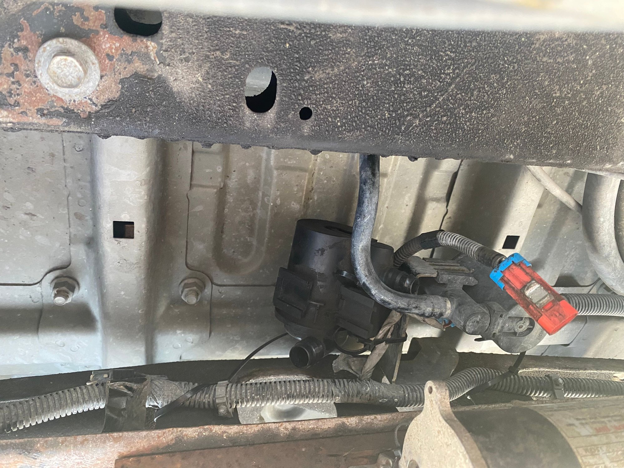

Looking around underneath and found this.
Old Mar 7, 2023 | 10:07 PM
  #15
been a while since i worked for gm so...one is the vent solenoid...the other one I'm not sure... maybe a evap fresh air filter????...
way it should be set up...
fresh air filter to vent solenoid to cannister....one line off cannister to purge solenoid and one large line off cannister to tank.
