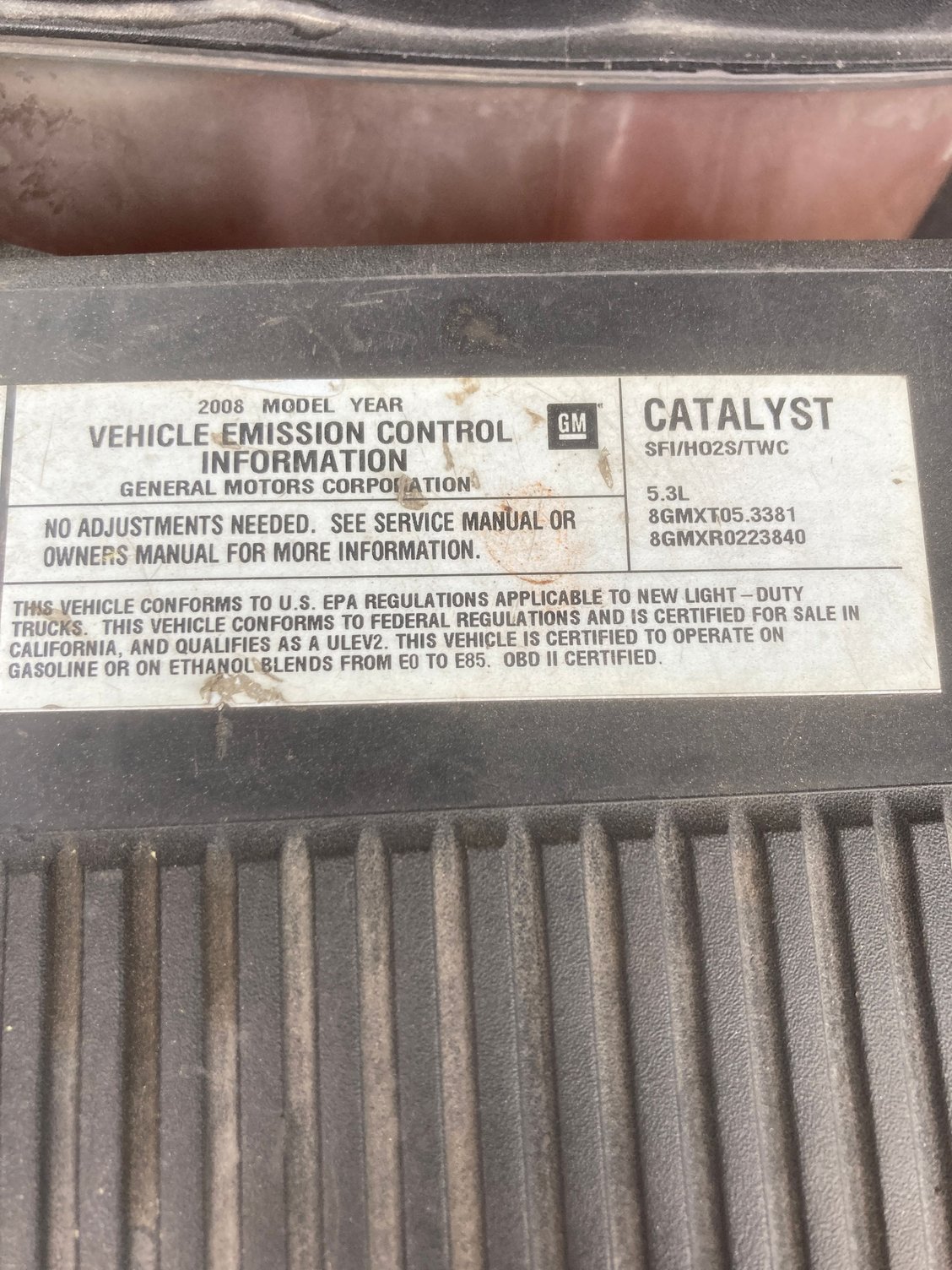

Check the underhood label. If it has CA (California) emissions then federal cats will code out low efficiency after a while. My brother went through that when he had a shop replace the cats on his Impala.
Just because you may not be in CA doesn't mean you don't have a CA emissions vehicle. A lot of states require CA emissions on vehicles sold in that state, NJ and NY do just for an example.
