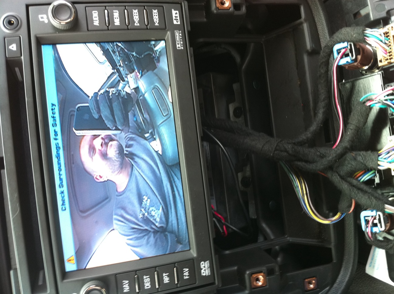

OK...the new nav unit is here, but it is theftlocked. good news is that my door dings, parking sensor dings, and turn signals work with this model (GM 25846421)!!!! I tested out the camera (Kenwood CMOS 200) on the old unit and it works as described above.
I will be getting the new nav unit programmed tomorrow and following up one final time with photos.

NEW NAV RADIO WORKS PERFECTLY (GM 25846421) door dings, signals and all!!!!! pics to follow...
