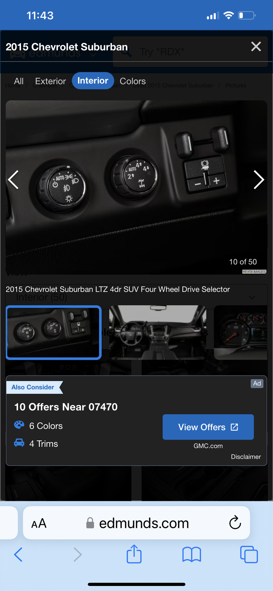

Thanks, Jason. Any easy way to spot that it's a 2-speed transfer case? I'm new to the Suburban/Tahoes. I expect that the integrated trailer brake is probably enough of an indicator in the end.

It would have the 4 high 4 low **** like the attached picture. Note the brake controller as well.

Awesome, thank you. Highly appreciate your quick reply too!
