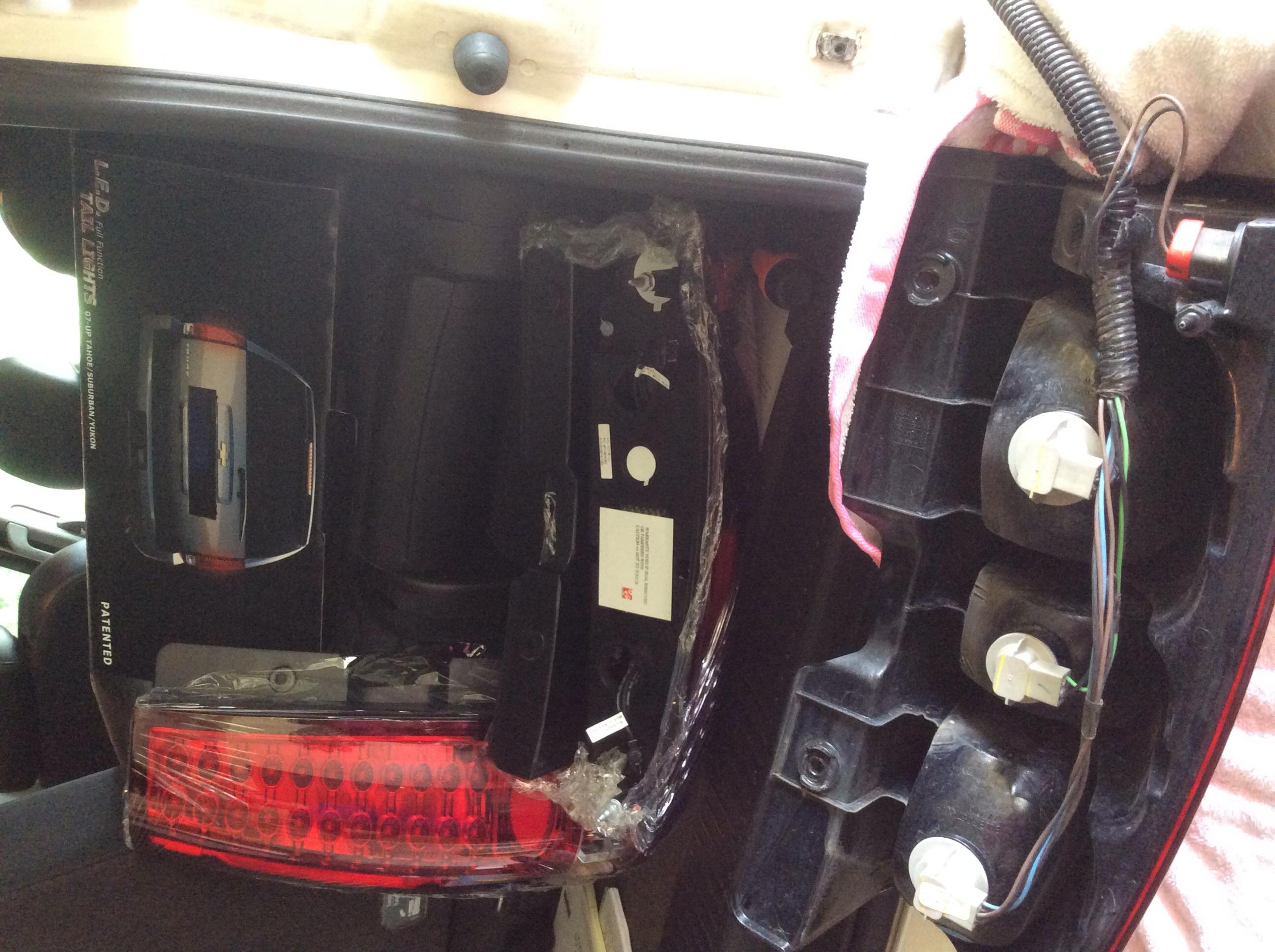

Trying to upgrade to led tails. I bought IPCW ledt 311-cr( supposed to be no splicing or re wiring) I can't just exchange them do I need a different wiring harness if so where can I find one??

Can you post a picture of both the tail lamps connectors? that would help us understand what you are looking for....

If it's like the Eagle Eyes, you simple twist each bulb socket to remove from the OEM lite and plug the corresponding plug from the LED assembly into the bulb socket.
Also recommend placing a cloth under the OEM taillite assy to protect the bumper during the removal process.

I think mine clipped in at the connector level on my 09. It took a few tries with different resistors to kill the fast flash.
