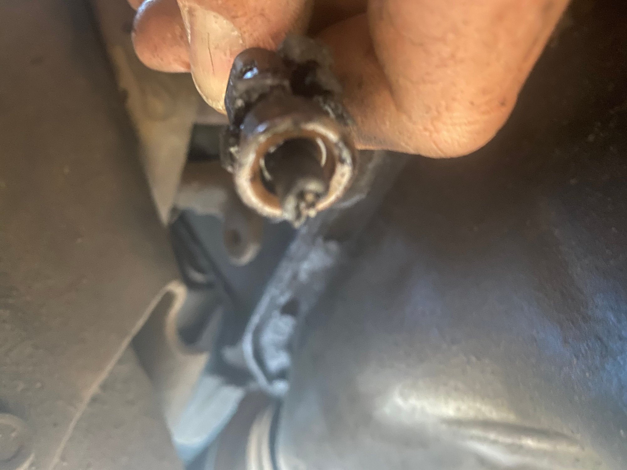

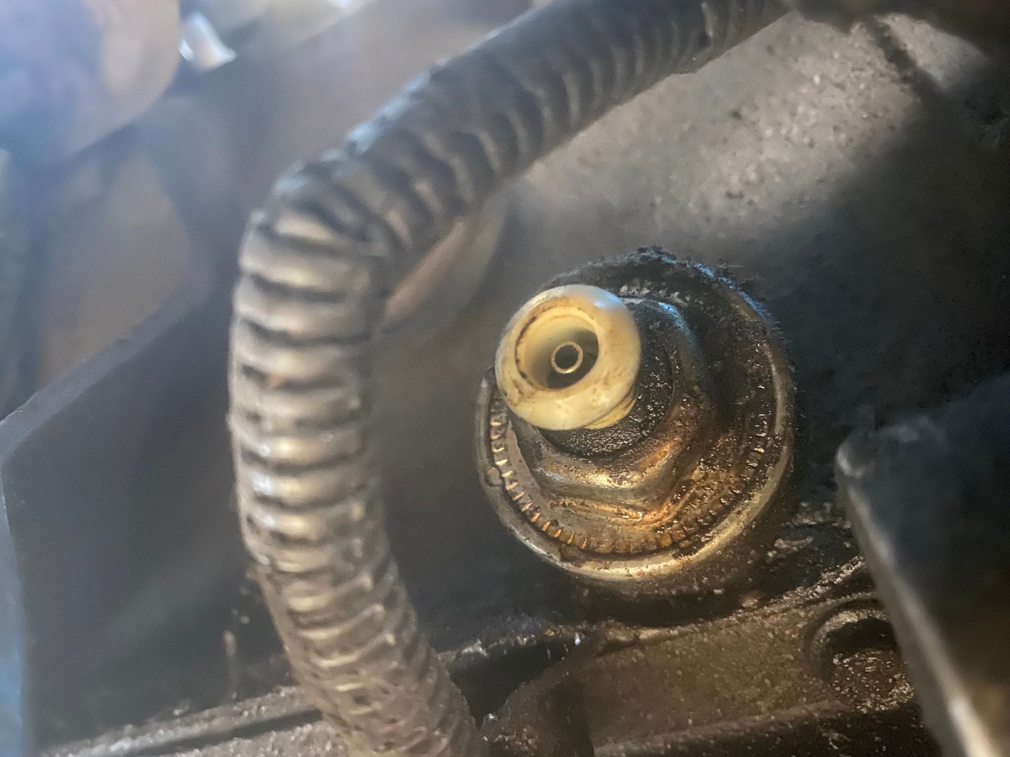

Default anyone know what sensor this is next to my oil filter? 93 c1500

Go on Rock Auto and look up oil pressure sender and knock sensor. They should have a picture of them.
Been a long time since I've had a motor of that vintage so I'm not fully sure.
