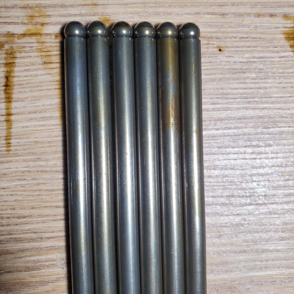

Update:
Took the valve cover off and inspected the push rods, something is definitely weird with the cylinder 5 intake push rod. It looks like it has this orange scratchy appearance on the end that is closest to the camshaft. I haven't been able to find anything about this online at all, no idea what this is. Anyone ever seen something like this?
Images push rod order (left to right): Intake 1, exhaust 1, intake 3, exhaust 3, intake 5, exhaust 5.

The head bolt that snapped off, was it near #5 cylinder? The orange appearance on the push rod, is it rust? Did you check the lifter?
The snapped head bolt is near cylinder 5, yes. The orange stuff has an oil/grimy texture, wipes off easy. Haven't checked the lifters or cam yet.
